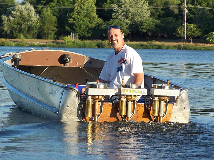

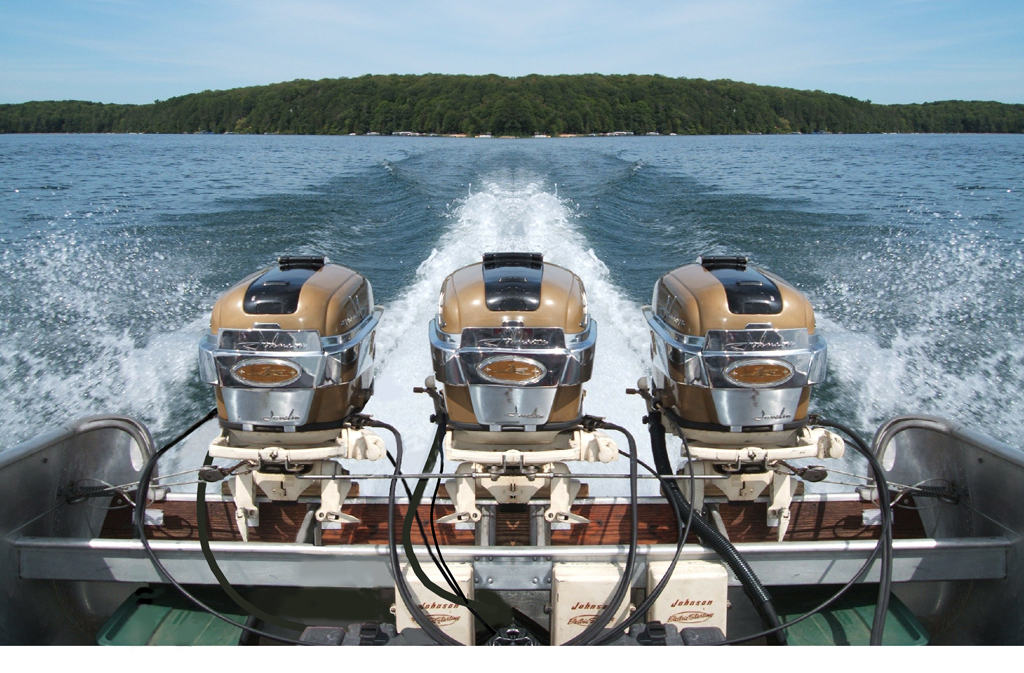

      You want triplets ‘eh?
      It’s been done! (Can’t find FR’s photo)
      #51878
      wedgie
        #51880
        wedgie
          By the way, the 3 Javelins are cleverly "shopped" by Garry Spencer. 😆
