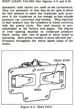

              May be April before I can test this motor. We’re leaving for a month in Florida tomorrow morning and it’s raining here today. I still don’t know whether to use one or two of the thin spacers between the upper and lower reeds. Two may allow the lower reed to open too much, as it "stops" against the upper reed. Wouldn’t that cause a too rich situation?
              #71600
                How far the reed opens has nothing to do with the fuel – air ratio. That is controlled by the carb knob. How far and how easy does affect the air charge volume. And how easy to fatigue and break.
                OK, you got me curious to do some searching. I looked at parts lists from <1950, 1951-54 (yours), and 1955-up. I also went out to the shop and tore down two carbs, one a pre-1950, and a 5D10. Conclusion: I couldn’t reach one. They both had the exact same set-up. One spacer, 0.011"
                thick, as the book seems to indicate. However, the 1955 book does show two spacers. Sorry, I don’t have a 1955 carb to open up.
                Lastly, I looked at the Gale service manual and got what might be an AHA moment. It says the reed tension is pre-set at the factory. Makes sense that it would be adjusted by an extra spacer if needed (????)
                My advice? Put it back like you found it and stop worrying about it. Worked for me for the last 50 years or so.

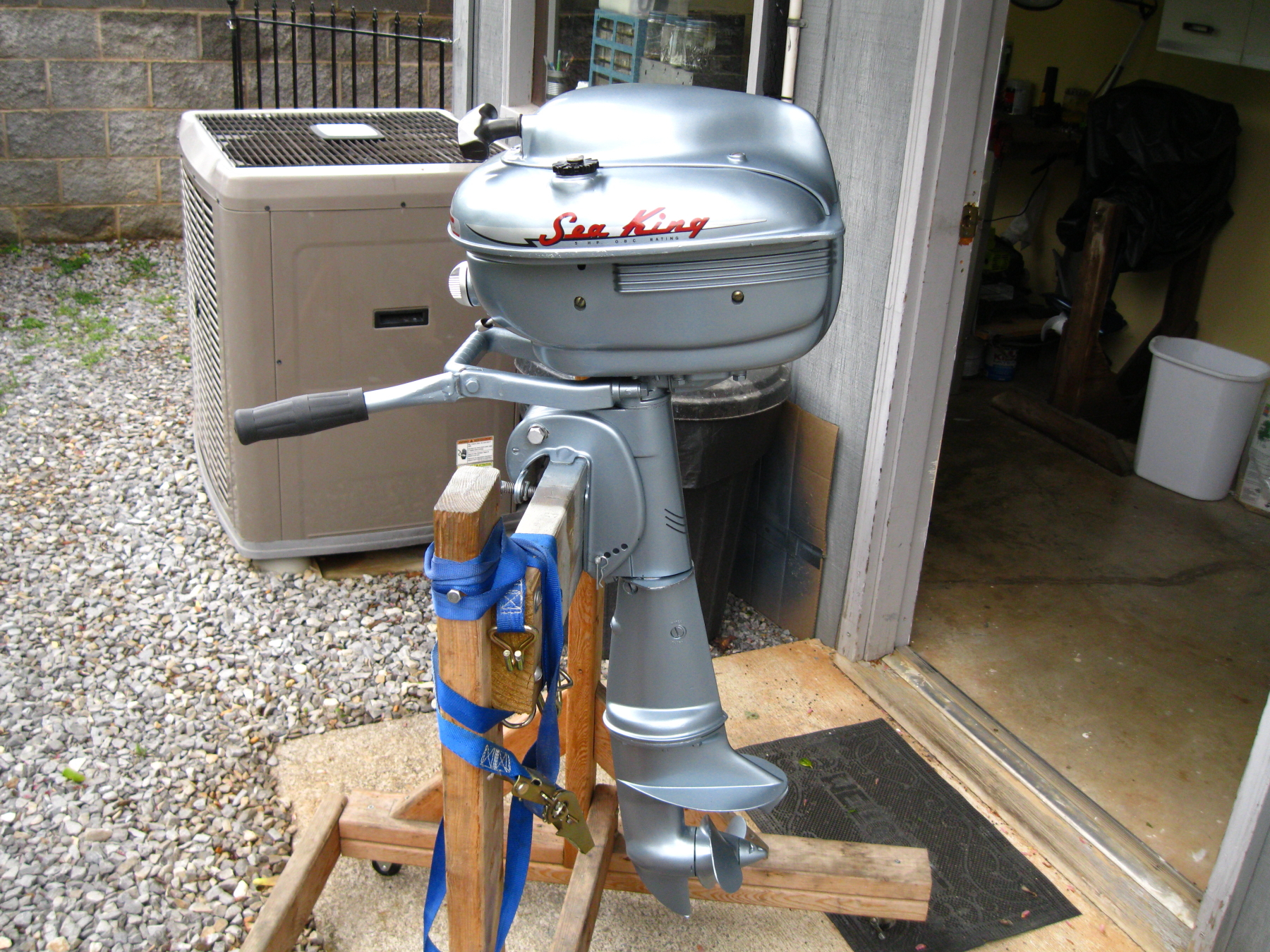

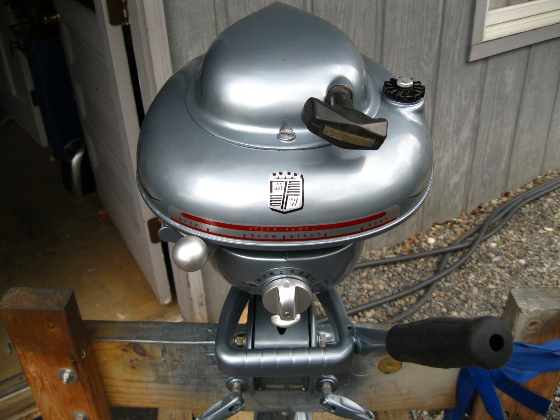

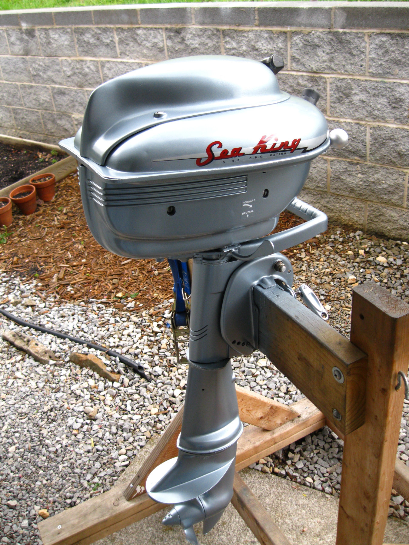

                    #74047
                    lindy46
                      Here’s some pics of the Sea King
                      #74049
                        Great job! Almost too nice to use!
                        According to my catalog of outboards,
                        I have a 1948 Sea King 5 hp, but I think
                        I’m missing the fancy looking rewind.
                        Your photo is going to make me go out
                        in the blowing snow to the garage and
                        look at mine!
