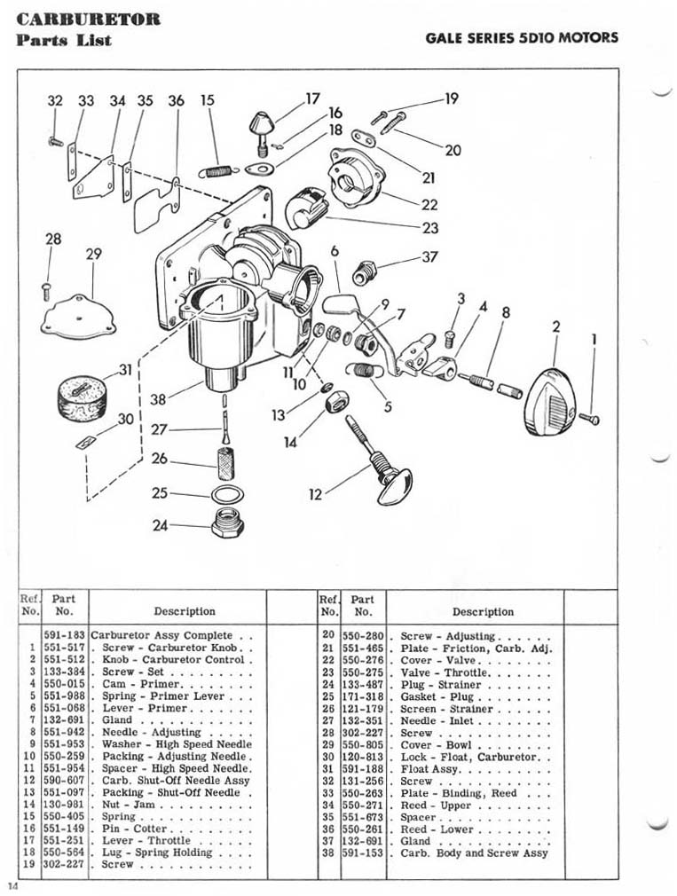

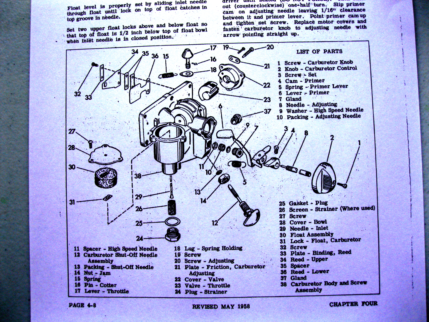

                In looking at the service manual for the carb on the 5D10, it shows 2 spacers between the upper and lower reeds. Mine had only one. I had an extra 5D10 carb so I stole the spacers and added it to my rebuilt carb. It still makes some chirping, but a little less noticeable. Interestingly, the second carb had only one spacer between the upper and lower reeds also. I should also mention that there is no separate reed plate on this motor – the reeds are actually a part of the carb.

                        Well, that’s interesting. The diagram in my manual shows 2 spacers between the reeds (#35) – so which is right? Frank – where does the drop of oil go?
