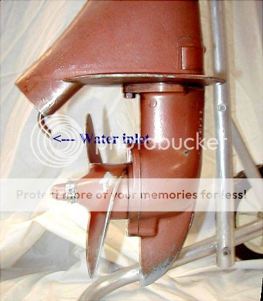

                  Are you sure it even has an impeller? Some motors have a ram tube that the prop forces water up through. Look at the underwater exhaust outlet. Does it have a pipe sticking out and curving forward? If so, no impeller.

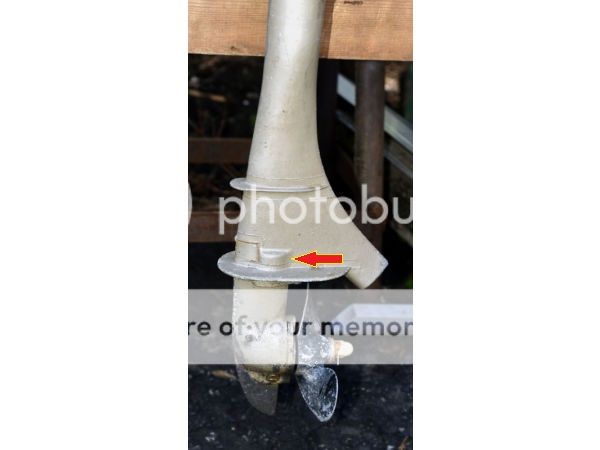

                    Your 3.6 should have this hump in the housing for the water pump.
                    The earlier 3.5 Elgin/West Bend based motors are smooth in this area and instead will have a water pickup tube behind the prop.
                    #45818
                      Good info, I did not know about that hump.
