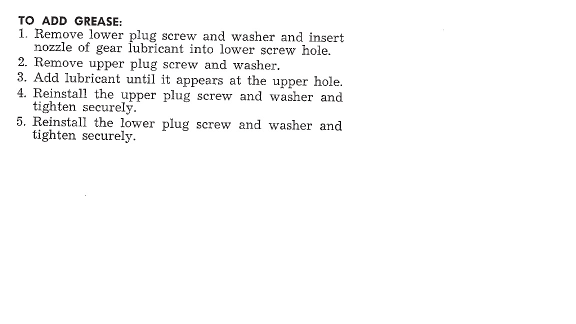

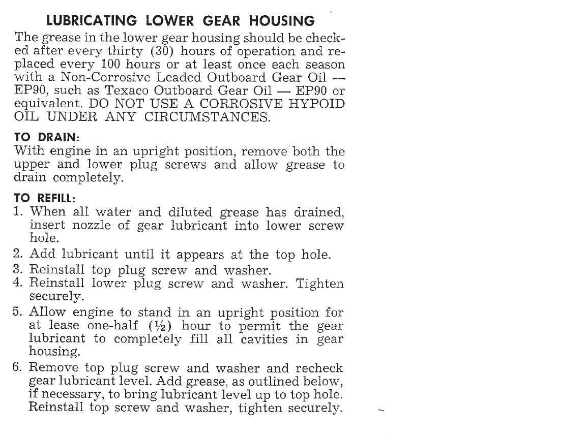

October 19, 2016 at 4:19 pm #46111I purchased a chrysler 9.6 of a guy.Runs great went to check it and the lower unit was filled with grease.is that ok.Why would they do that.
October 19, 2016 at 5:35 pm #46116Do you know what year make or model number of your Chrysler 9.6hp. I have some information from a 1966/67 Chrysler 6 and 9.2hp manual. Yes, they did put grease in under 10hp about that time period. Please verify your model and year motor so it can be clarified.
Information from a 1966/67 Chrysler 6 and 9.2hp service manual.
October 19, 2016 at 11:20 pm #46146Model is vwb27009a
October 20, 2016 at 12:01 am #46149Did they put it in the 1970s 9.6hp VWB27009A
October 20, 2016 at 1:02 am #46156Yes the 9.6hp Sea King uses oil in the gear case. Hear is a seal kit for it. http://www.marineengine.com/newparts/pa … SIE18-2638
October 20, 2016 at 2:42 am #46163Careful on terminology here – some people and companies use "gear oil" and "grease" inter-changably, as the article a few posts up appears to do, as it talks about changing grease , then using 90 w gear oil but then talks about draining grease. I think of "grease" as the thick stuff, like wheel bearing grease, that will not drain out if the drain screw is removed, which is common in non-gearshift motors.
