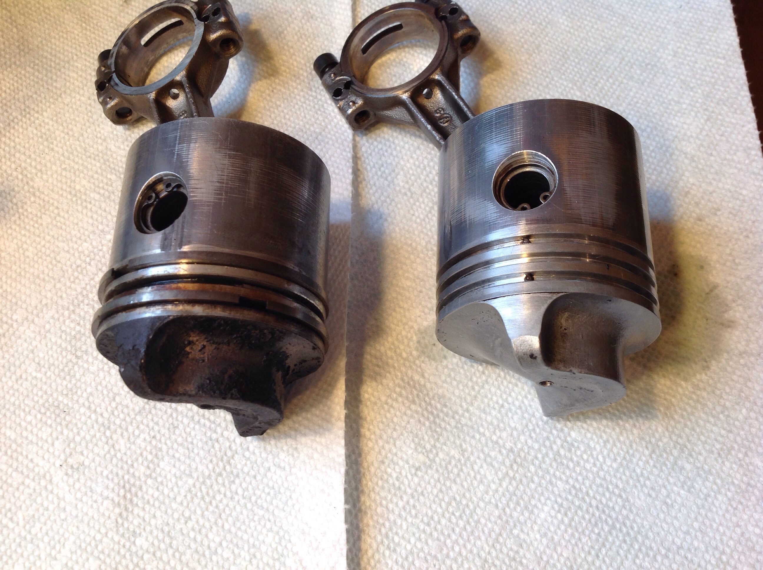

      Ok here is what I finally came up with. 3 day soak in a mixture of Berryman’s and GumOut carb cleaner. Wire brush the heavy stuff off, then then 5 minutes in a heated Ultrasonic cleaner with a 60/40 Simple Green Aviation cleaner and water.
      Very pleased with the results.

        Wow, looks great! Guess I’ll try that approach on my next project motor.
        1982 Evinrude 25hp
