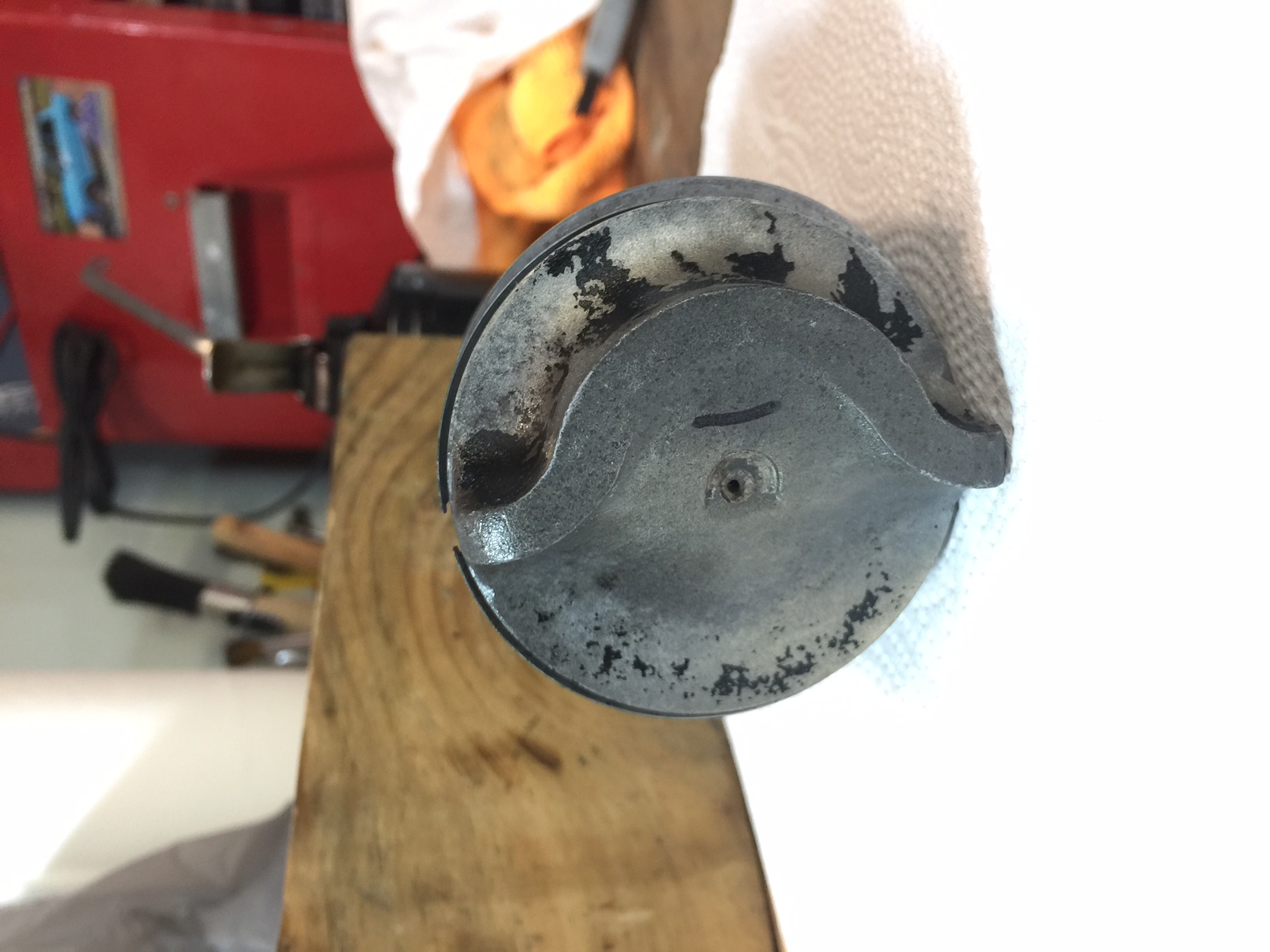

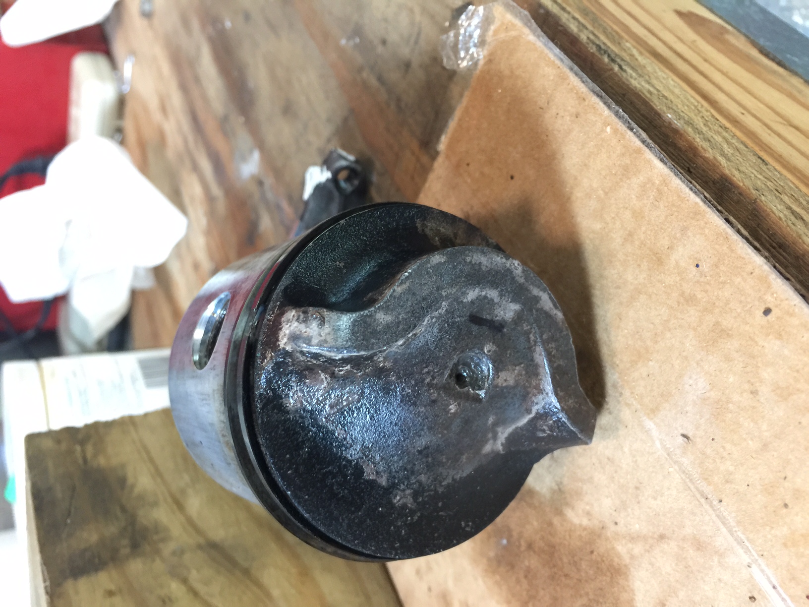

          #84005
            I’ve used SeaFoam with pretty good results. On a recent job, I soaked the piston crowns in a small pan filled with Berryman’s B-12 fuel system cleaner which worked very well. See pics. With either the Berryman’s fuel system cleaner or their carb dip product, you have to leave it soak a good while.
