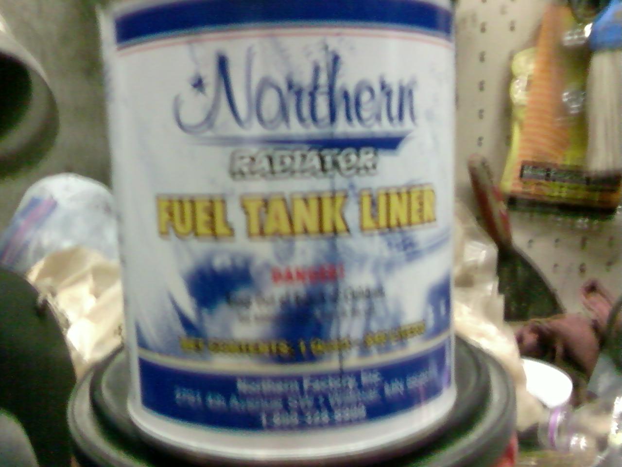

          slim60
            I may try this on my next float. Anyone else tried it? Works great on fuel tanks.
            #58294
              quote Slim60:
              Did one float using a different brand.
              Was fine for a few years then had the
              same result as
              VinTin
              (Large blister causing float to hanging up.)
