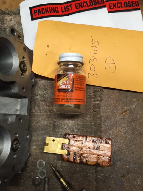

I apologize if this topic is tired.Do I even need to coat the cork float in the carb off of my ’67 OMC 80 HP V-4?
I can tell y’all, model airplane, "hot fuel proof" dope is not, in fact, immune to whatever is sold as gasoline, in central CA.
I pulled the carb apart when it wouldn’t run right, and the coating I’d used on the float 3 years ago was white, mostly flaked off, and gumming up the works.
I’ve cleaned up the float, (which is in good shape) and have looked over old postings on this board.

Here’s a pic of what didn’t work, (for me, in my opinion; don’t sue me!) I didn’t use any weird fuel or additive, and applied multiple coats giving it time to dry, in warm, dry weather.
All replies appreciated!August 27, 2016 at 12:46 pm #42754Calan,
I too have tried that model airplane dope. Its terrible!
I did about a dozen motors as well, and ALL failed, coming back to me for re work. It gums up, and clogs every passage possible. Throw that jar in the trash can like I did, its terrible.
August 27, 2016 at 12:54 pm #42755Simple. Break down and buy a new float for that V-4. The new ones are coated with a different material than the old ones were. The old ones were coated with shellac and alcohol eats shellac.

August 28, 2016 at 10:06 pm #42853Has every type of model airplane "dope" failed its users? I have a different type than is shown, and I wonder if it’s different than the one you’ve shown. I am getting close to having to coat some and would like to know for sure. I have the "Sig Supercoat" that is supposedly fuel proof. This is the one everybody on here suggested as being the best.
