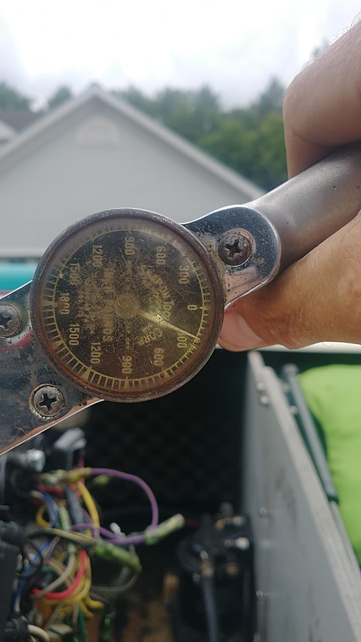

July 12, 2024 at 2:16 pm #289090ok for anyone following,
I scuffed the gasket lightly in a circular pattern, as well as the cylinder block top.. I wiped down the tops then polished them with isopropyl, then another light scuff, then a final polish.
same with the head, it got a circular scuff and then acetone/isopropyl rub.

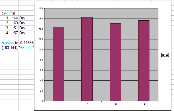

Dryed and installed, 225 Inch pounds in circular pattern.my pre-rebuild psi was:123/150+/150+/150+
my new numbers are: 144/163/151/157
I’m calculating a 11.7% range from highest pressure to lowest
((163-144)/163)=11.7%regardless. cyls were DRY. so with a little oil I bet it’s going to skate by with the kids on the water tube

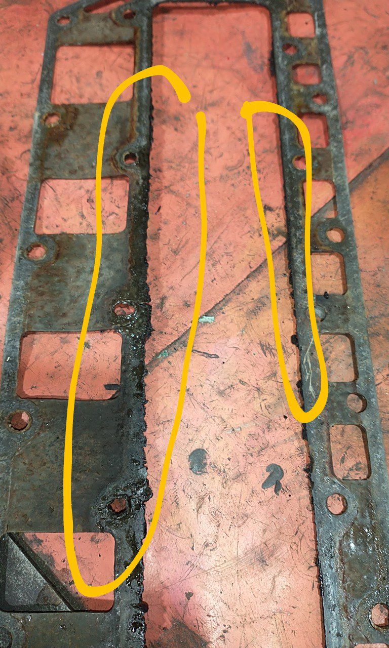

August 7, 2024 at 2:44 pm #289683Powerhead pulled. Exhaust manifold removed. (Fyi. Exhaust manifold on a sportjet is a very interesting beast)
It appears that the exhaust manifold has been compromised. As shown by the area circled in yellow.
This part is very expensive I have it on order now.
Question now is would this create water signs in JUST cylinder number 2 and a cyl miss at high rpm?
Could water be sucked out of the water jacket in the exhaust area, then get pulled into the cylinders? (water pushing backwards into running engine???).
I understand that a two-cycle engine doesn’t completely clear the cylinder of combusted fumes but I didn’t think they would find their way back in.. much less find their way back in mixed with water?
