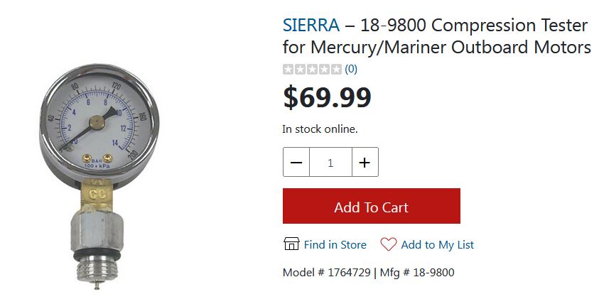

            CHUCK
              Compression testers for small engines should ideally have the pressure-release (schrader) valve close to the cylinder. Testers with the valve at the gauge end of a hose will give lower readings on small displacement engines.

                  if you are worried try some decarb stuff like Merc power tune or similar Evinrude engine cleaner and measure comp. again after a while.
                  use the short meter pictured above not the long hose one and re-measure comp. you may gain a few PSI and be close enough to perfection 🙂 .
