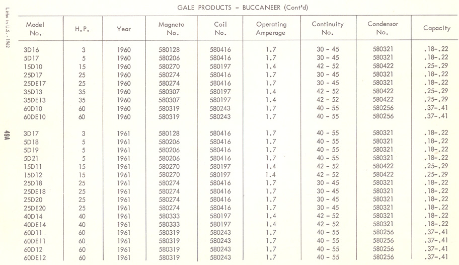

I used to think 580422 condenser was used with the thick lamination coils 580197 and 580321 condenser with the thin coils 580416But that ain’t necessarily so. See chart, 580422 with thick 580197 coil on 15hp AND 580321 with thick 580197 coil 40hp. There’s gotta be another variable somewhere. Magnet size???

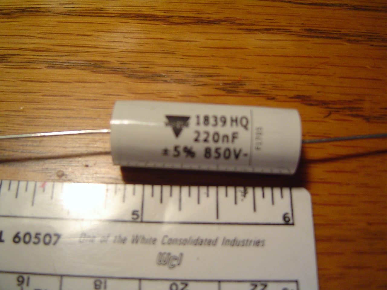

September 5, 2018 at 7:28 pm #82323Here you go , Joe’s free opinion on condensers ( you know about what is said about free advice) …. For the vast majority of the motors that we commonly deal with a capacitor of .22 uf will do the job. The idea of "matching" to the coil and mag is no doubt a great thing in theory. However in practical terms, even the modern caps are rated plus/ minus 10% of labeled value. I would guess that the old paper/ wax caps of days gone by were lucky to be +/- 20%. If you look at most charts the range of recommended capacitance is 5 uf. so add to that a +/- 20% and you begin to get a better picture of what will work in a particular motor. Thanks to the help of one of our members that is tech savey we have found a modern foil cap that has yet failed to bring back to life any motor that we have tried it on. Vishay 1839HQ .22uf +/- 5% rated at 850 volt. And best of all they are small enough to retrofit into most of the old cap "cans" for those that like to maintain the original appearance.

I remember researching that with you,September 5, 2018 at 10:33 pm #82328OK! If I’ve found the right one they are $3.48 or $28 for ten at Digi-Key. https://www.digikey.com/products/en?mpa … 084HQ&v=56
