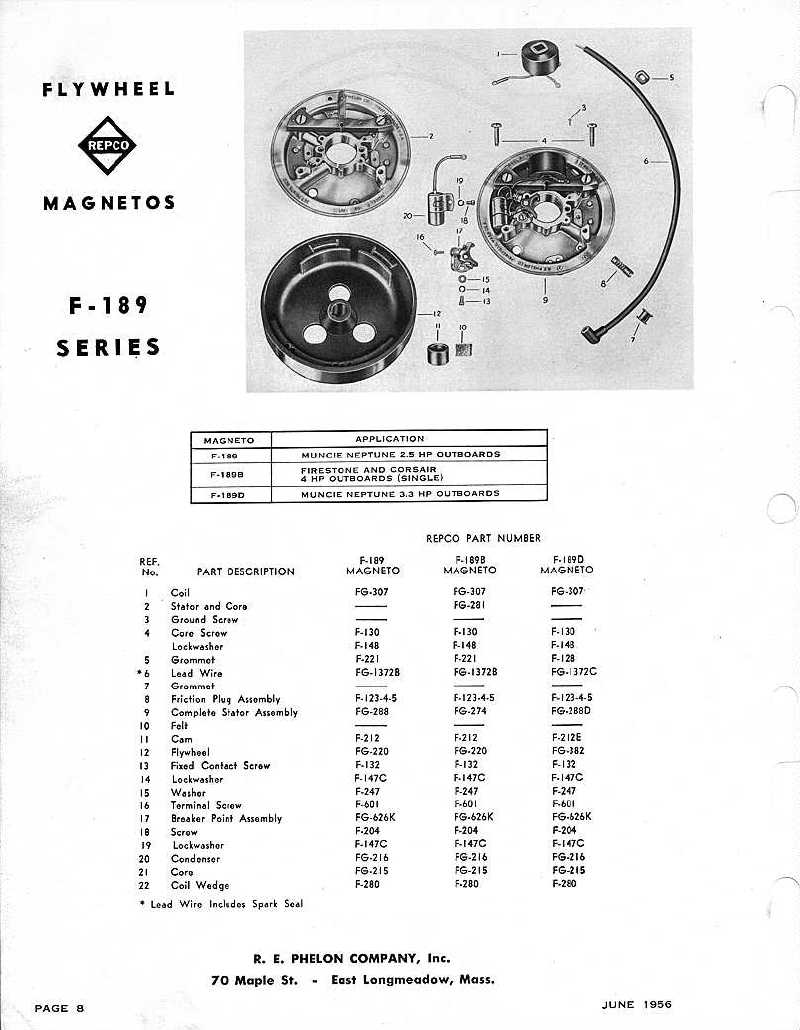

      The round one was used on a whole mess of small engines. This is but a sample

          Yes, assuming it is OEM
          #75804
          dan-in-tn
            Guess I better keep them if there is any chance one would fit a Neptune/Muncie? I have some of those & I hear coils can be tough to come by. I had already planned to convert to OMC coils for my Master Twin.
