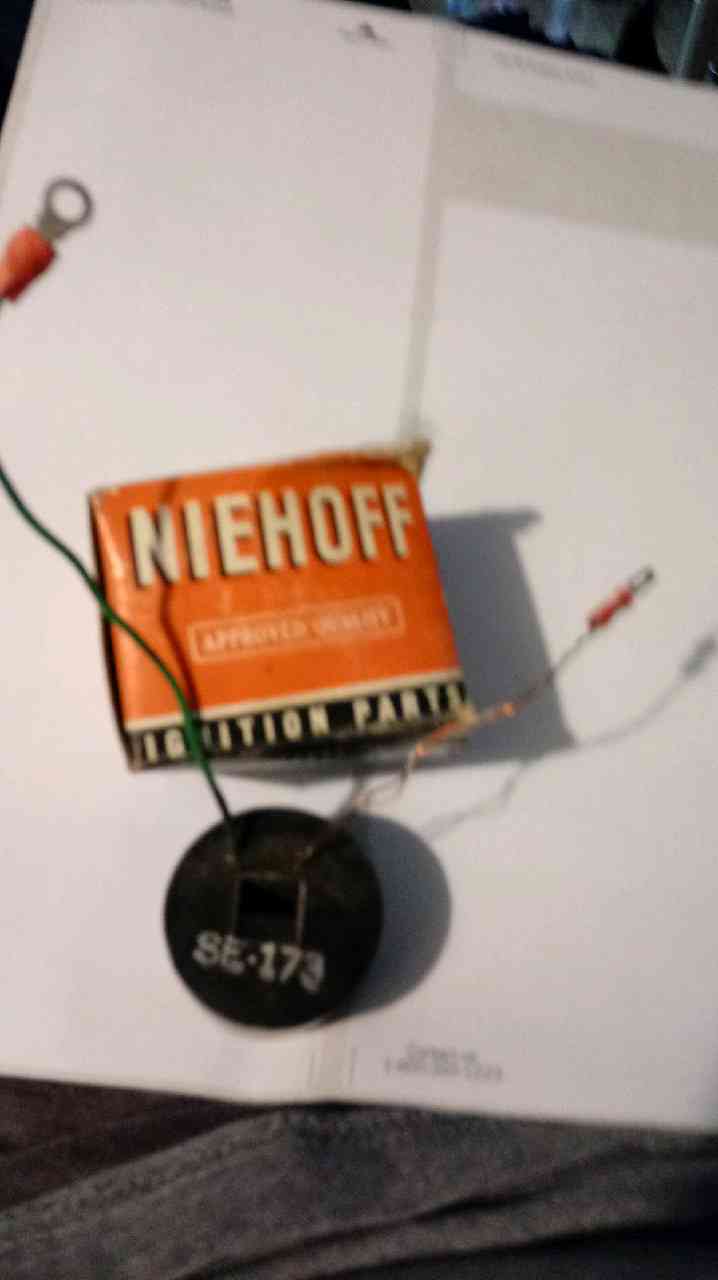

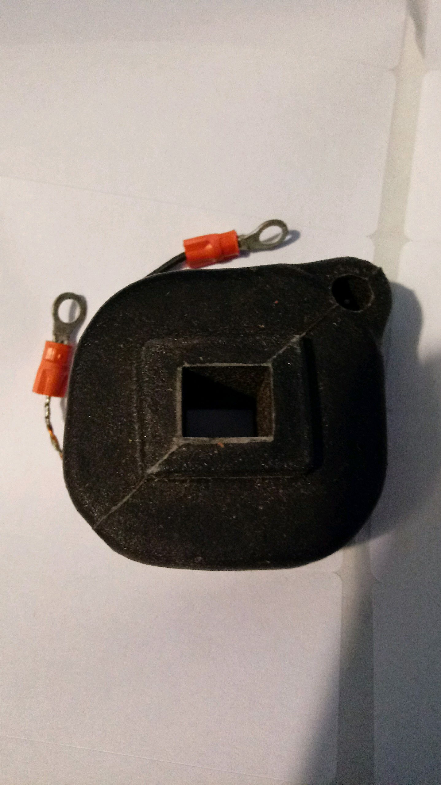

Came across these in a LOT of parts I bought. Any idea what they fit. Niehoff brand both of them. Boxes are in poor shape & the only thing missing is the top flap with information on them.
The first coil (second pic) is showing a small little ring for the secondary attachment point? I assume these are not OMC coils?
Someone may need them for their project. I do have some Neptune/Muncies, but other than that not much use for them.Dan in TN
May 10, 2018 at 10:13 pm #75718The last one looks like a Phelon replacement
classicomctools@gmail.comMay 10, 2018 at 10:15 pm #75719Unless someone recognizes the coil from the pix , providing the size of the armature holes will help determine an application.
Joe B
May 10, 2018 at 10:40 pm #75723quote Richard A. White:The last one looks like a Phelon replacementJust what I was thinking. My Scott-Atwaters originally had similar coils like that but then my ’68 Merc 60 has something like them to along with a ’57 Silent Six.

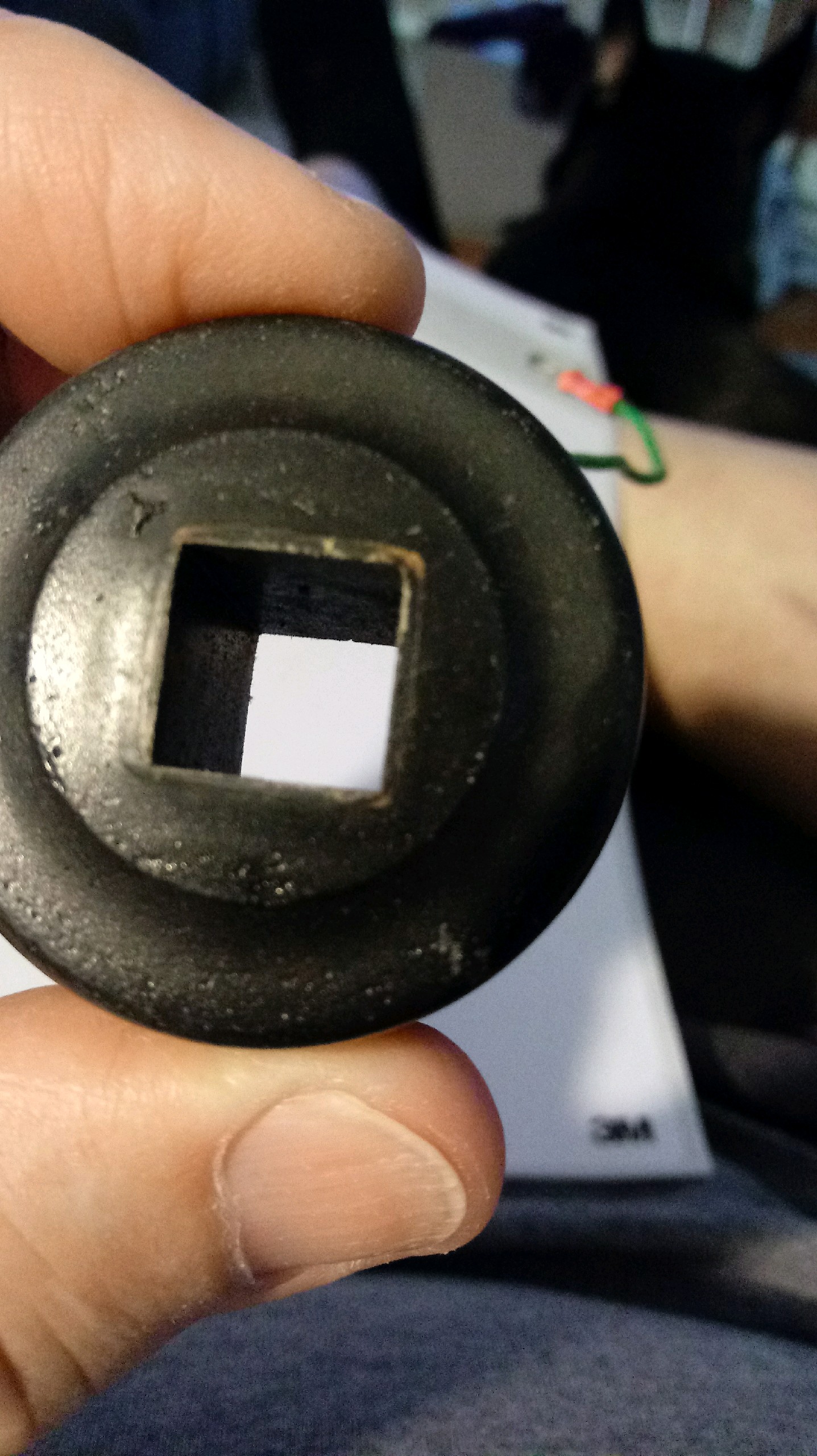

May 10, 2018 at 10:51 pm #75725Sorry guys, had my measuring stick right beside me. The first coil (top pic) is 7/16" square. The second one is 7/16" X 1/2". Hope that helps! Thought maybe the numbers would do the trick if anyone has Niehoff cross over stuff?
Dan in TN
May 10, 2018 at 11:13 pm #75728They are both Repco (Phelon) coils. Used on various motors so I can’t be more specific.

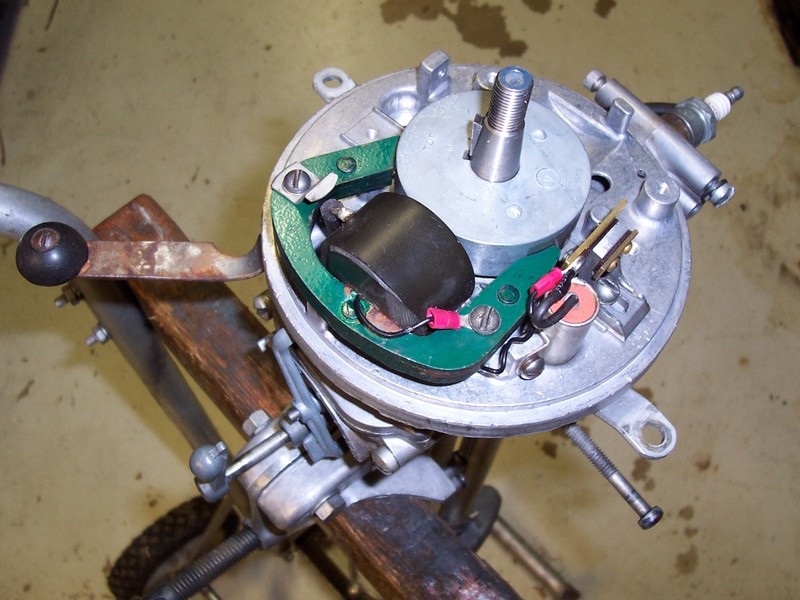

May 10, 2018 at 11:26 pm #75736May 10, 2018 at 11:57 pm #75738Interesting Tubs! That’s a motor I have. Looking on eBay I notice two variations (wire sizes) it seems?

May 11, 2018 at 1:08 am #75749Isn’t the odd shaped one Mercury?
I don’t think that one on the Ranger was original to that motor. Looks like somebody put it on the OMC lamination (good job). But I do think it was used on Clinton outboards. And possibly some Scott-McCullochs. EDIT: On second look, I think that is an OEM OMC coil on the Ranger—not a repco.
