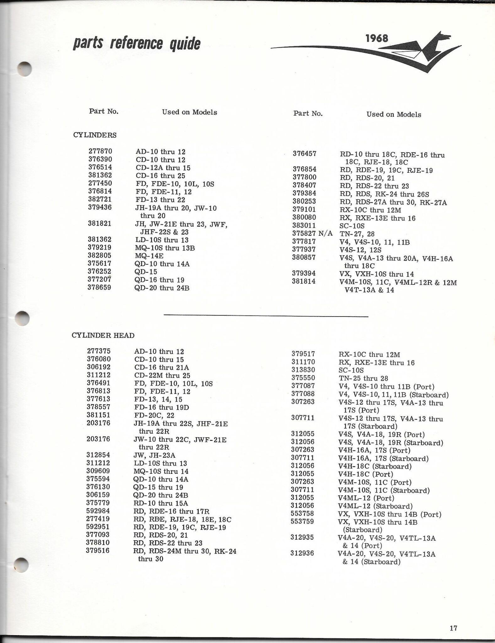

        MIKE SIMS
          My ’68 Parts Reference Guide shows 592984 applies to your motor.
          common
          common2
          #248214
          MIKE SIMS
            And my ’72 Master Parts Price book confirms the supersession 592984 replacing 376336
