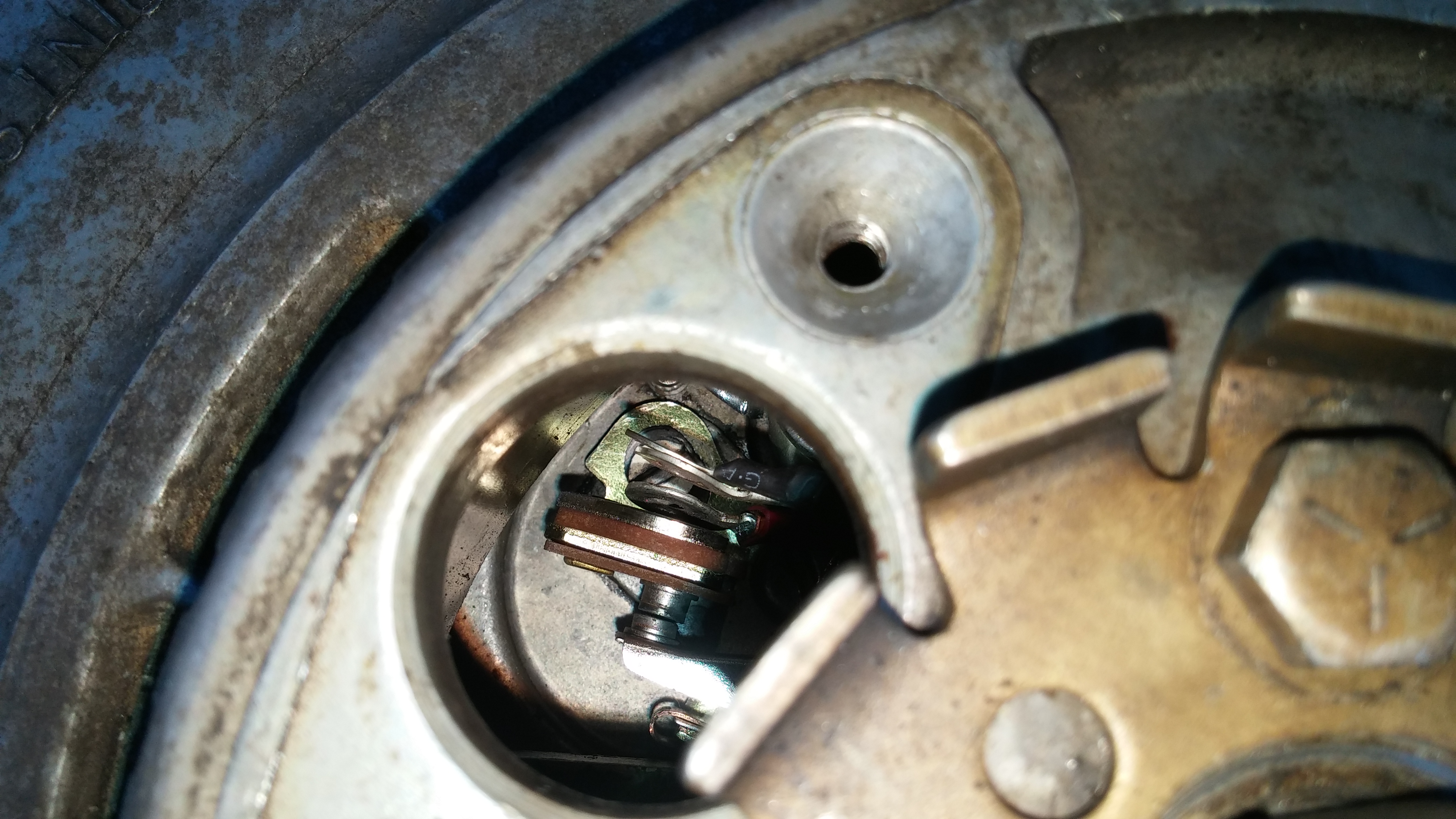

        Well look what I found under the hood!!!
        Turns out the point connection bolt came loose inside the fly wheel.
        Cant believe this thing would start and run so well..
        Gotta pull the flywheel and replace that bolt.
        Explains the shocking I guess!! 😐
        If it’s not one thing, it’s another..

          Well, at least everything didn’t get torn up under there….Check all the other fasteners while you are in there, and make sure you have all the leads routed correctly. The coil primary leads must be routed correctly, or they will rub on the point cam. The coil and condenser leads must be fastened to the points correctly, facing off to the side, or the flywheel will rub on them….

            Everything up top is new.. Looks like I under tightened last spring after the tune up.
            Really hope this is the last fix.. Gotta boat this weekend
