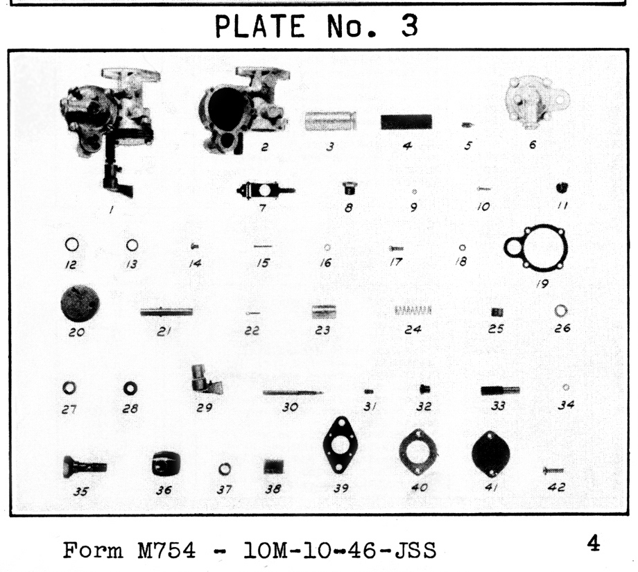

            That cotter pin keeps the center bearing alignment pin from coming out. It has internal threads (Quarter twenty ?) to remove it in order to pull the crankshaft. It keeps the rotary valve centered while you tighten the screws that hold it in place. This is all I currently have . . . 😎
            #84934
            lyks2tinkr
              Thanks Gary for the parts breakdown. I’m really enjoying that picture.
