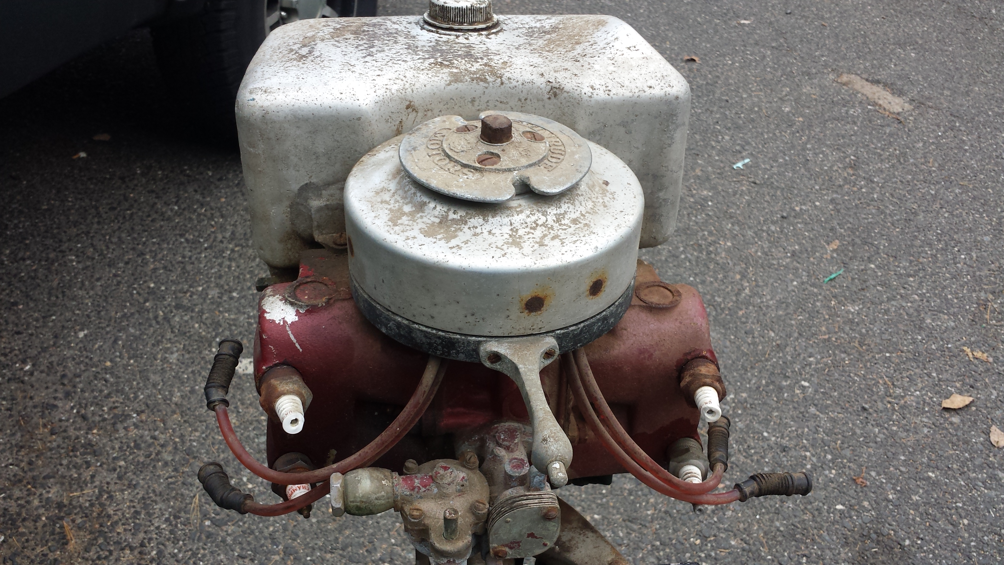

      I picked up a 37 Elto Handifour model 4219 on my way to the Madbury NH meet saturday. It was an Ebay find that went dirt cheap, probably because it’s stuck but I’ll take a chance because it’s a rare motor and I like the open spark plug look.
      I soaked it down with Gibbs and tinkered with it a bit Sunday.

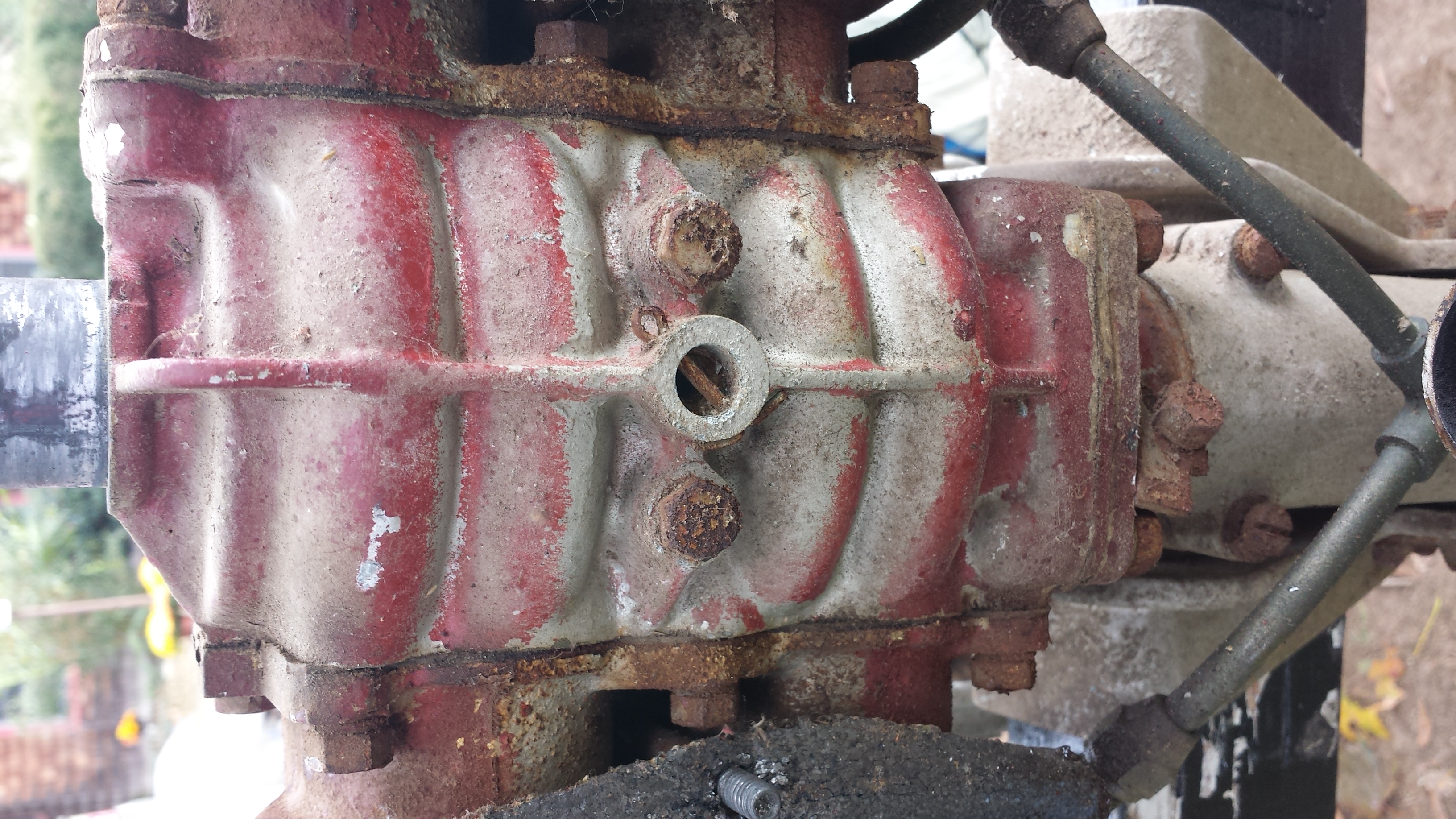

      This is the 1st 4 cyl of this type I’ve owned. When I took the muffler off I saw a strange port with a cotter pin through it on the back of the crankcase and was wondering what it’s for.
      #84802
      Tom
        I believe that’s the retaining pin for the center bearing.
        T

            #84805
            Tom
              BTW, Once you get that cotter pin out, you should be able to thread a bolt into the retaining pin to pull it out. IIRC, it’s 1/4" thread, but I don’t remember if it’s fine or coarse.
              T
