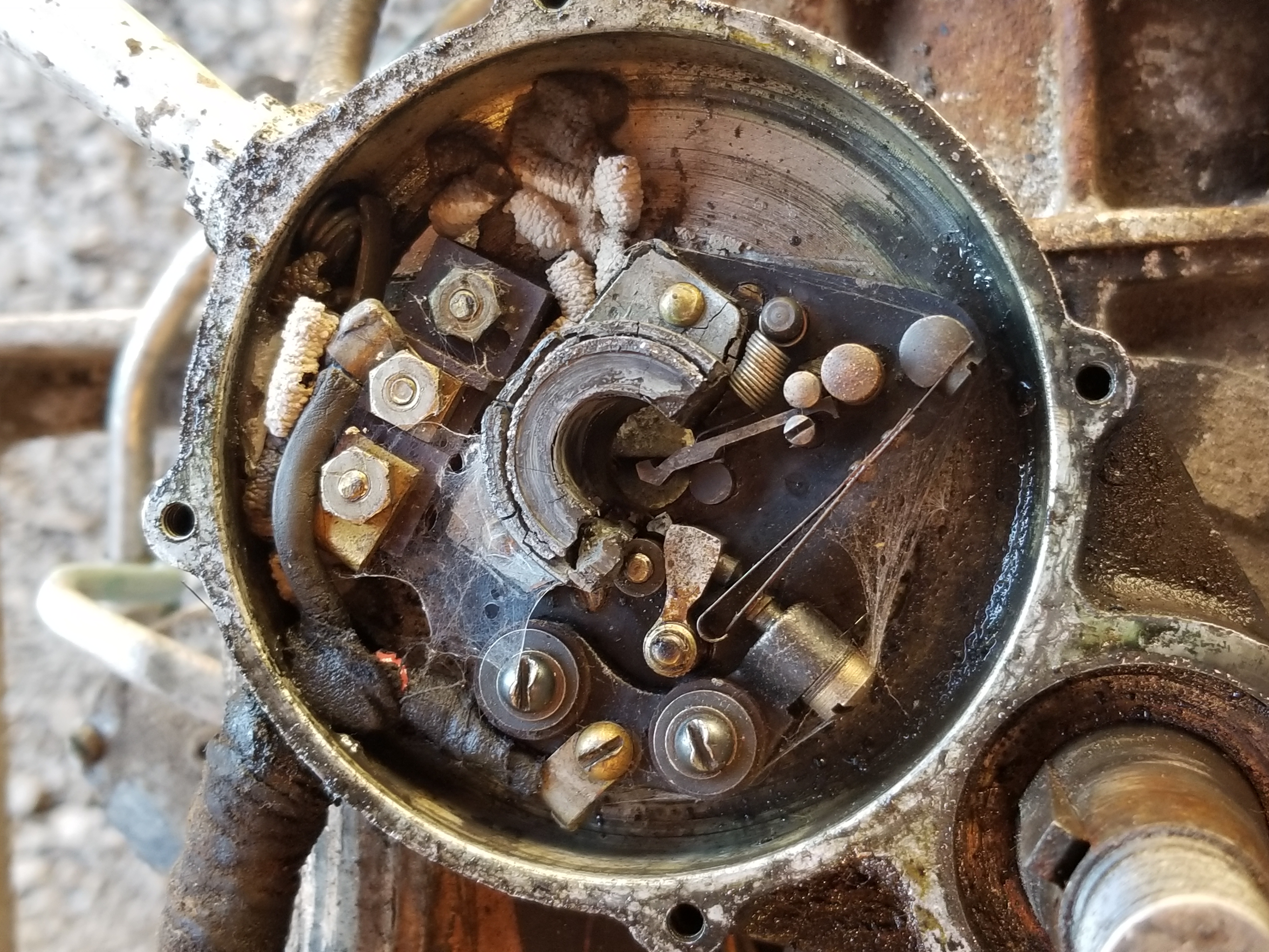

April 24, 2018 at 2:29 pm #74652So yesterday I was trying to dig out my shop that had gotten buried in a flurry of motor purchases and I worked my way back to the 310 with the intent of removing the plugs, spraying the cylinders with PBBlaster and hanging it on the rack for the time being. Long story short, this motor that had sat out in the weather for years came unstuck, I got the flywheel off, disconnected the timer strap, and the darn thing rolls over with strong compression and bounce. Amazing.
Found about what I was suspecting when I took the top off the timer case:

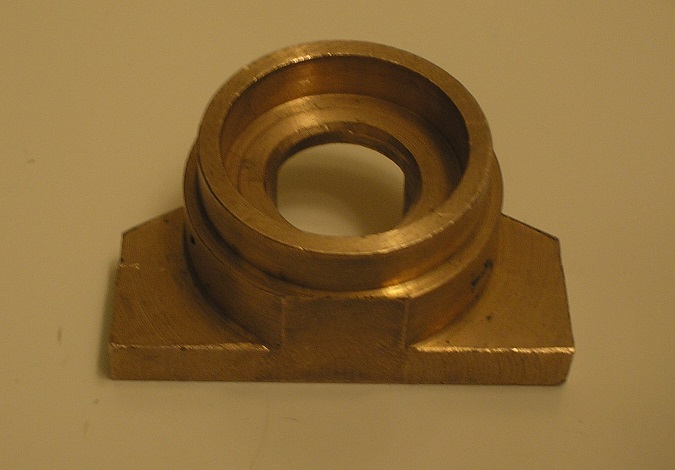

The good news? I have all the little bits for the Rube Goldberg contraption. Bad news – gotta get a replacement trigger housing (or whatever it’s called. Seems to me somebody had them in the past – Art DeKalb? Doug Penn?
Also, the timer cover is pretty shaky – same questions – are they out there as repo’s?
Oh yeah – same thing for the float bowl cover of the carb.

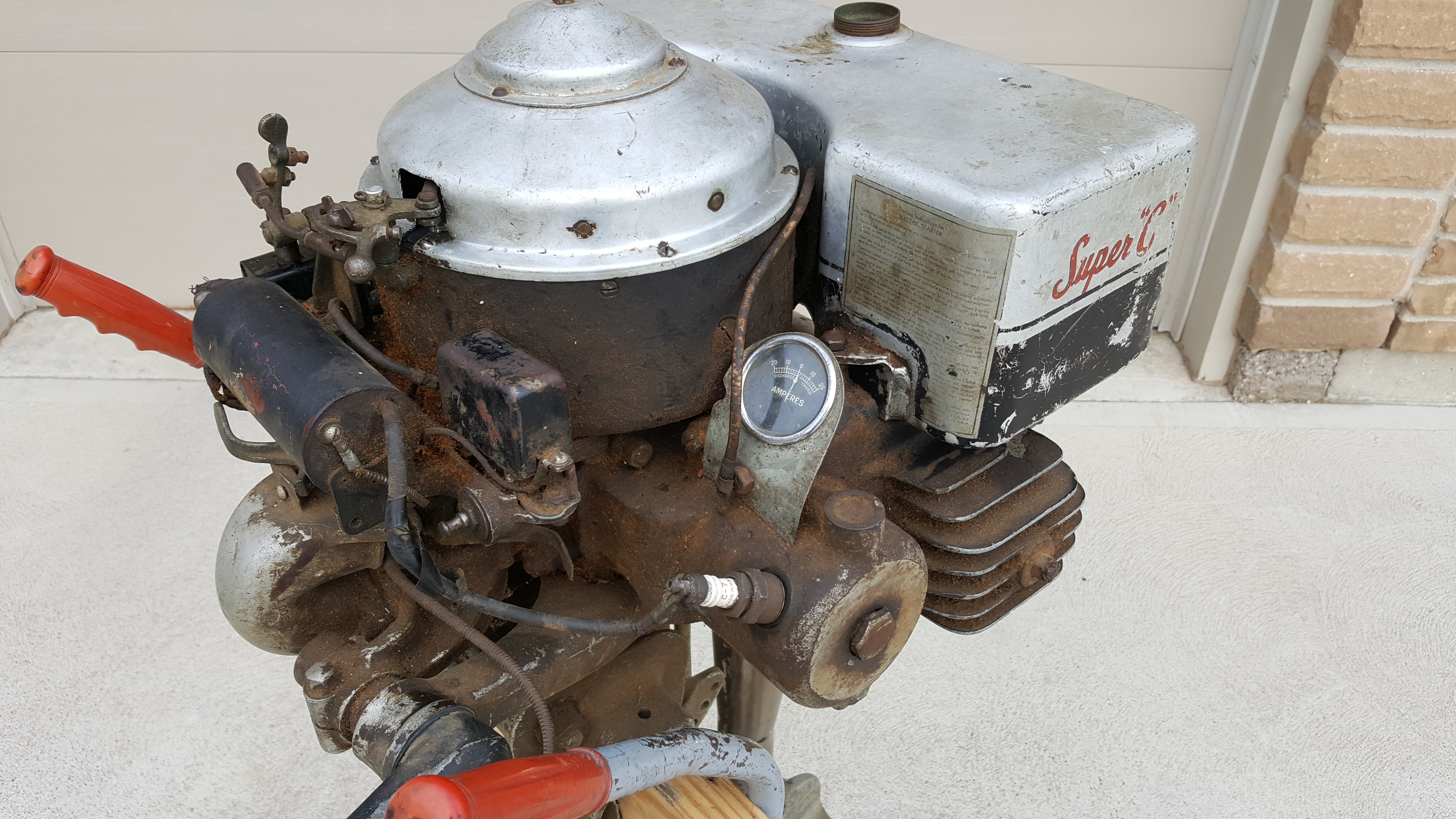

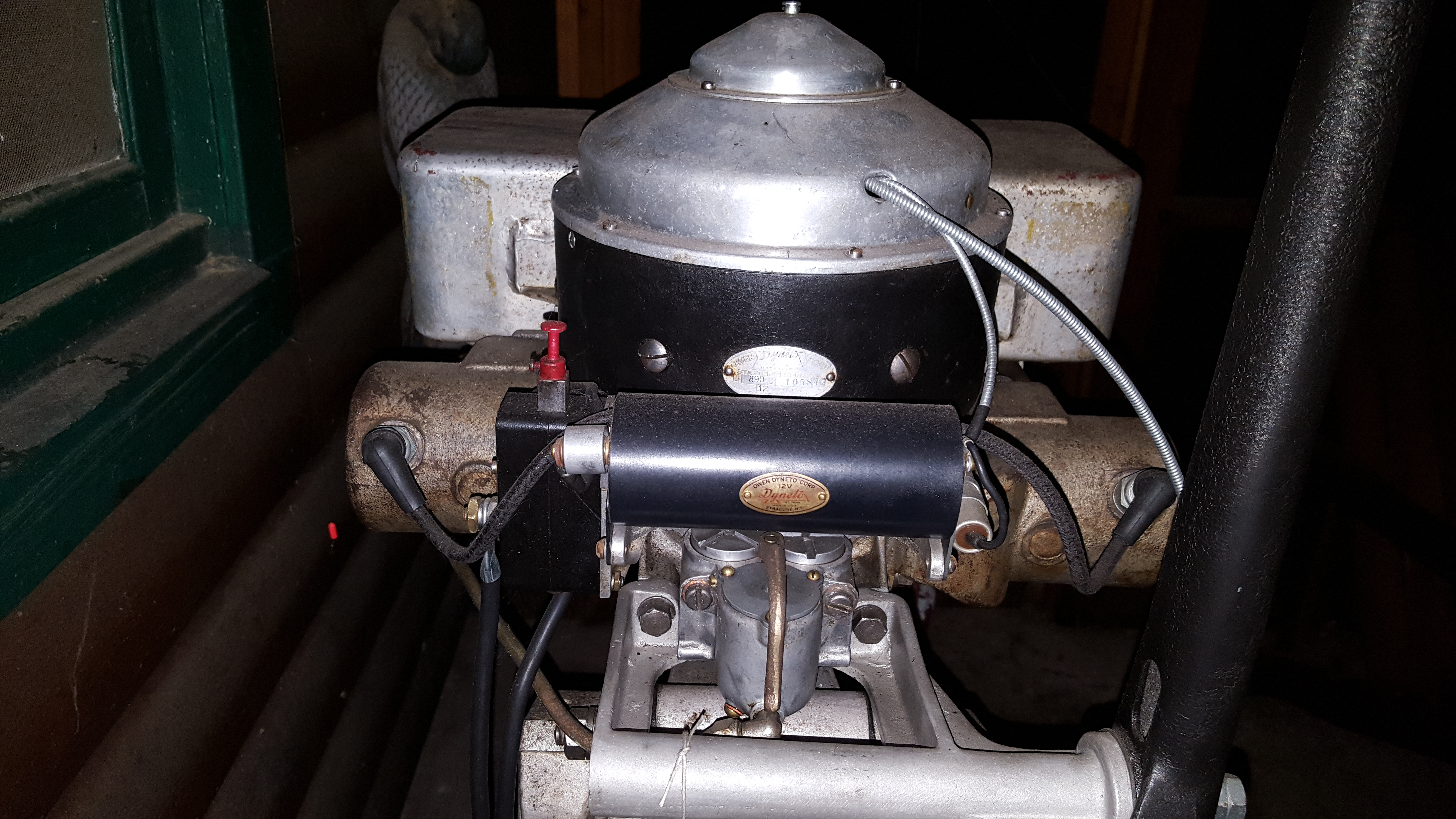

April 25, 2018 at 12:05 pm #74725I have #3100623P and it has the ignition system used on the Super C s. not the Atwater ign. Maybe from the factory but maybe not??
April 25, 2018 at 3:20 pm #74739Most call it the timer bushing.
Art DeKalb, Doug Penn, may have them.
John Gruman (Ships Store) use to make
them. The float bowl cover from the
style of carburetor they put on these
fit. I’ll bet Frank Rob can hook you up
with one. If not he can tell you what
to look for.

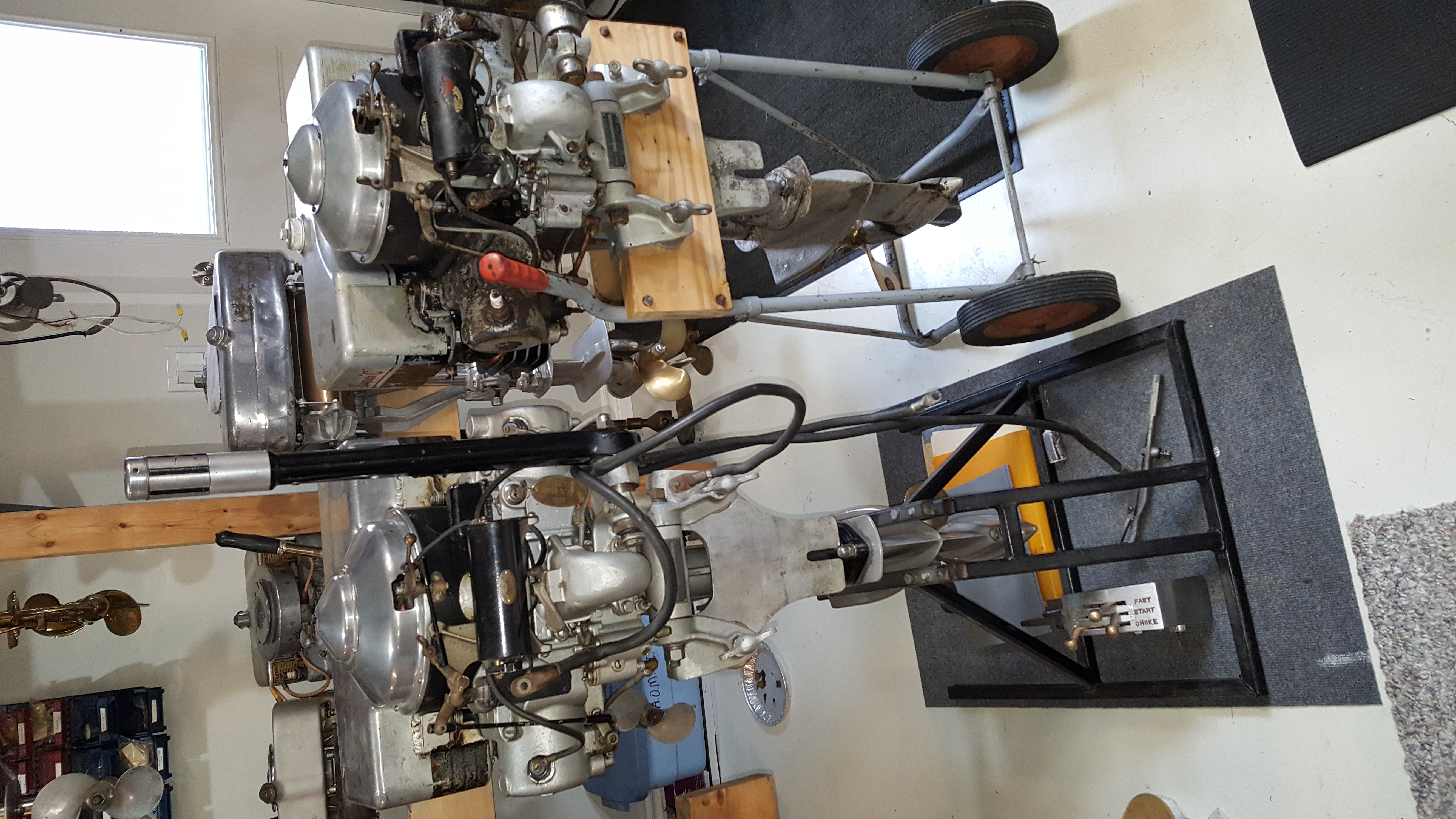

May 8, 2018 at 2:04 am #75533May 8, 2018 at 2:05 pm #75552Super cool! When’s the last time anybody saw one of those? Much less two of them, together!
May 8, 2018 at 10:59 pm #75588I’m sure it’s not something often seen, thats why I put pictures up. Not everybody is as lucky (or mentally deficient) as I am
