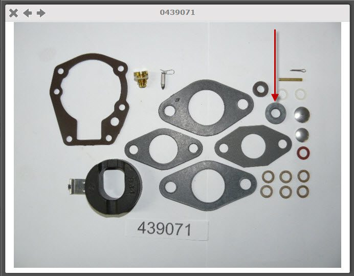

                The kit contains some items ment for different carbs . Among those items are Carburetor to manifold gasket (different size gaskets) and Core plug (different sizes).  But there’s a thick rubber ring that I cannot find any use for. It’s not the 344037 – Gasket which sits on the Nozzle. See attached image where red arrow points at the gasket. Does this gasket have to be attached to the carb I have on my Evinrude 18HP Fastwin 1960 mod 15032?carb_gasket
                #281005
                seakaye12
                  I’ve never been able to figure out what engine(s) that thick o-ring is used for….but it’s not the 18HP Fastwin.

                    if you are talking fat  donut  it goes at the bottom of several  carb  model  high speed post
                    #281025
                    Steve D

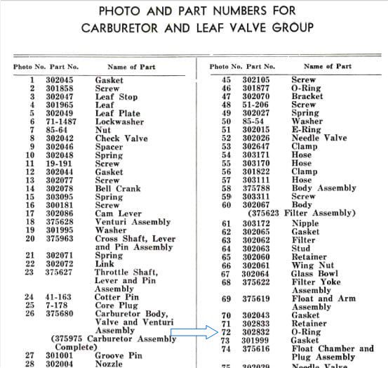

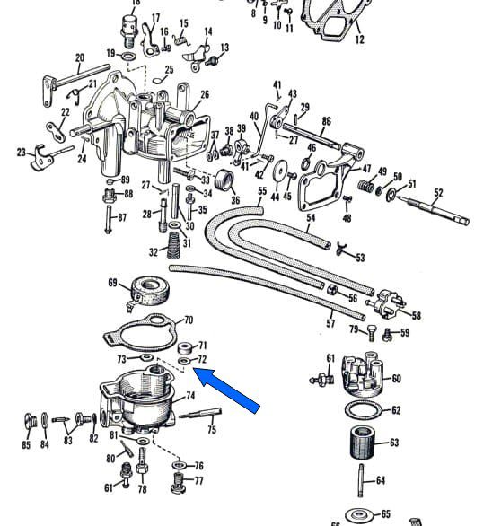

                      “But there’s a thick rubber ring that I cannot find any use for. It’s not the 344037 – Gasket which sits on the Nozzle. See attached image where red arrow points at the gasket. Does this gasket have to be attached to the carb I have on my Evinrude 18HP Fastwin 1960 mod 15032?”
                      You don’t have to worry about that one. It’s for some earlier 10 horse models and maybe others. But not for your 18.
                      1953-Johnson-10-HP-carb
                      1953-Johnson-10-HP-carb-part-72
                      1953-Johnson-10-HP-carb-part-302832
