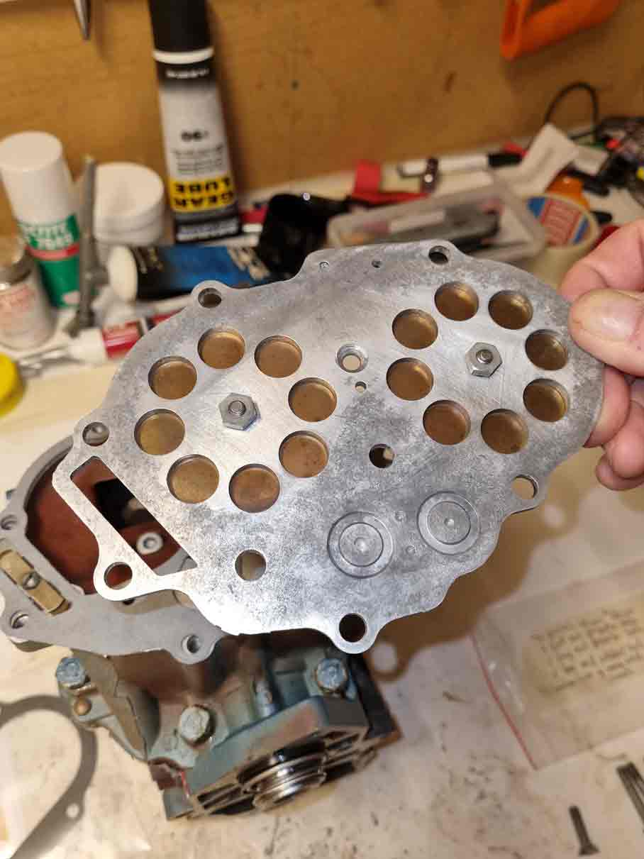

August 6, 2023 at 5:14 pm #278884I thought I had re-responded to this post but perhaps not. You mention that the engine sounds like it is running on just one cylinder and the power is low, along with fuel dripping/leaking from the carb.
Did you mess with the reed valves at all? Change, rotate/flip them during the rebuild? Perhaps one of the reed valves is broken/stuck open which would explain why it is running on one cylinder and pushing fuel out of the carb.
August 7, 2023 at 5:21 pm #278929I was lucky to purchase an OEM carb kit from a dealer here in Norway. I will try to switch float and needle soon. I might open to inspect the reed valves too. Thanks for all advices.

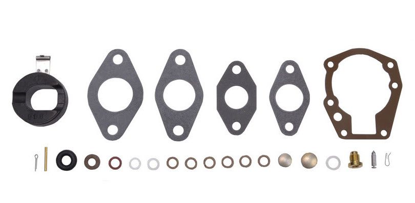

August 8, 2023 at 6:17 am #278942Well, the carb kit I bought now has wrong part number, so I have to go to the dealer and re-order the right one. Fleetwin. I did not mess with the reed valves. I performed a total rebuild of the 18 Horsepower from 1960, but I did not remove the reed valves from the plate where they are attached. They looked fine, so I just put on new gaskets on the plate and re-assembled the reed plate and manifold. See the image showing my reed plate with reeds mounted. They were never removed from the plate.
The kit I bought from a seller on ebay in China had part number 439071, which is the same number as the original OMC kit with float. But of course it is not an OMC product, so it might be bad quality.
