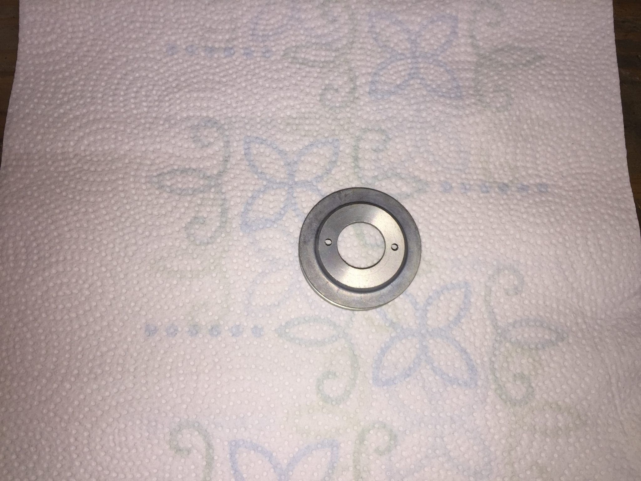

        The seal carrier may have 2 small holes on the back side like this one – if so, insert a small punch thru those holes to knock the old seal out. Then drive the new seal in with a socket of appropriate size.
        New-Rear-Seal-Housing
