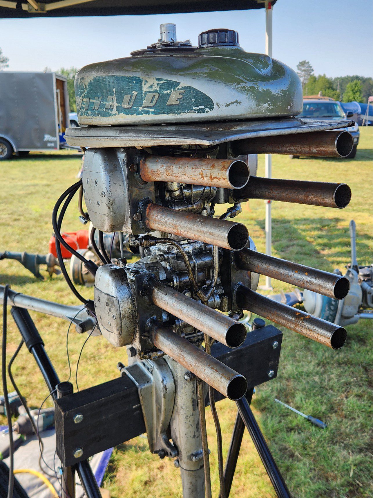

                    #301966
                      That thing got your attention at Tomahawk when it was started up.
                      It was kind of hard to tell if it was hitting on all eight cylinders though, lol.
                      #301967
                      Aidan Smith
                        US Junior Member
                        I’m not exactly sure how it works… but I LOVE it.
                        I also can’t even begin to imagine how loud it is.
                        Theres a few others laying around in that photo, someone likes the 4-cylinders!

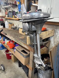

                        Here are some photos of what I am working with.
                        I need a parts list that has the synchro under the mag plate for the throttle advance, which is model #4404.
