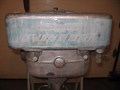

                  #39136
                  kees
                    International Member
                    Is the post war color " green / blue " decal more common ?
                    ( I couldn’t find a better picture, sorry . )
