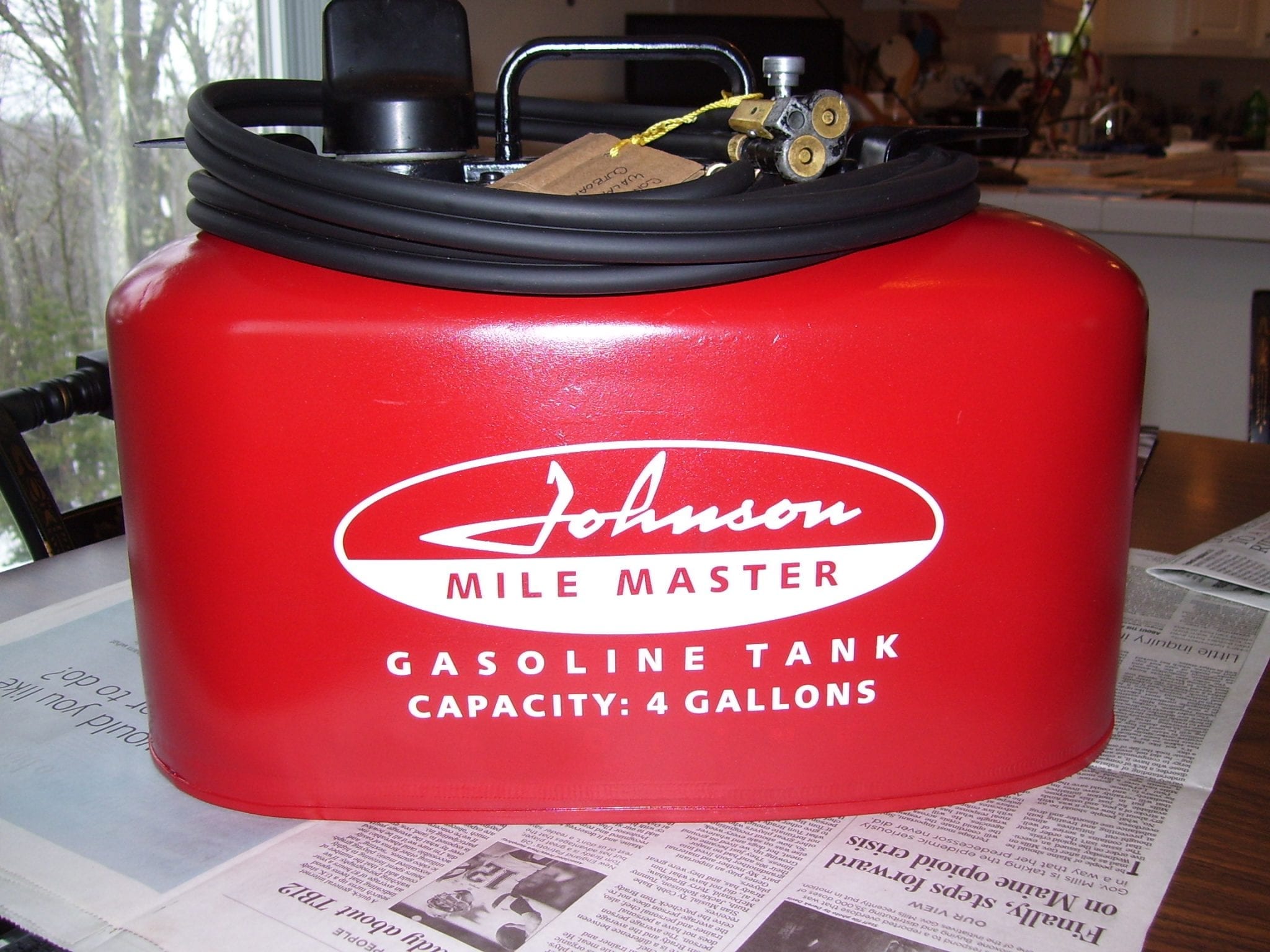

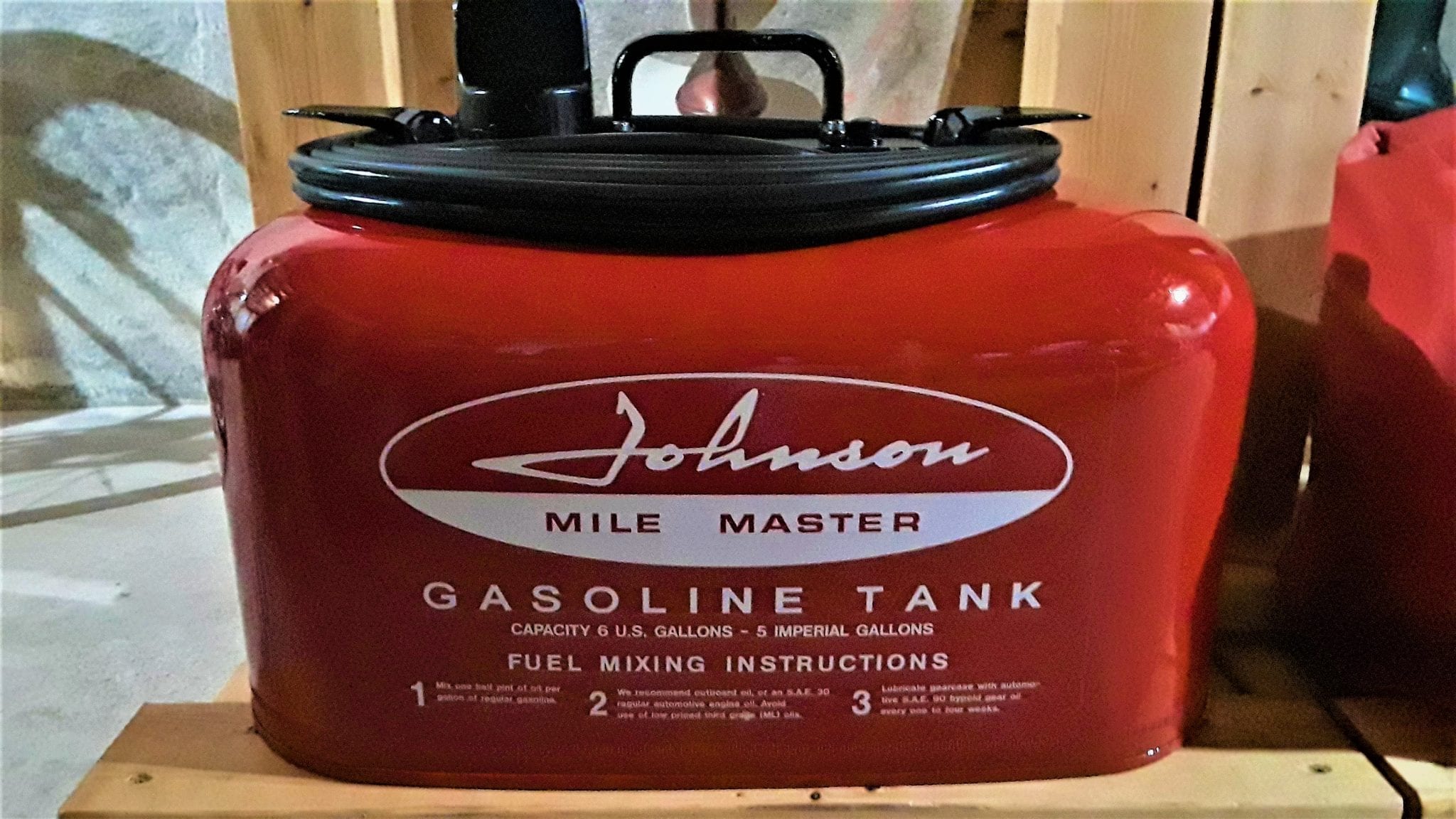

November 3, 2020 at 9:11 am #219967Duplicolor primer and paint from NAPA. Decal from David@Shabestari.com. Not exact but doggone close especially if you use the tank.
November 3, 2020 at 7:37 pm #220021thanks for the help. the Johnson tank looks redder than the Evinrude I have, which I grant is original from 1956, but the paint looks darker red than the Johnson. I will have to contact Peter McDowell.
