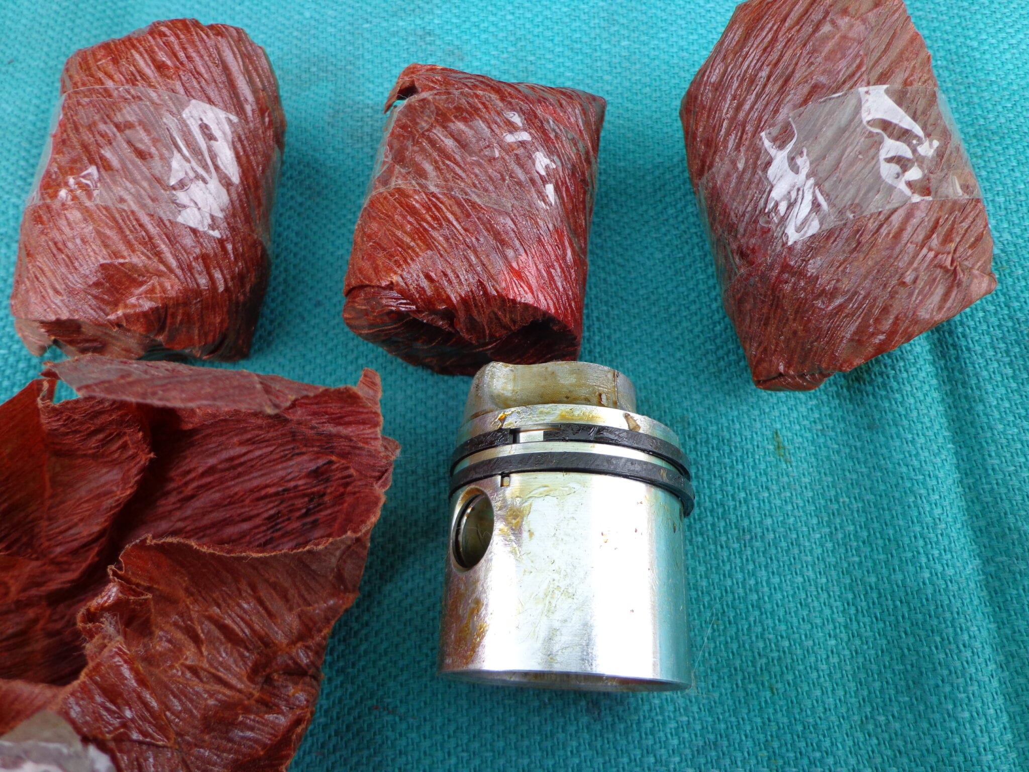

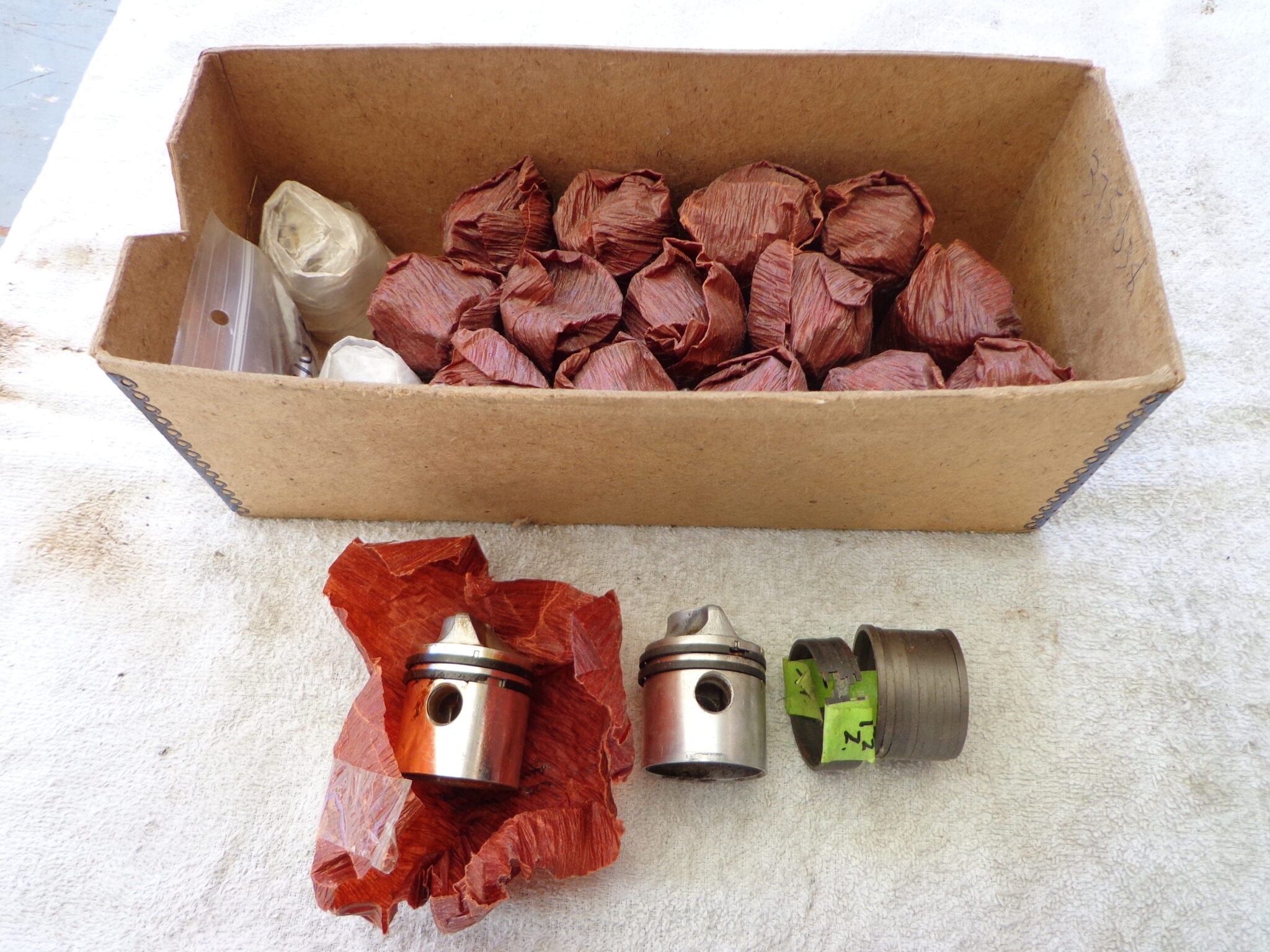

              You needed Zephyr rings? Let me know if you do another build as I have some NOS pistons with rings and also some loose rings left. All standard size.
              DSC00326
              NOS-Zephyr-Pistons-003
              #240934
                  DSC00326
                  Thanks Mumbles, P.M. Sent.
