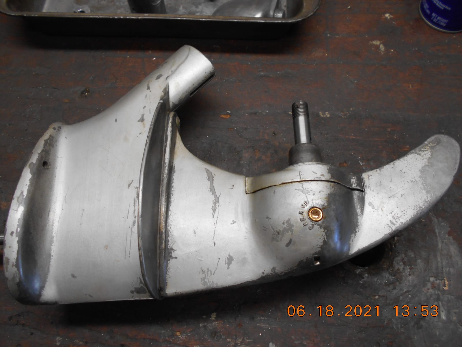

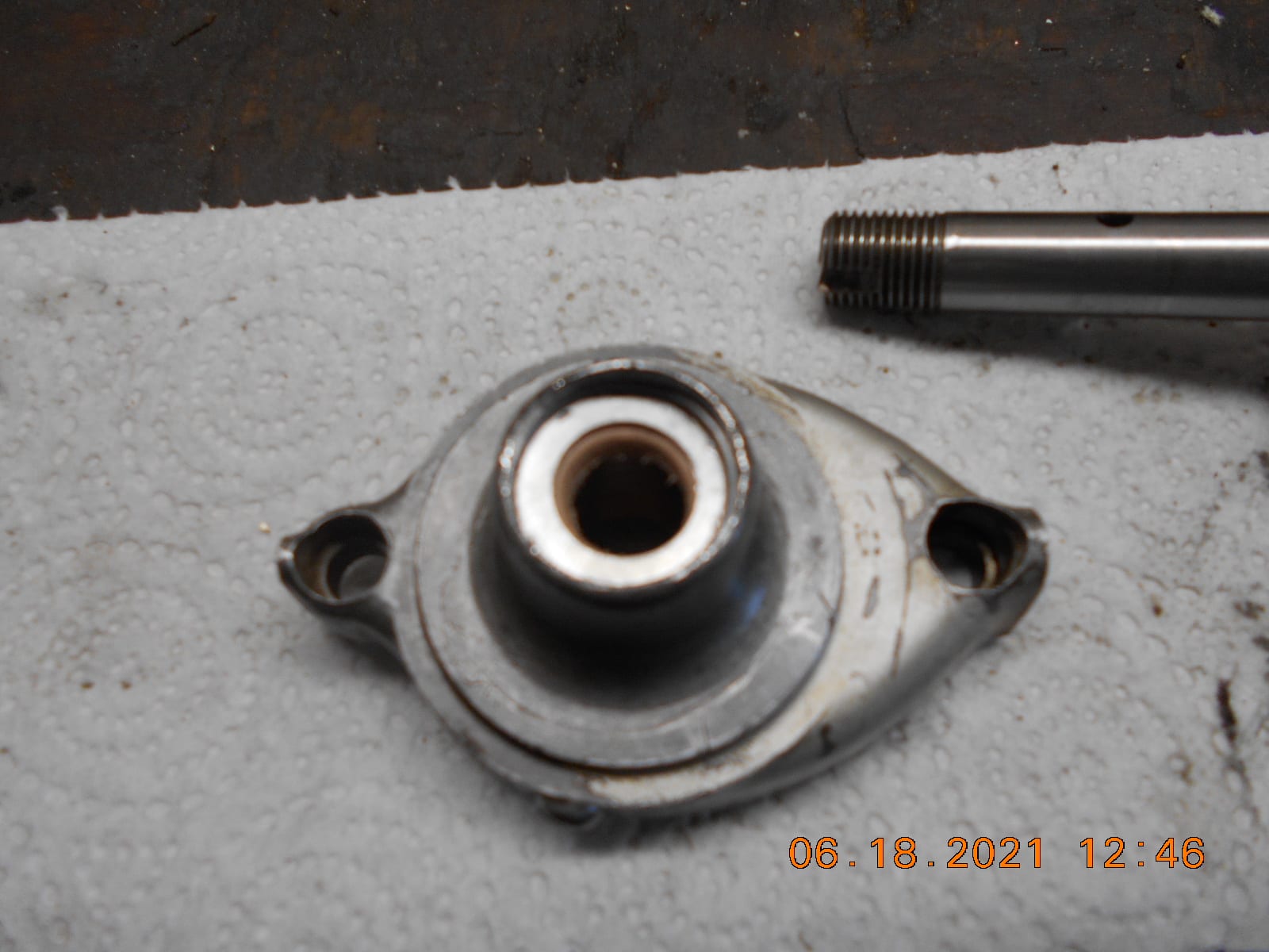

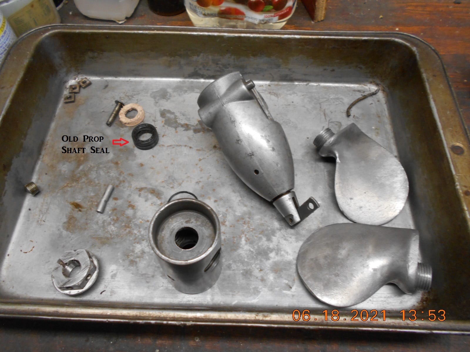

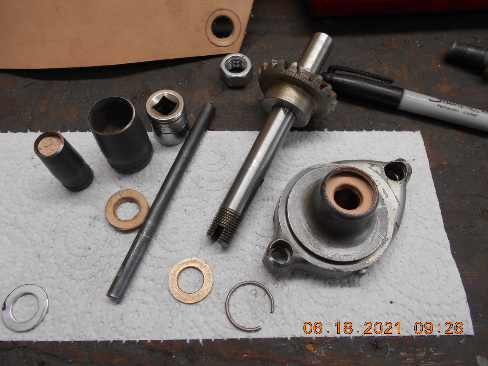

            I didn’t find any good candidates to replace the old prop shaft seal.
            The old “shot” one is a deep affair that had a rib on the OD in the
            center, that located the seal in a groove in the housing bore.
            What came out almost seemed like plastic, but perhaps petrified rubber.
            I made up a heavy leather seal with a thin washer and a snap ring
            to lock it in place. At least better than what was in there.

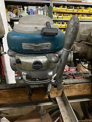

              I have a Zephyr with no twist grip throttle. I have owned 2 of them. I can check it to see what model it is when I get home in about 3 weeks. Your picture of your speed lever looks like it is missing the correct handle for raising and lowering the speed.
              I do believe it is a 4404 also but will have to check.
              I also own 2 with the twist grip throttles. I don’t know their model numbers either but can check.
              Hope that helps,
              Joe
              ps this is one that looks like my speed lever I found on ebay. The guy has the model picture on auction but I can’t make out the numbers but it looks like it ends in a 4. I did send him a message asking him what it is.

                The ’48 Sportsman and Sportwin motors I restored a few years ago had a similar style prop shaft seal with a raised rib on its outer surface which snapped into a retaining groove in the housing. Since they were NLA, I found similar size SKF lip seals with a smooth outer surface and used an adhesive to hold them in place. After all these years, both motors still haven’t leaked a drop of oil. I wonder if the P/N’s for the originals are the same?
                  Hope that helps,
                  Joe
                  s-l500-5
                    If I remember correctly, when I looked on the SKF site, all I could match
                    up for prop shaft seals was some skinny 1/8″ deep ones,
                    costing more than I wanted to pay on EBay anyway.
                    If you have the seals you used documented anywhere, it would
                    be nice to know the part number, in case I tear into one or two
                    more of my Zephyrs.
                    Thanks.
                    #240867
                      From an older post here:
                      If you have to change the prop and drive shaft seals, I just did my 4425 and 4423 Rudes and used SKF 5523 and 4770 seals. They aren’t snap in like the originals but with a bit of adhesive sealer they will work.
                      Them’s the SKF part numbers! Would have to compare P/N’s between 4423/4425 and Zephyr gearcase seals to see if they will work.
