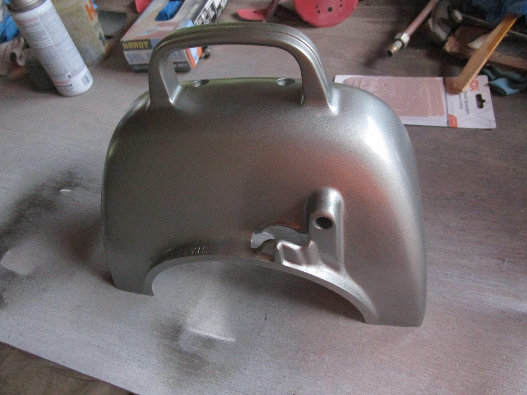

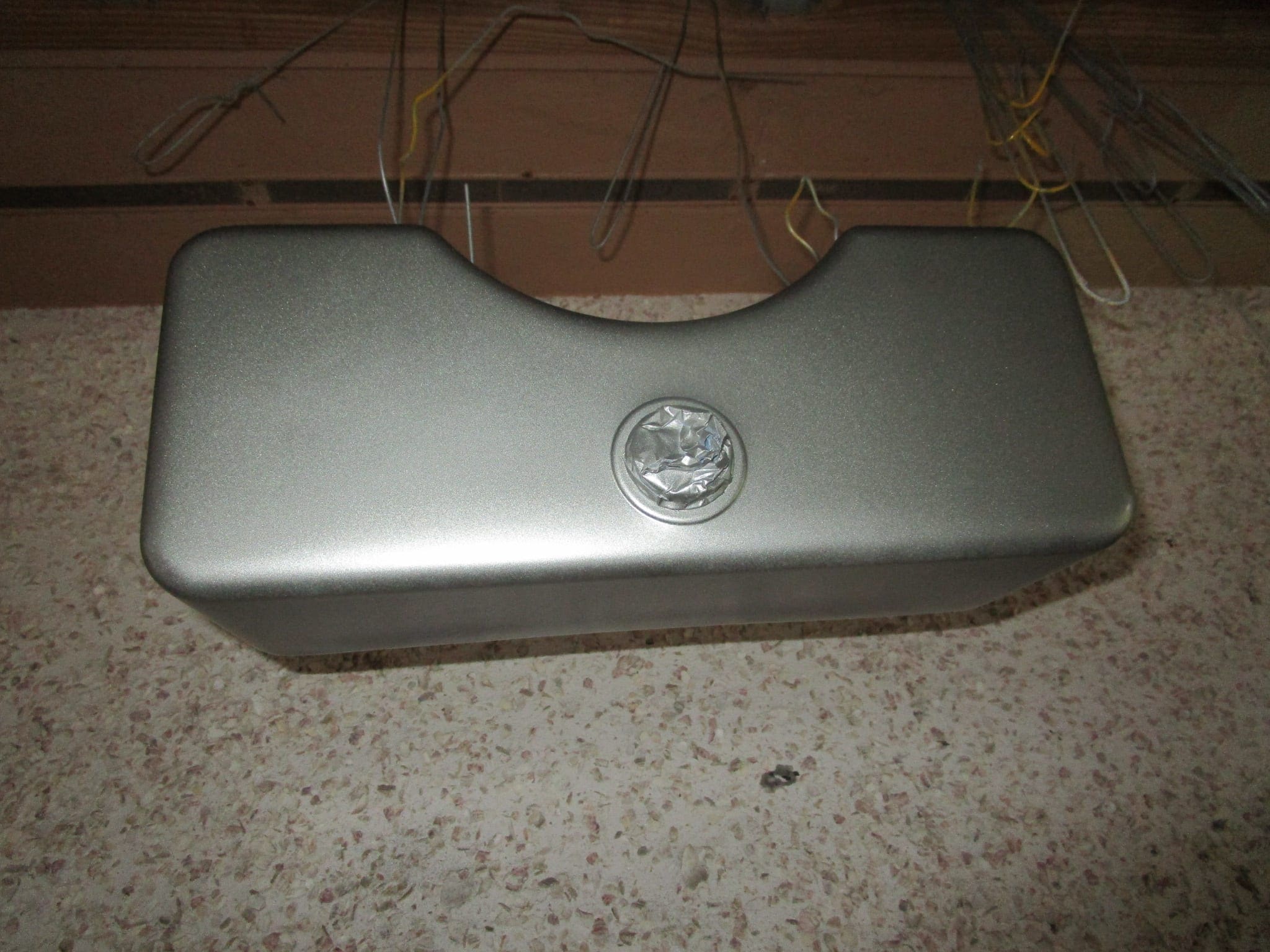

      Mumbles , do you use gloss clear or a matte clear ?
      I’m using the reprotint rattle can paint .
      I’ve never painted metallic paint before . I think next time I’ll use my HVLP ..
      That was 3 coats on the tank and 4 on the shroud …
      6069258D-2877-48CD-8F71-D48AB70DA467
      E1365B91-B80E-4A1B-B041-4E4F0DACCDEB
      #180584
        Thanks guys! Both tanks were done using an automotive base/clear paint system.
        Metallics can be a bit tricky to spray but sometimes I find light mist coats work better than heavy wet coats. A lot of it depends on the outside temperature as you’re wanting the flakes to flatten out before the paint kicks off.
