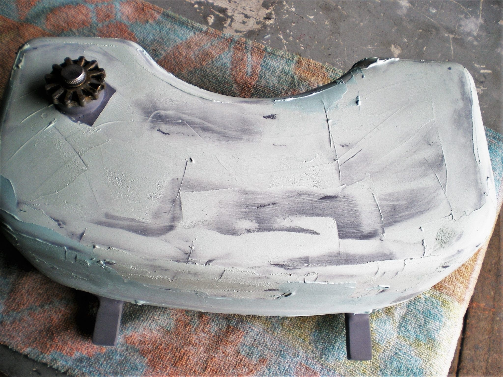

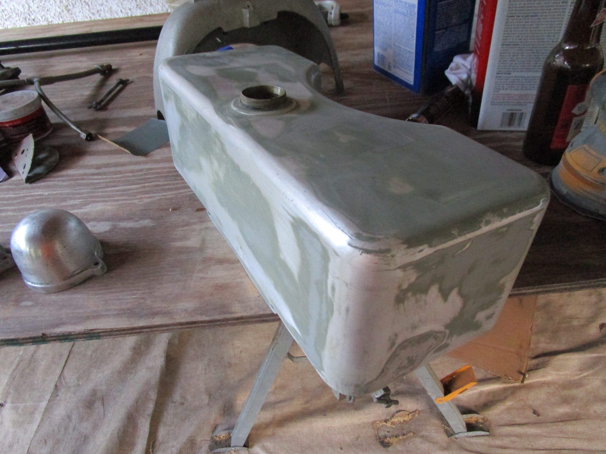

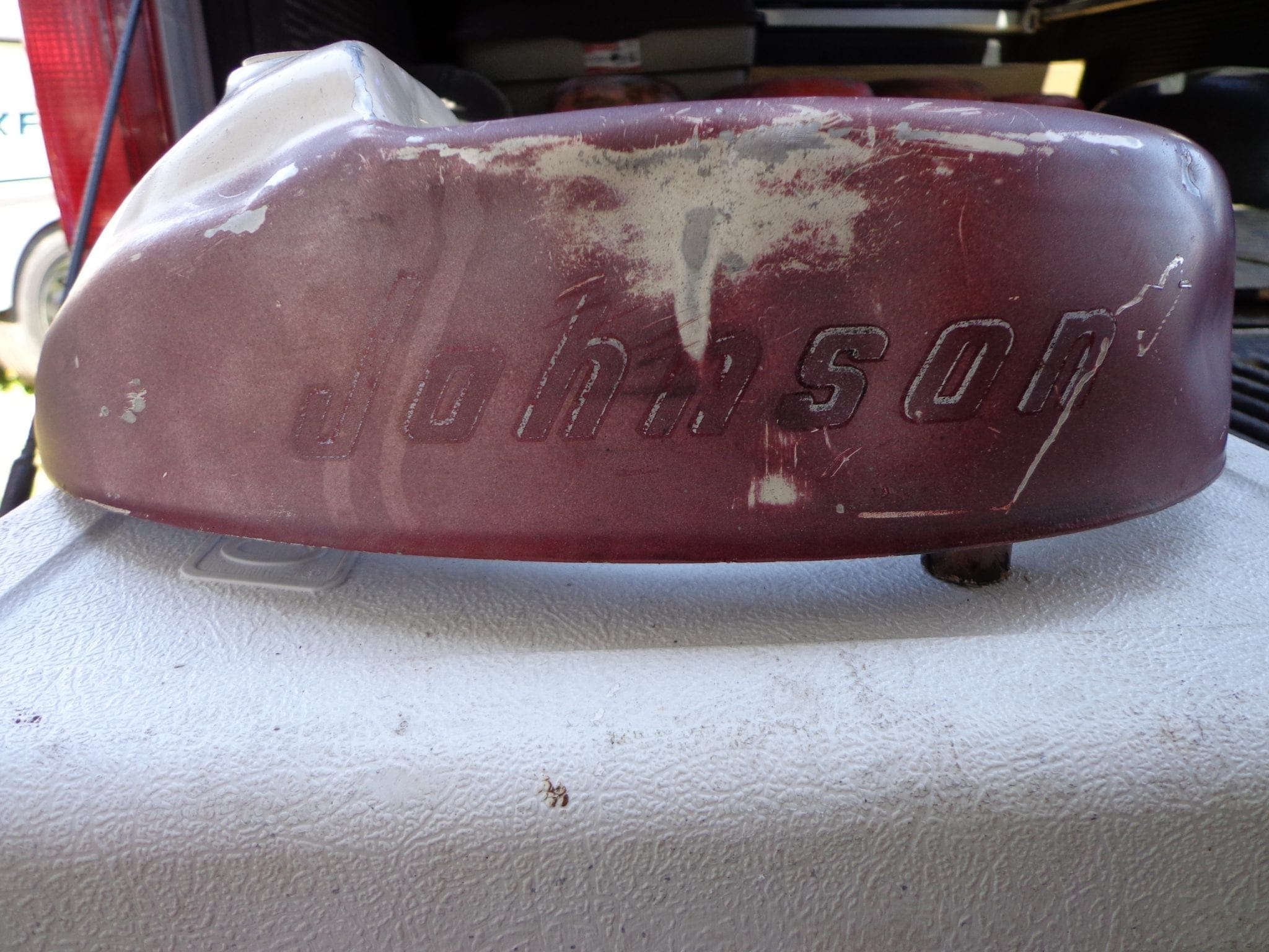

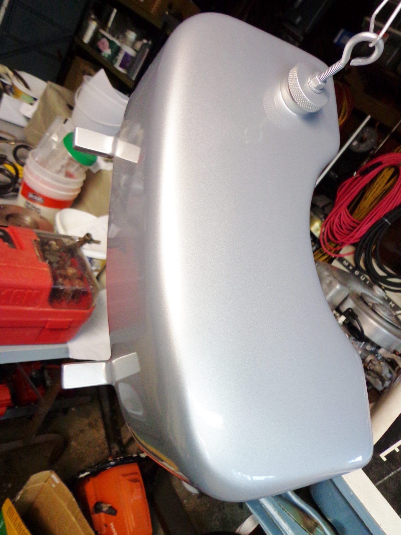

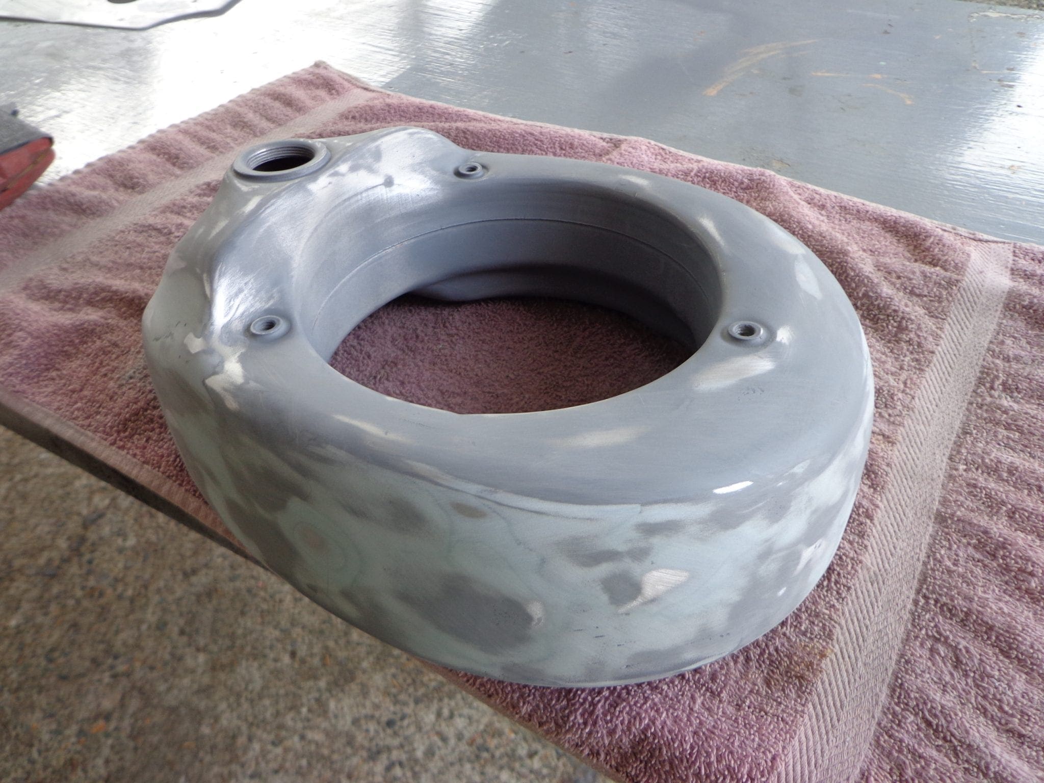

                    What to use? Bondo, bondo, and more bondo! Or any other brand of your favorite plastic body filler. It works well as long as the surface is roughed up a bit so the filler has some tooth to grip to.
                    IMGP2180
                    DSC00155-3
                    DSC00019
                    DSC00155-1
                    1957-JW-Tank

                      amazing work !!
                      #180563
                      Samuel Phelps
                        nice work mumbles !!! Hopefully mine turns out half that good !
