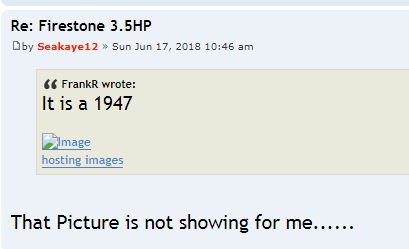

                        quote FrankR:
                        It is a 1947
                        hosting images
                        That Picture is not showing for me……
