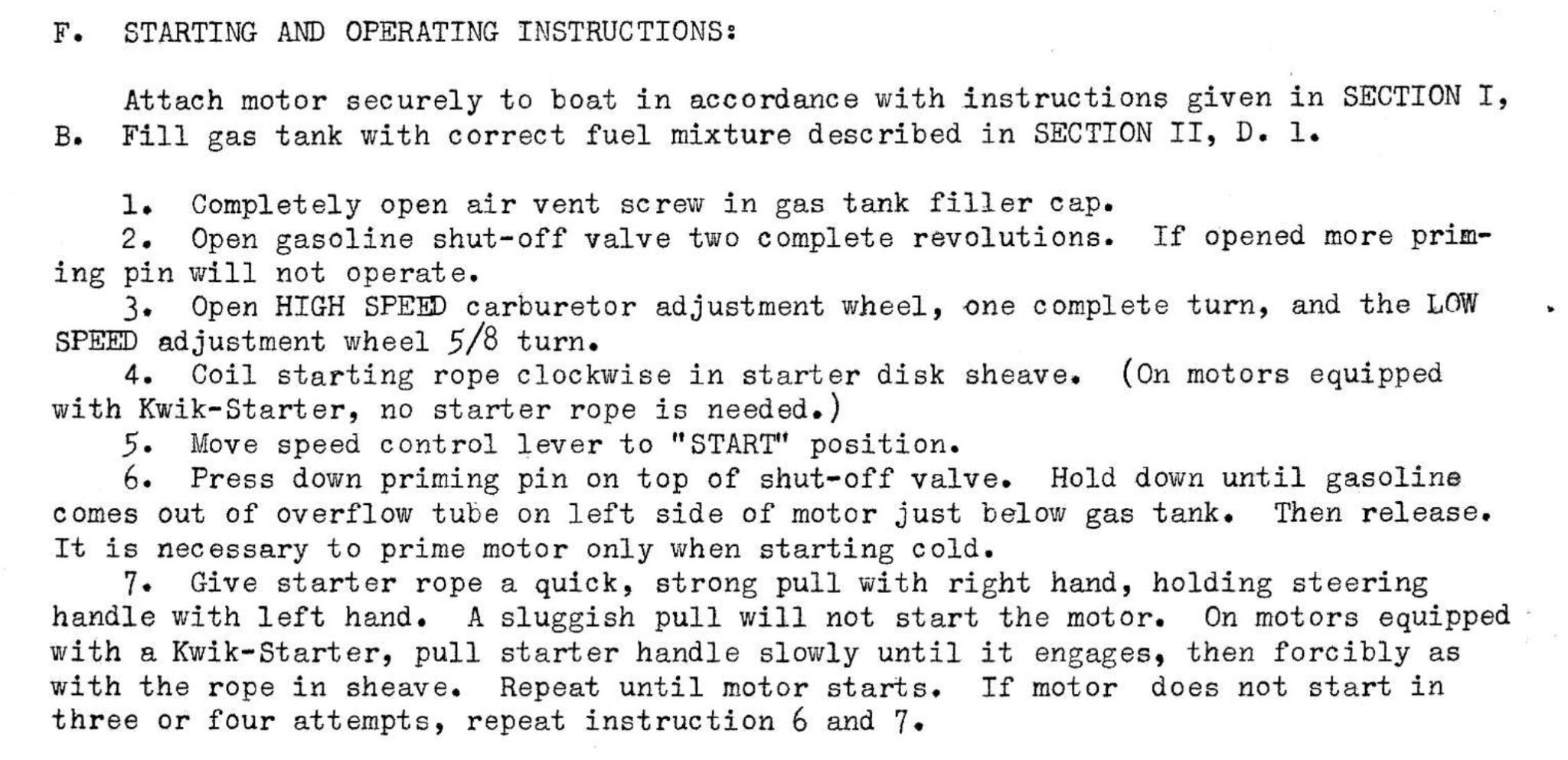

    i am fixing up a flambeau,and hope to get it running , so far it seems to have good spark,the carb may need attention,it should run,but what is the initial setting for the carb gears?other than that, seems to be about 1950,and would like to know a good place to get decals.
    I also need a starter knob , it seems similar to some other motors,so is anyone remaking these?
    wish me luck, Steve.

    #266399
    Flambeau-late

    Thanks for the info.I will put the carb together and let you know what happens.As for the water pump, I have a new impeller ,and the crankcase had a few holes that were sealed with j.bweld., I have got a few pops out of it with quick-start.
