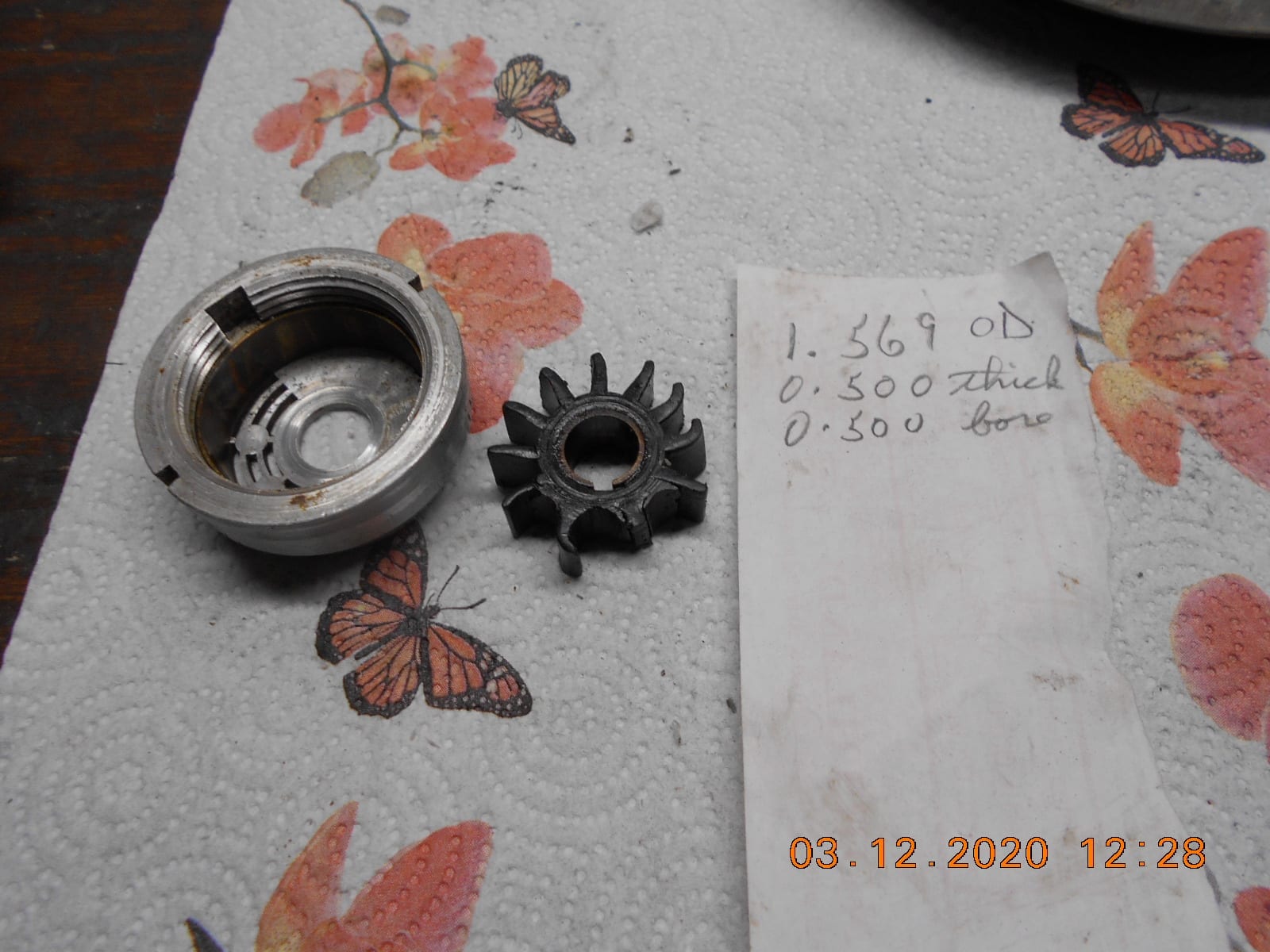

does anybody know how to get the water pump cover off a Flambeau Twin? I assumed it was threaded but it didn’t budge and I don’t want to break anything.
Gcmarsh – good catch on the LH thread. I have never worked on a Flambeau but if one considers the design of the screw -on impellor housing there would be some thought as to whether the impellor rotation would tend to tighten or unscrew the cover. obviously, you want it to tend to tighten the cover.
