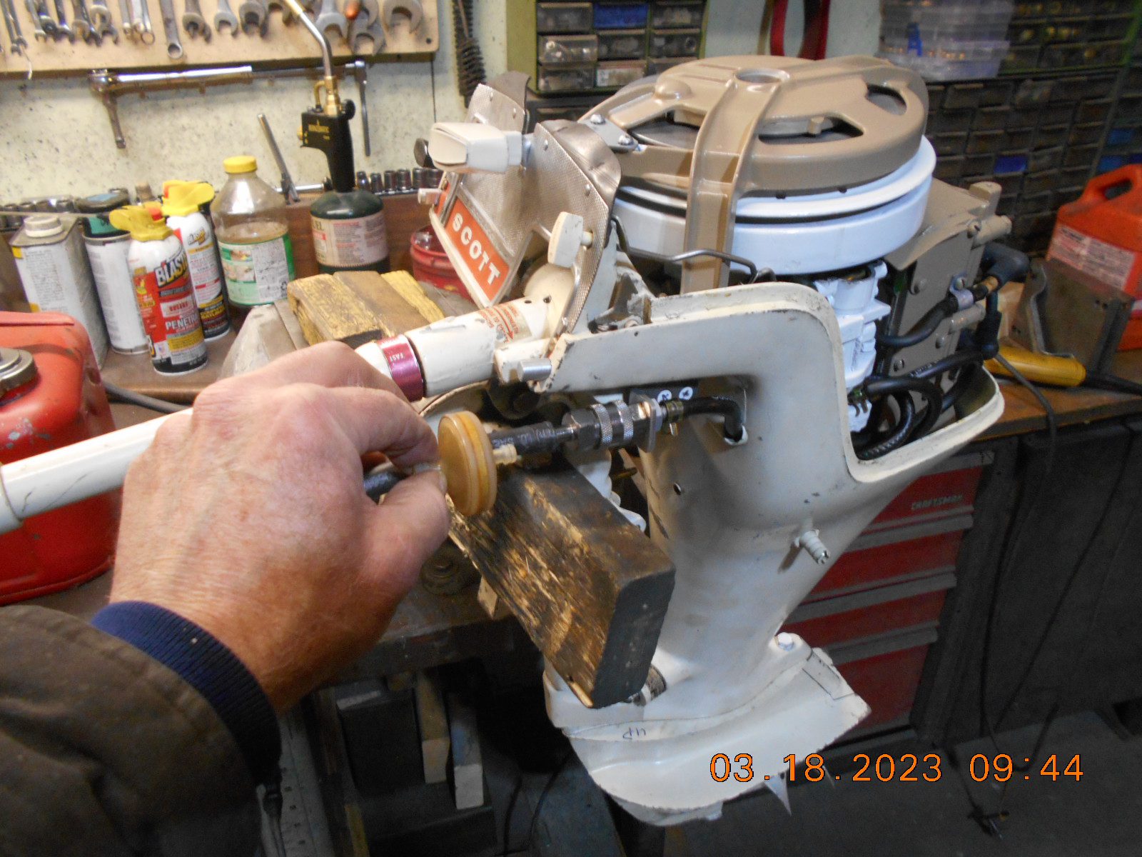

      Would the diaphragm fuel pump and carb work okay
      with a inline filter in the gas tank hose, assuming
      the filter stays relatively clean?
      The fuel pump and carb on this 1960 Scott 7.5 is
      integrated, hence a filter can’t be installed in between
      the two.
      There’s a tiny screen (like chainsaws) in the carb, otherwise
      there’s no other filtration. The only problem, the powerhead
      has to be removed to work on the carb.
      DSCN6469
