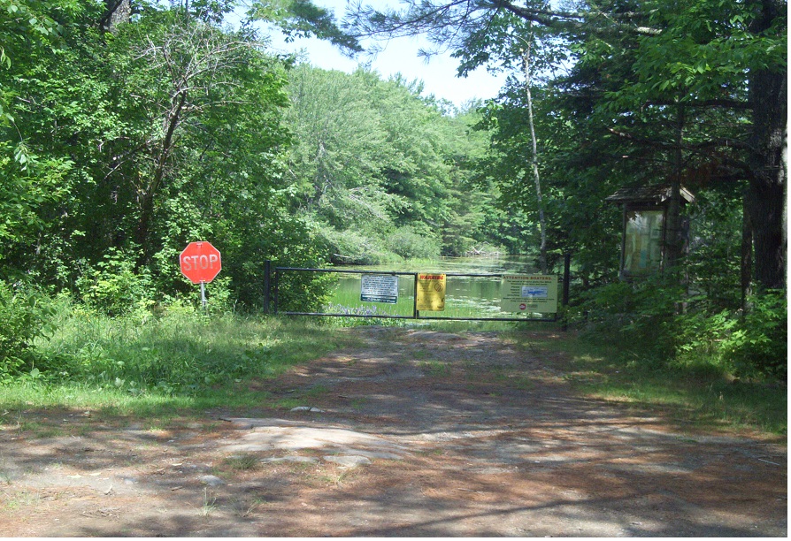

      Running less oil is more about concern for the water
      were you run you motors and protecting the opportunity
      to run them. It only takes a small government like a
      home owners association to control your access to water.
      There are already lakes out west that don’t allow two
      cycle motors anymore. Putting a large oil slick on the
      water or running a smoky motor can get the attention
      of the wrong people. Manufactures were

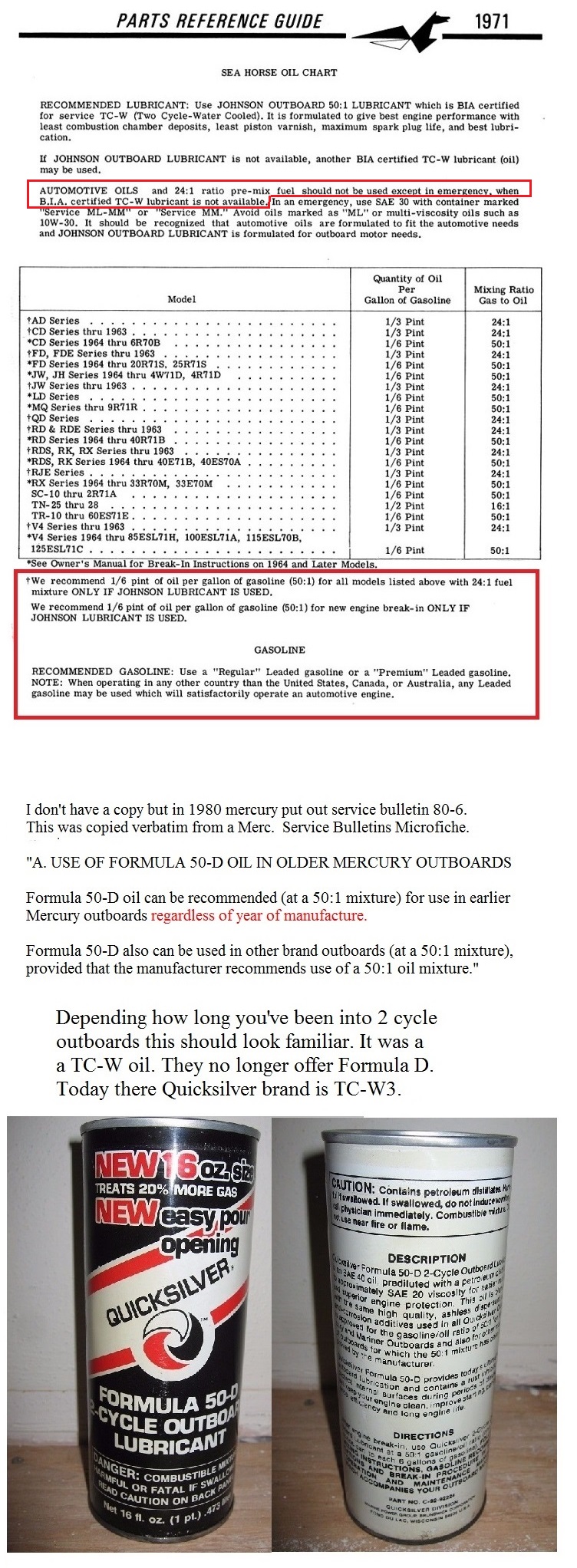

      hurting you motor. This is some of the factory oil
      recommendations put out in the early 70’s. You may find
      this helpful in deciding what is the right amount of oil for you.
      #71963
        I have the same list Tubs posted in my ’80 Parts Guide but I strongly disagree with a few things on it. First, I would never run an AD or pre ’61 CD motor on anything less than 16:1 because of their rod bearing design. The same goes with the three horse JW-JH series of motors although they will live on 24:1 mix. At least they got the TN right at 16:1 as it needs the extra oil to seal itself.
        You might notice that lots of these 50:1 motors from the sixties and seventies have vanished but there’s still lots of motors in use from the fifties and forties. I wonder if it has something to do with the little bit of extra oil added to the mix?

          Agree with Mumbles. That list is crazy. Good way to destroy our hobby in my opinion. I personally would like to see my grandkids enjoying my motors, and their grandkids after them. I have a SHED full of Johnson CDs and ADs where the owners followed "Bob the Builders" advice down the street and ran them on 50:1 and they detonated. Spending an extra couple bucks on oil per tank is NOT going to destroy our Lakes and Water front. Being irresponsible will. Keep your motor in proper tune and enjoy them.

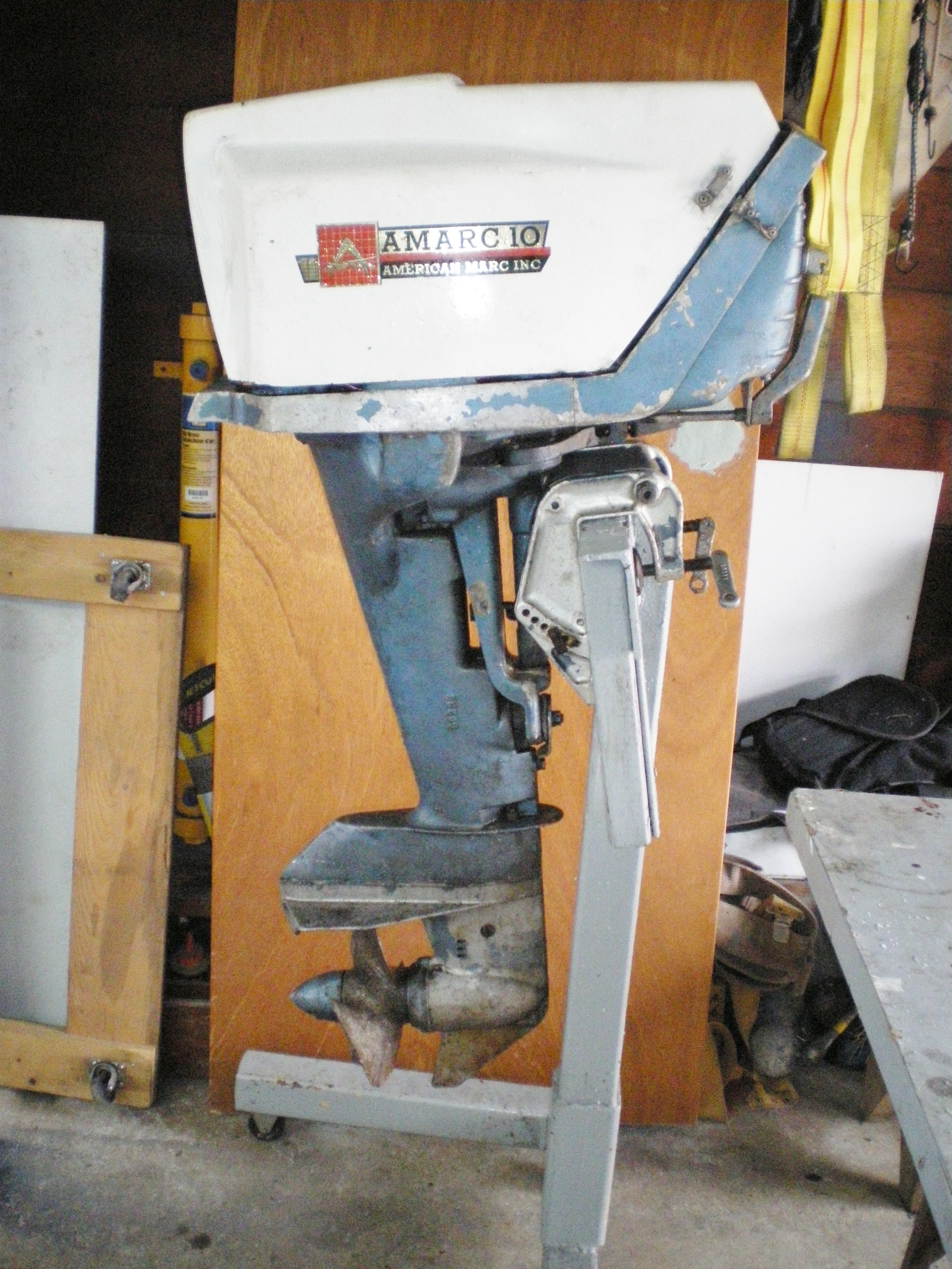

            Note that the Champion Hotrod racing motors called for a 4 to 1 mix! When do you start calling them a diesel?
            #71971
              quote outbdnut2:
              When they say AMARC on the hood! ☺

                  I completely agree here. The little 3 horse needs the 16:1 because there isn’t any needles in it, except the later ones having the top crank bearing on needles.
                  Oil is the cheapest thing you’ll ever put in an outboard
