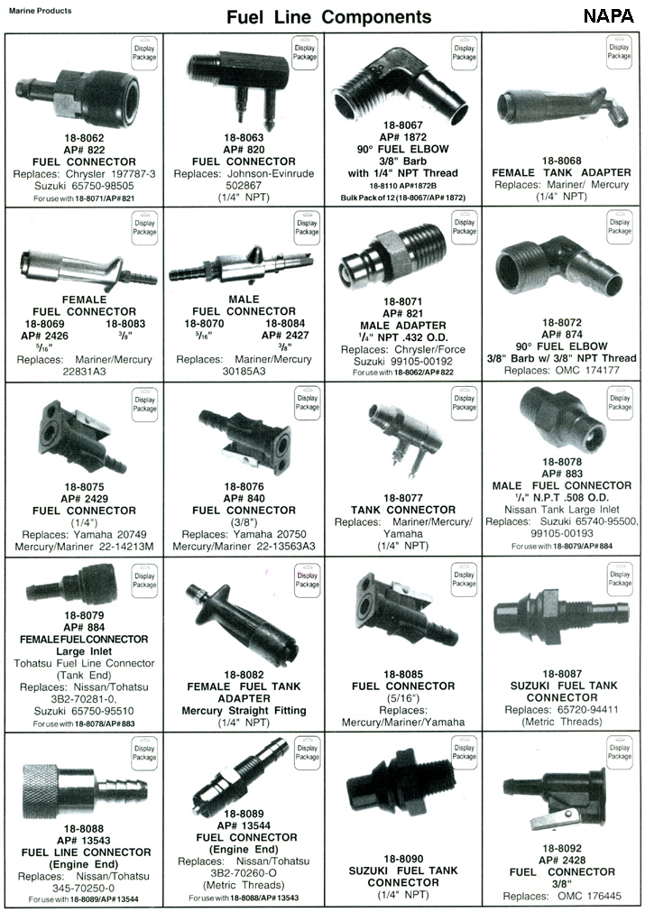

March 2, 2017 at 7:48 pm #53719TRUE, tanks made these days are not pressure tanks. Yes there is a tube going from the fitting on the top downside the tank to very near the bottom of the tank. There should be a fine screen at the bottom of the "dip tube" . There is a vent screw on the filler cap,that needs to be opened when running motor .You will have to get a male gas line connector fitting that screws into the side of the top tank threaded hole. all your gas line connecting have to be for a certain motor manufacturer, matches the same brand configuration fitting that is on your fuel line . If you go with OMC Johnson/Evinrude, don’t get aftermarket (Attwood, Seastar, Perko ) fittings . Buy BRP Johnson/Evinrude as they fit better,and don’t leak or suck air .That has been my experience,others have mentioned the same issue.
Robbie RobertsonMarch 2, 2017 at 10:09 pm #53728Very true on the fuel connectors… I would suggest to go only OEM on the connectors and the fuel hose. One word of caution though on buying a brand new plastic fuel tank… the current [new] fuel tanks do not have an air vent that will open and close like we are all used to. Instead, they have a one way vent that will allow atmospheric pressure in, only while the engine is running and consuming fuel. The problem is, while the boat is setting outside in the sun with the engine off, the one way vent will NOT allow any venting OUT to allow for the expansion of the fuel. Often times these tanks will eventually leak fuel because of pressure pushing fuel out around the cap threads. You end up with a big mess with fuel leaking inside the boat. My advice is to find an older tank that has a vent. And it will will be much less expensive . Hope this will be of help…
March 2, 2017 at 10:19 pm #53730Yes – OMC connectors are the most popular. . . 😆
