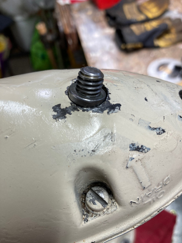

            The upper plug…which needed to have my compressor fitting really tight to eliminate bubbles…had a plug with a white nylon washer in good condition.
            The lower plug (no bubbles, not leaking for the test…but I opened it to drain the gearcase and re-seated it for the test, so that’s not necessarily indicative that it was sealed while boating)…it has the remnants of a fiber washer mashed badly into the gearcase opening and will require some surgery to get it all cleaned out.

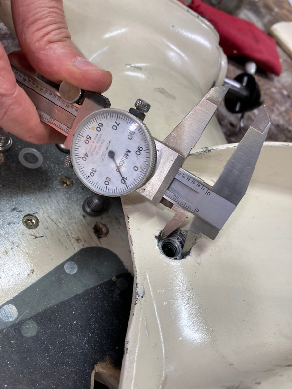

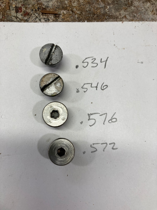

                        I think I may have had a “eureka” moment today…and it dovetails with fleetwin’s post above: A gasket is a gasket & a screw is a screw, right? Not so fast!
                        Unlike most of you, I’ve had…over the years…a few ’50s and ’60s engines, but right now I only have one. My “pieces & parts” drawers are not as extensive as yours…so all I seem to have are four (4) plugs, and they’re all different head diameters:
                        At this point I can’t tell you which 2 were in this engine and which were in my parts drawer. But what’s even more interesting is my gearcase: the two race holes are not the same size. Yes, they’re both 3/8-16, but the race where the washer & plug head seat are different.
                        Lower plug hole race: 0.546″
                        Upper plug hole race: 0.610″
                        I have only one (1) plug that fits my lower…the 0.534″
                        …but my 0.546 plug will not fit in my 0.546 port.
                        It is entirely possible that my “seal” was metal-on-metal and the washer wasn’t compressed at all. This could be the source of my leak
