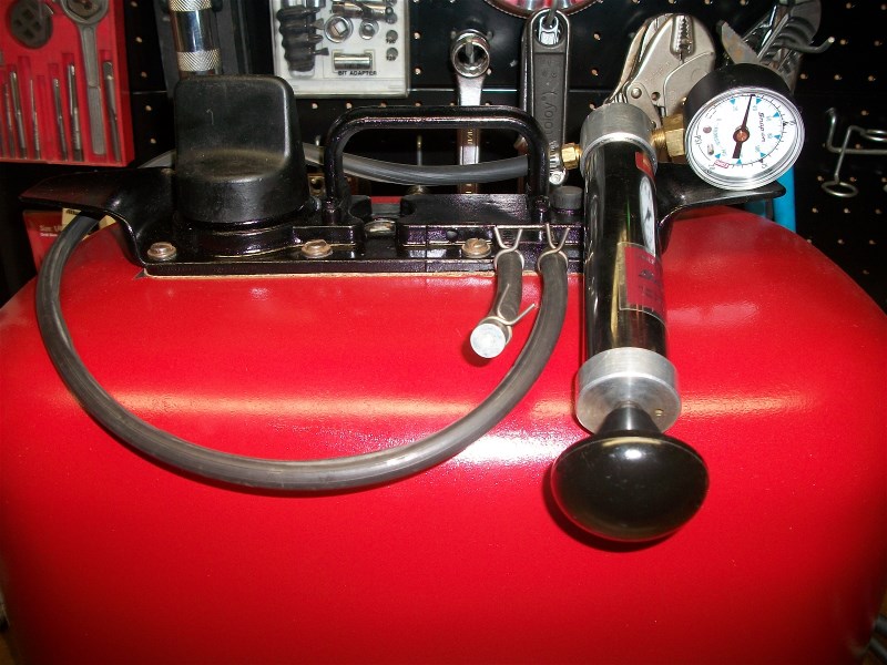

      Looking at a nice homemade pressure tester in another recent post got me to thinking. I’ve been going to make a tester for a long time. I have an automotive radiator/coolant system pressure tester I bought 30 years ago and haven’t used for many years, and I’m thinking of adapting that for gearcase pressure. It has a hand pump, checkvalve, and a gauge and is made to go from 0 to 30 pounds.
      It looks nearly identical to the photo below (from O’Reilly auto’s website) – I’m thinking all I have to do is replace the radiator cap on the end of the hose with a fitting to thread into the lower gearcase drain hole. Maybe use compressed air quick-connect fittings to switch back to the radiator cap. Has anyone done that? Your thoughts?

        Sure seems like it would work.
        #84151

          Yes would work fine.

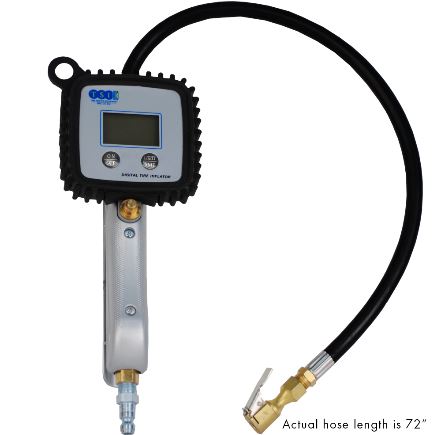

          I made mine from a tire inflator/gauge as in the picture below. I simply cut off the end that attaches to the tire and installed one from the link below it that fits into a gearcase.
          https://www.ebay.com/itm/CDI-551-34TN-T … 1438.l2649
          #84155
          rco
            That’s what I did to make mine. I added quick connects so I could go back and forth from auto to outboard testing. I drilled a 3/8" NC stud to let the air through and threaded that into a male quick connector with a thick rubber washer to seal it to the gear case. Works great, and the 3/8 thread fits OMC, Merc, and Chrysler at least.

                David Stanton
                  Thanks guys, I think I’ll convert my radiator tester and it never occurred to me to use it to test pressure tanks.
