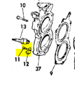

      that lower nut on the cyl head of the 9.5 turtles (MQ’s – 9R72) is kind of hard to reach and tighten properly even with a socket & flex joint with the lower housing in the way
      it is way at the bottom and the adjacent… . vertical water tube
      any special trick to apply the necessary inch/lbs
