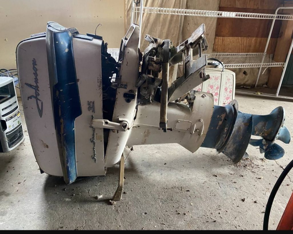

      Hey fellas I’m looking at this 35hp johnson as a possible power plant for my runabout i was looking to see if u guys knew the year , if it is a long or short shaft , and if anyone knew if they were ok engines or if they had issues thanks guys

        1958 Super Seahorse with a transplanted Evinrude lower unit with the long shaft extension. Guess that’s why they also painted the cowl trim and top blue.

          Looks to be a long shaft what goes into converting it back to a short shaft ? Removing the extension and the proper short drive shaft ?

            Yes – has the extension piece between the exhaust housing and lower unit.

                If an inspection shows the motor to be in decent condition and the price is right, you could always convert it to a short shaft. You’d have to find the shorter driveshaft, shift rod and water tubes (this motor has 2). Those pieces are out there but could be pricey.
