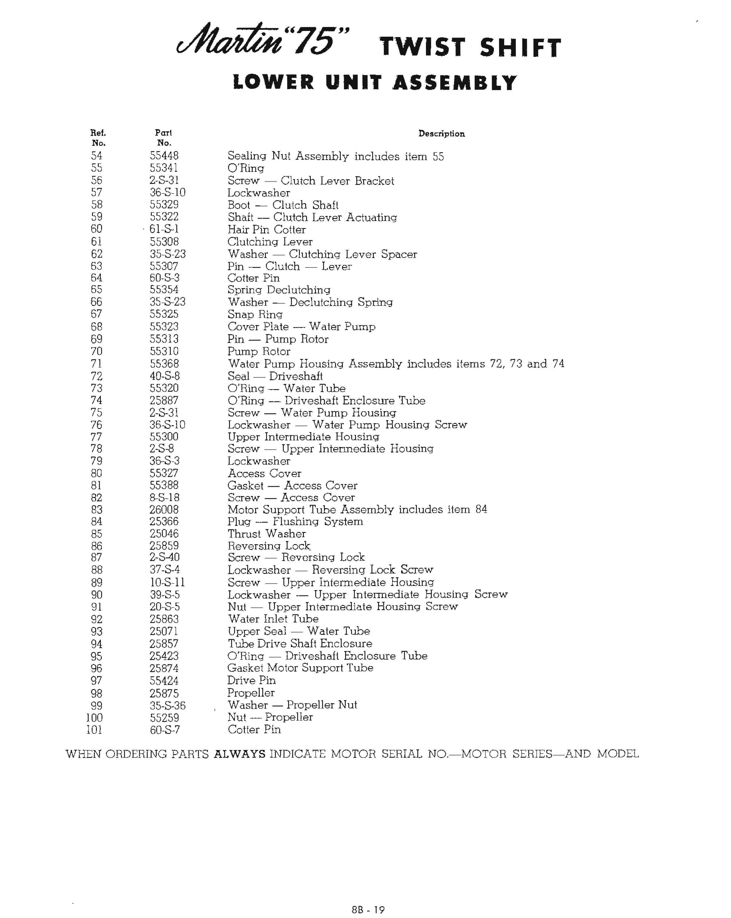

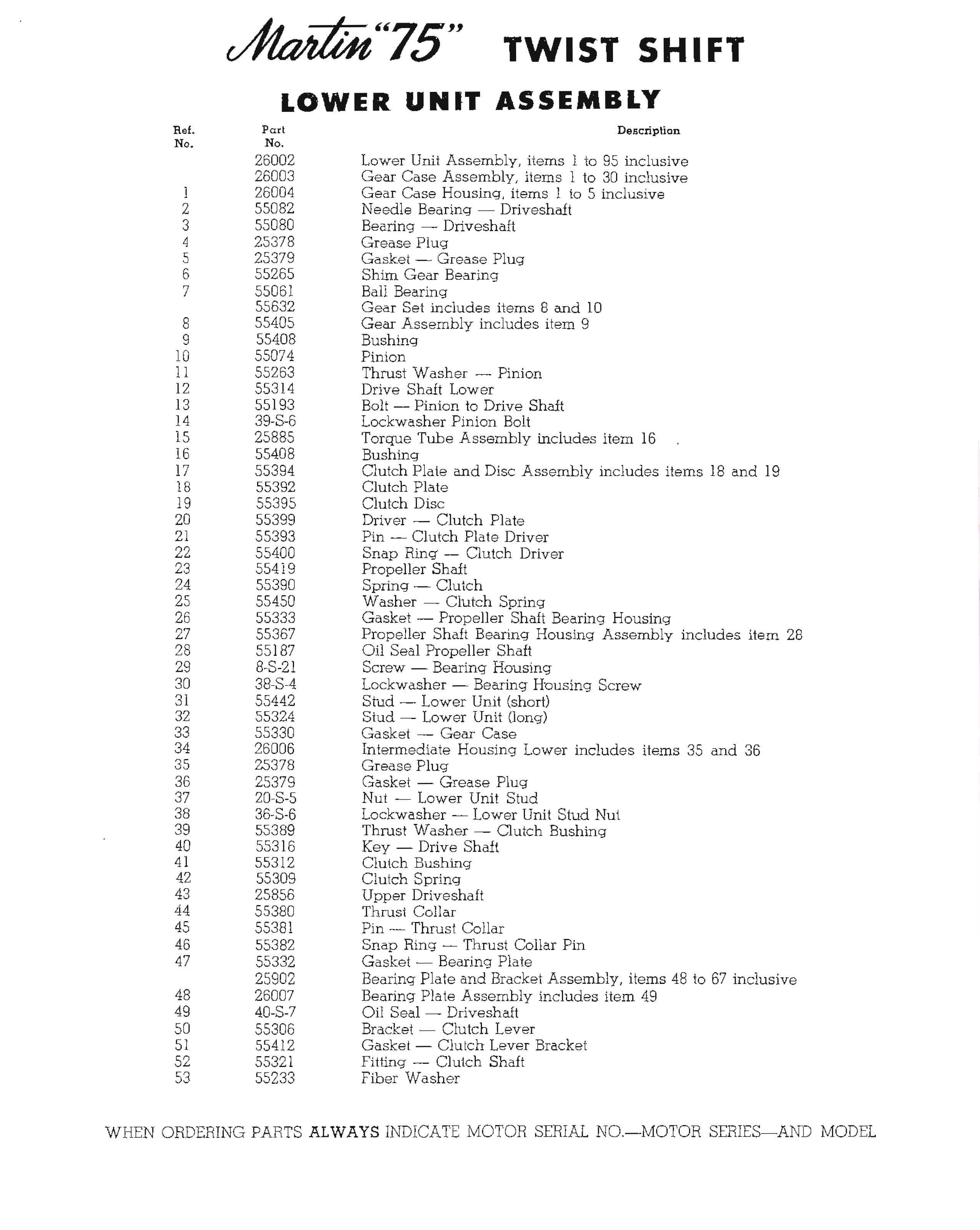

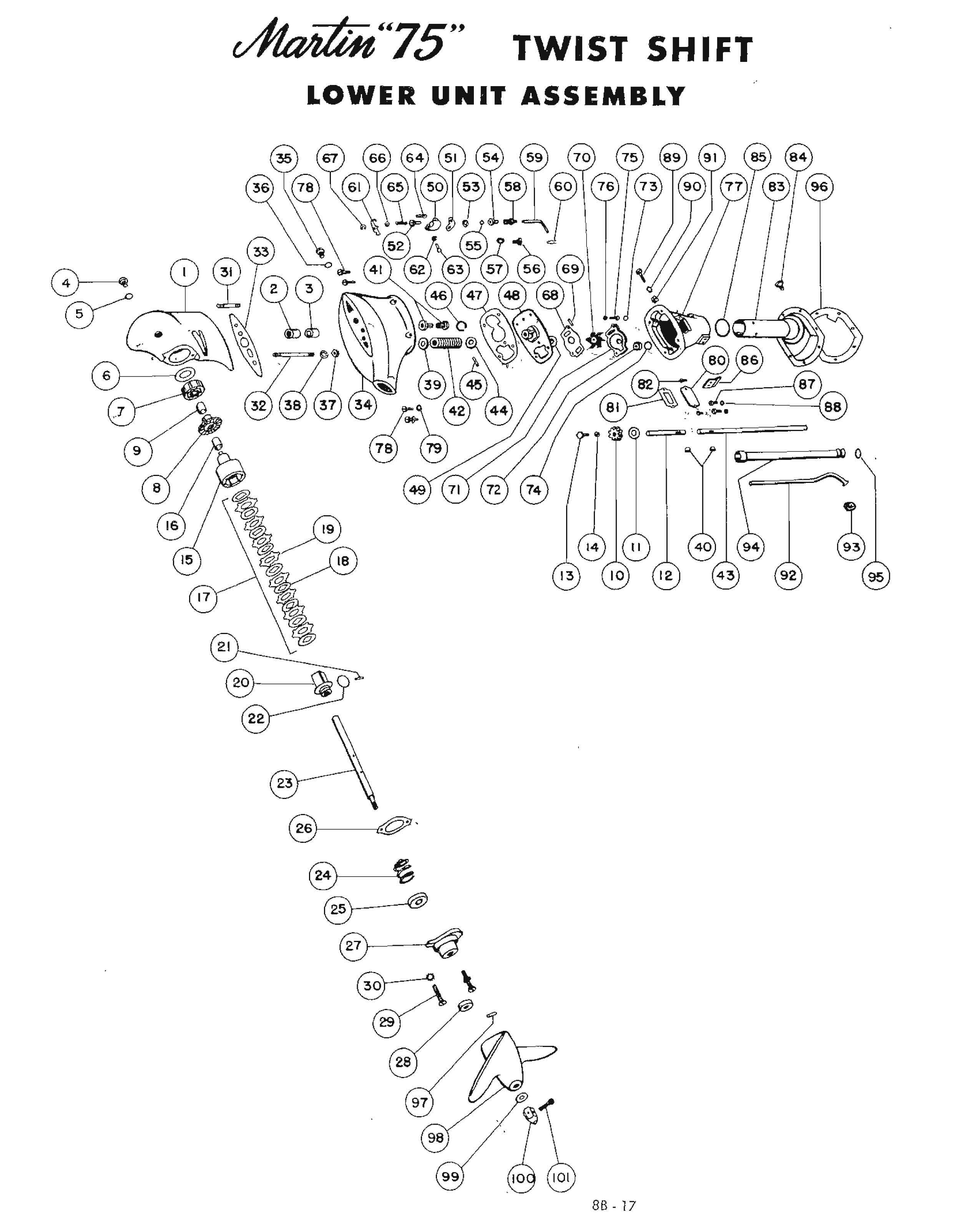

  • #72185
    hiram1914
      Maybe these would help.
      #72197

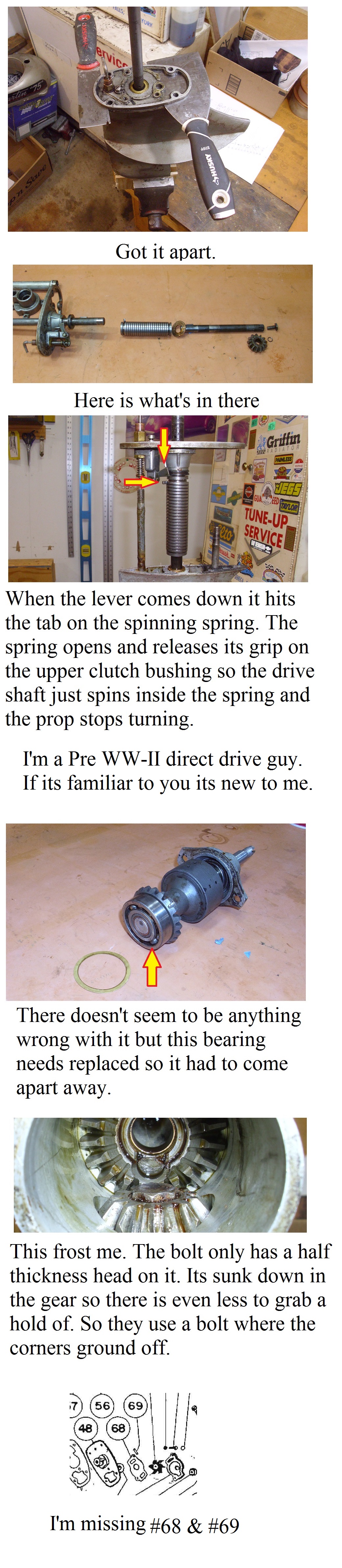

        Thanks hiram1914 for the copy’s from the parts manual.
        They look to be similar if not the same as what Buccaneer
        posted. I did try pulling up on the rod Tom but no luck.
        Before I took it apart I could turn the prop backwards
        with out the flywheel turning but not forward so the
        drive shaft must be split in there somewhere. It may just
        be stuck. The recoil was stuck and wouldn’t engage and
        both butterflies in the carburetor were stuck. I think
        I’ll take off the drive shaft gear and try slipping everything
        out hoping it all stays together I don’t understand how it
        works from the diagram. Maybe it will make more sense
        when I get it all out. Thanks again.

              That is exactly how a TN-xx Johnson clutch operates. Not unfamiliar at all, they made umpteen thousands of them. Just a different shape. Other companies also used the basic design theory (i.e. Evinrude, Gale, Mercury, Champion to name a few).

                #72264
                  Somebody has been in this motor before me. All the
                  fasteners are loose. Even the spark plugs. The old
                  impeller was tied to the tiller. Apparently when the
                  motor got put back together the impeller pin and
                  plate were left out. Missing parts will be a big
                  problem because I wont know what they are. So far
                  the motor seems to be in good condition inside but it
                  needs coils, condensers, seals, impeller, that plate,
                  a prop shaft bearing, plugs and wires so far. Add
                  paint, decals, and a new grip so it looks as it did
                  and what ever else I may find and I’ll have more in
                  it than its worth. I seem to be and expert at doing
                  that but when you get a motor on the boat for the
                  first time and fire it up and it runs well none of
                  that stuff seem to matter. If it doesn’t run well
                  or won’t even start? Well I guess I just didn’t spend
                  enough.
