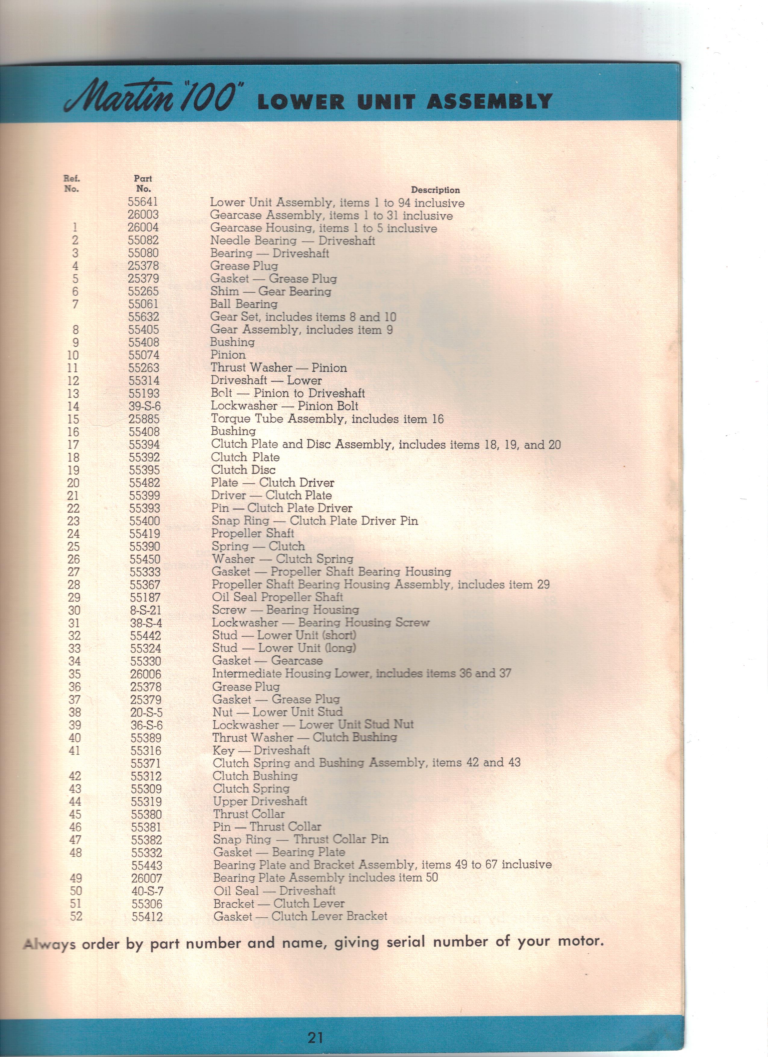

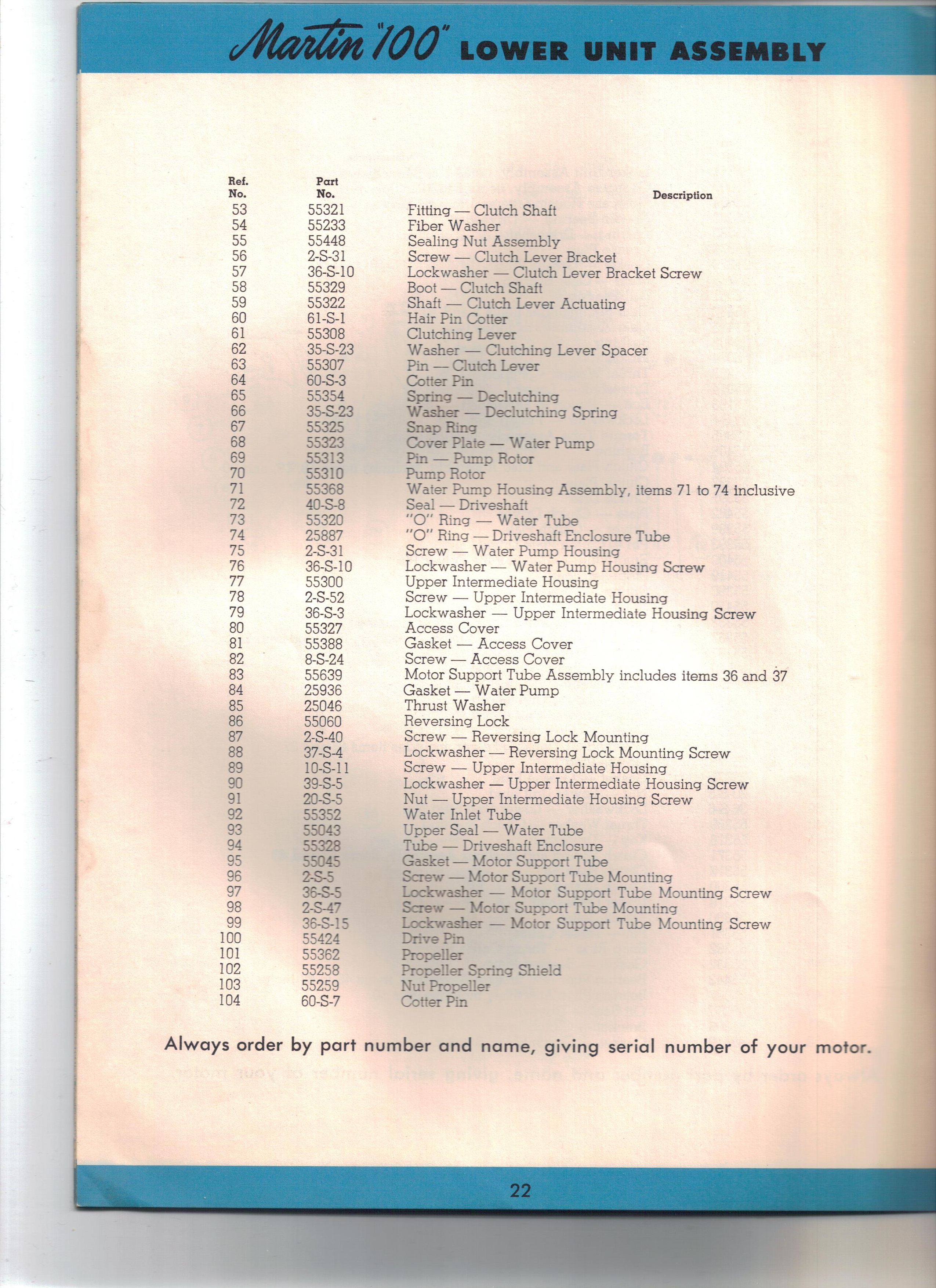

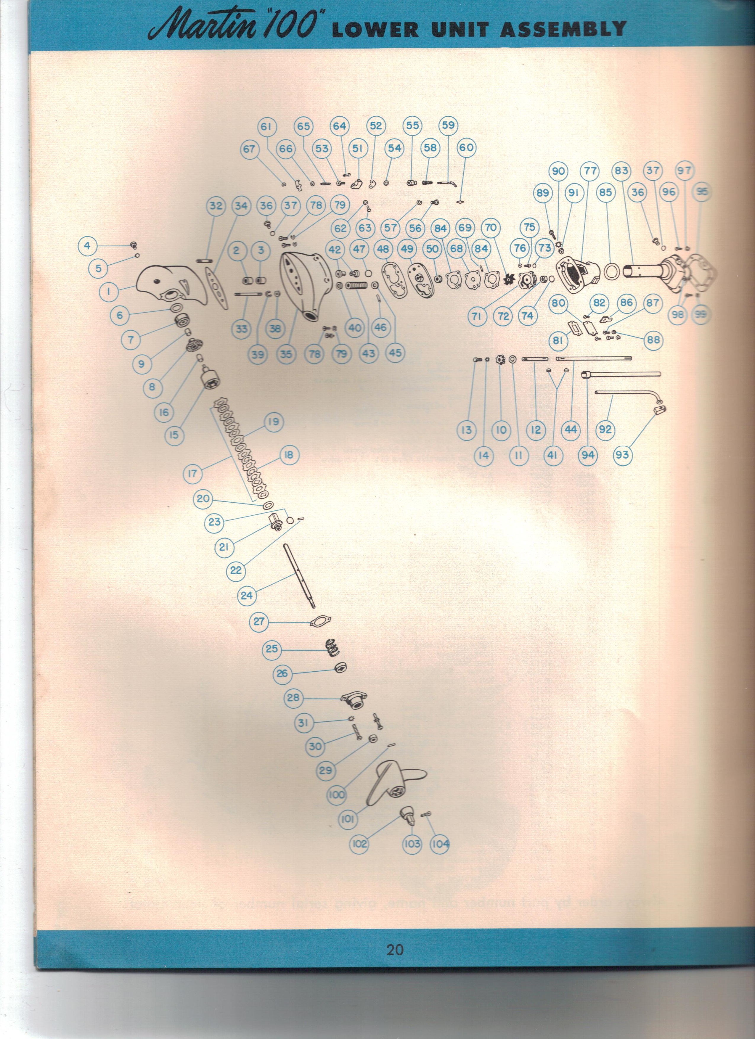

March 7, 2018 at 11:21 pm #72146Tubs, I have these pages for the Martin 100 lower unit that
has a neutral shift. Perhaps it’s similar to the TS 75 Martin?
I wished I had the actual motor!

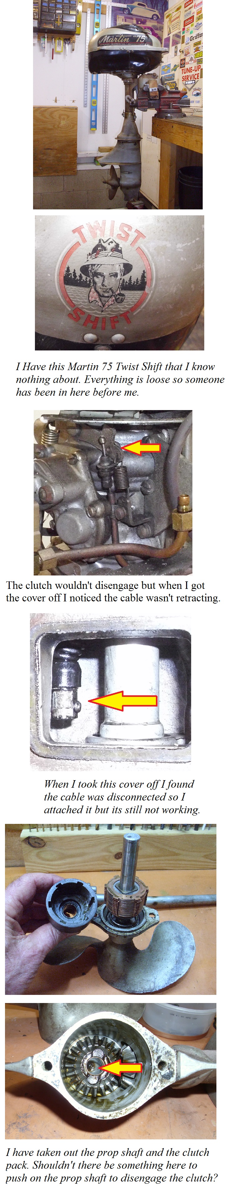

March 8, 2018 at 12:14 am #72149Thanks Buc.
I was thinking the drive shaft was a single
piece in my mind but I guess its not. Looks
like the shaft disengages under this plate. I
took the 4 screws out but it didn’t want to
separate easily. I thought it would be wise
to ask a few questions first. I’m not sure
about that remaining screw. Is it holding
something together under the cover or
dose it need to come out to remove it.
I’m going wait to see what other responses
I get. Would hurt to have some guidance
in getting it apart. I don’t see the lever that
disengages the shaft (if that is what happens)
on mine but the clutch pack and assembly
on the prop shaft looks the same.
This ring a bell Frank?
March 8, 2018 at 1:18 am #72161AHA! As I thought, #43 is the clutch spring. Works similar to TN Johnsons. I got you this far, that’s about all I remember.
March 8, 2018 at 2:29 am #72168Sounds like your on the right track now Tubs.
Not sure what’s holding it from coming apart.
Perhaps just gasket cement?
Perhaps the clutch spring needs to be "unwound" off the drum
by holding the prop shaft and spinning the driveshaft backwords?
Then there’s always the bolt holding the pinion gear on the end

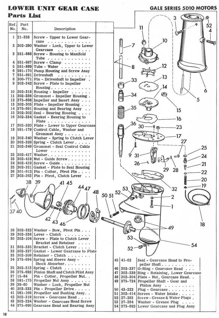

of the driveshaft….. probably not that, but just a thought.I was just putting together a Gale 5D10 lower unit off an Atlas today.
Not sure how similar the Martin may be.Hope to hear and see more on your progress in case I ever tear my
TS 75 apart!Prepare to be boarded!
March 8, 2018 at 2:49 am #72169Is it possible that the adjustment was incorrect where the cable goes into the tube to the lower unit? Maybe that bent rod just didn’t get pulled up far enough to put the motor in neutral. Now that you have the lower unit off, try raising the rod as far as you can and see if you get the neutral. Keep in mind that there may be enough friction to make it seem the motor is NOT in neutral, you’ll have to put some resistance to keep the prop from turning.
