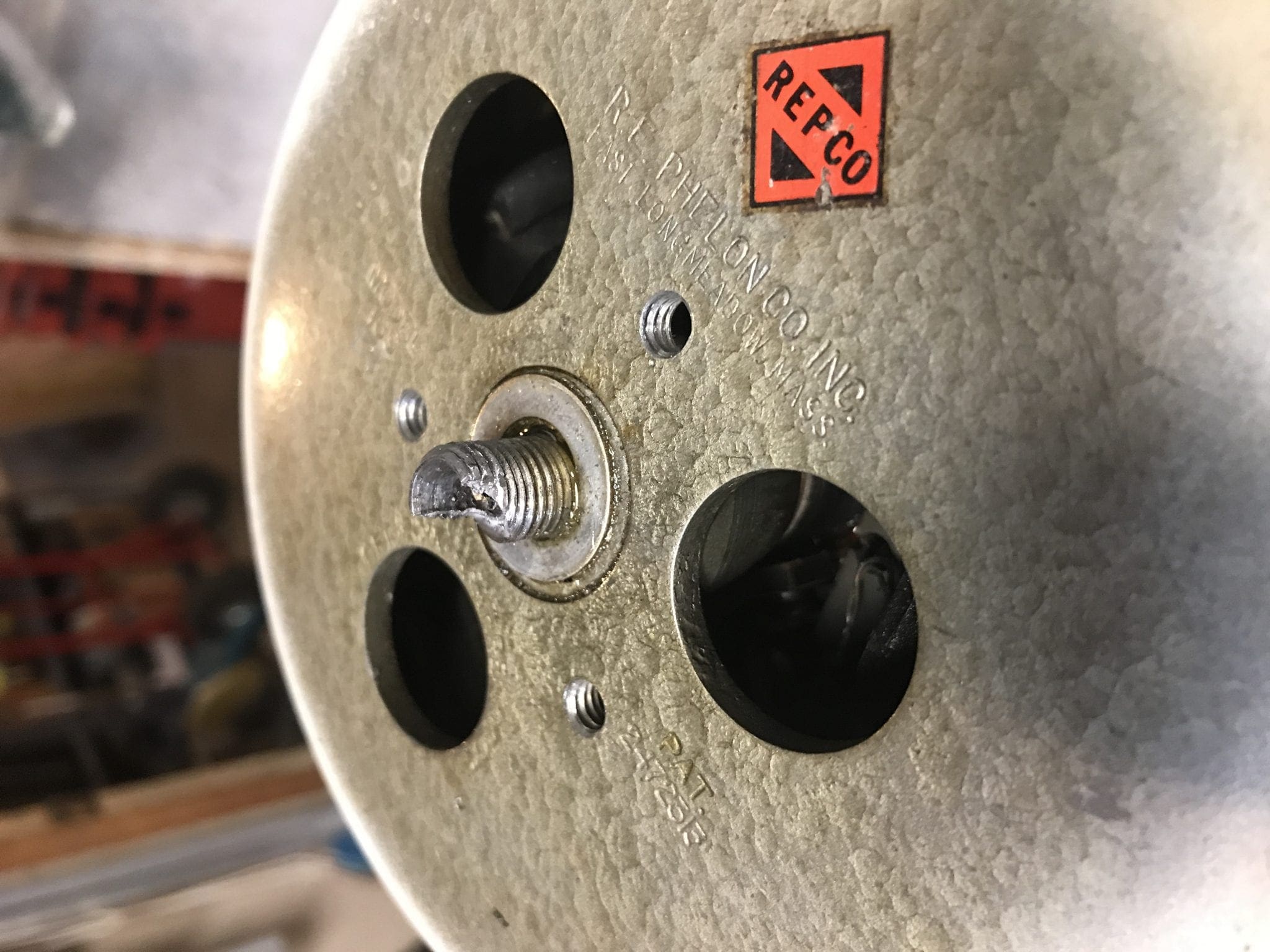

      Unfortunately, I wasn’t paying complete attention when trying to remove the flywheel. I did not realize the puller was penetrating the threaded end of the crankshaft until it was too late. What would you suggest doing in this case? A machine shop? A used crank? A parts motor?(although I kinda wanted to get the thing running) It’s a 1958 Scott-Atwater 7.5hp

        I need to look what powerheads I still have & it’s yours free, just shipping costs. I’m not doing that well with my health & need to check the shed which is 120 degrees in the shade. No one told you to put the nut back on loose to prevent splitting & the fact metalorgy wasn’t that good in the 50’s. We all learn from mistakes but I hope I can help,

          Hmmm. Any chance you could trim some of that mess off and have enough threads left to hold the flywheel on?

            Yes, I’ve managed to get the nut back on…sort of crooked, but on. I don’t feel real good about that flywheel spinning in that condition. It’s probably ok though.

                And you’re absolutely right! I never thought about putting the nut back on before using the puller. That make complete sense!

                    I would say if the nut is on “crooked” it’s not OK. You only need a few threads to be engaged, they need to be engaged properly.
