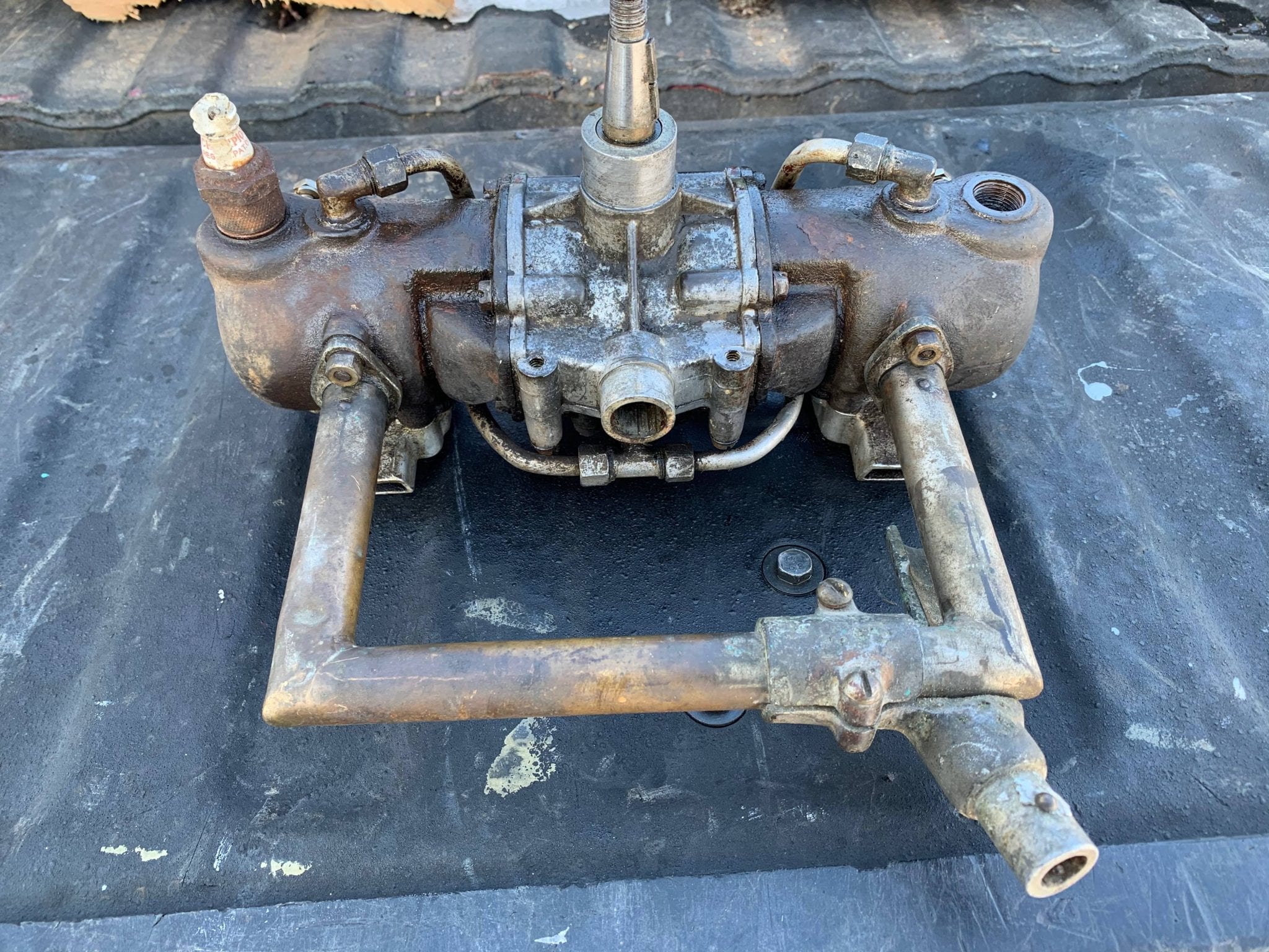

      Brace yourself Bartlett. Another one, from the portal, this time a very rare racing model A35, with the exhaust cutoffs.
      IMG_2315
      IMG_2316
      IMG_2317
      IMG_2318

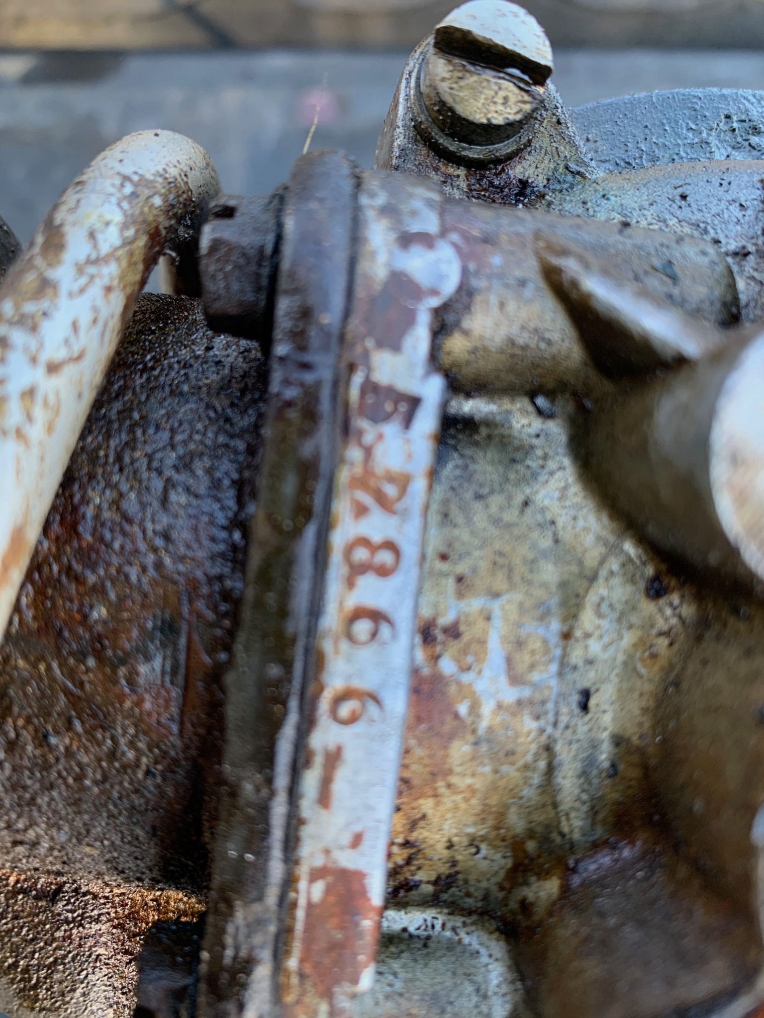

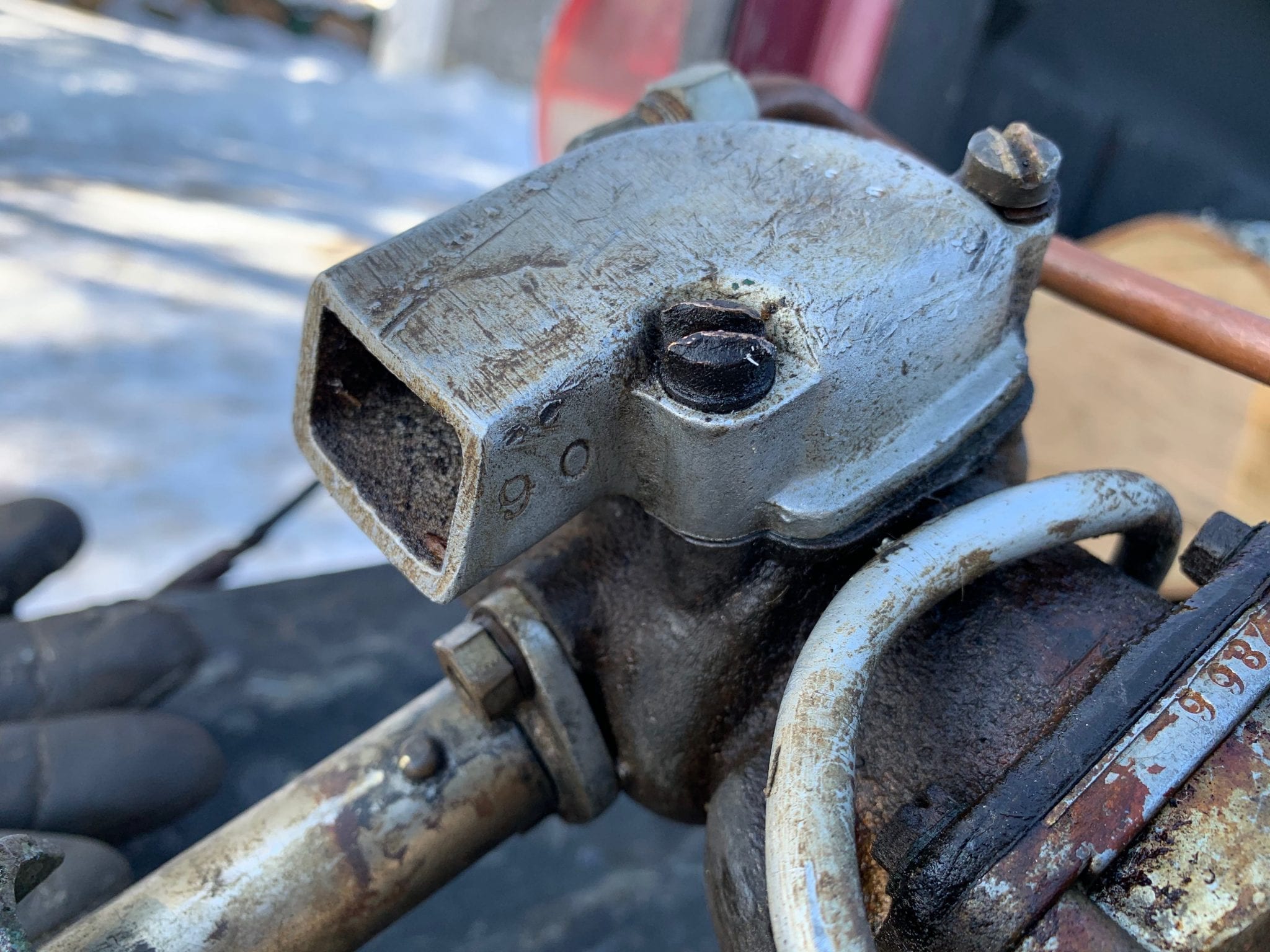

      Stanley-…all three have 9/16 nuts and 5/16 lines. Two have the 022/012 jugs. All have serial numbers that indicate 1927. Any idea how I can trace the 011/021 jugs? I’m thinking they are all A35, but the last piece unresolved for me are the differing jugs. I also welcome any info on what I suppose are cutoff exhaust pieces.

        If the waterlines are all A35 size,then the jugs are A35.The 021/011 number matches those on my late 1926 A25.My guess is they tapped some late A25 jugs to take larger lines and used them to make some early A35s.I think A25,A35 and A45 exhaust manifolds will interchange.

          Thanks, Stanley. You’ve been very helpful. : )

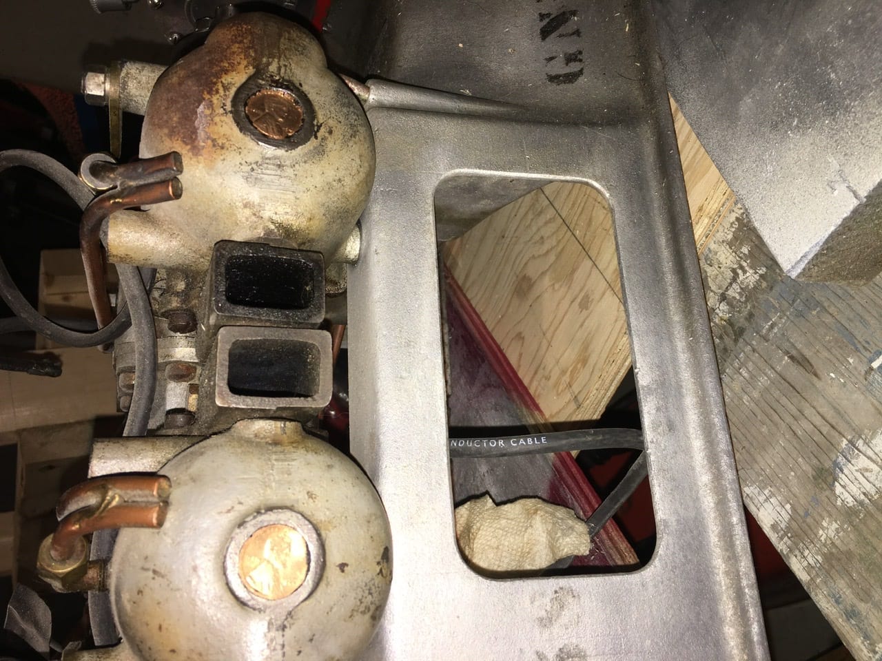

            Interesting stuff. The manifolds are similar to those of my Pacific Pumper.

              I wonder why the manifolds are forward facing on your extremely rare and heretofore unknown racing A35-R?
              #193005
              davidk
                Wow, good observation! Ram air?
                #193028
                David Bartlett
                  Someone had them off and put them back on the wrong cylinders.
                  David Bartlett
                  #193035
                  stanley
                    Hand warmers.
                    #193043
                    davidk
                      Hand warmers.
                      You must live up north : )
                      #193048
                      davidk
                        I’m assuming the manifolds are cutoffs. Is that right? Cleanly done. But why? Would that provide more power? Piss off the neighbors? Muffler blew out and no replacement available?
