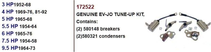

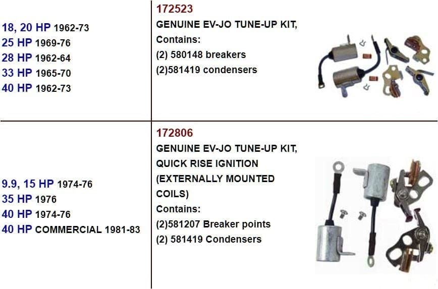

            172522-Tune-Up-Kit
            172523_172806-Tune-Up-Kits

              OMC-Tune-up-kits-application-172522-172523

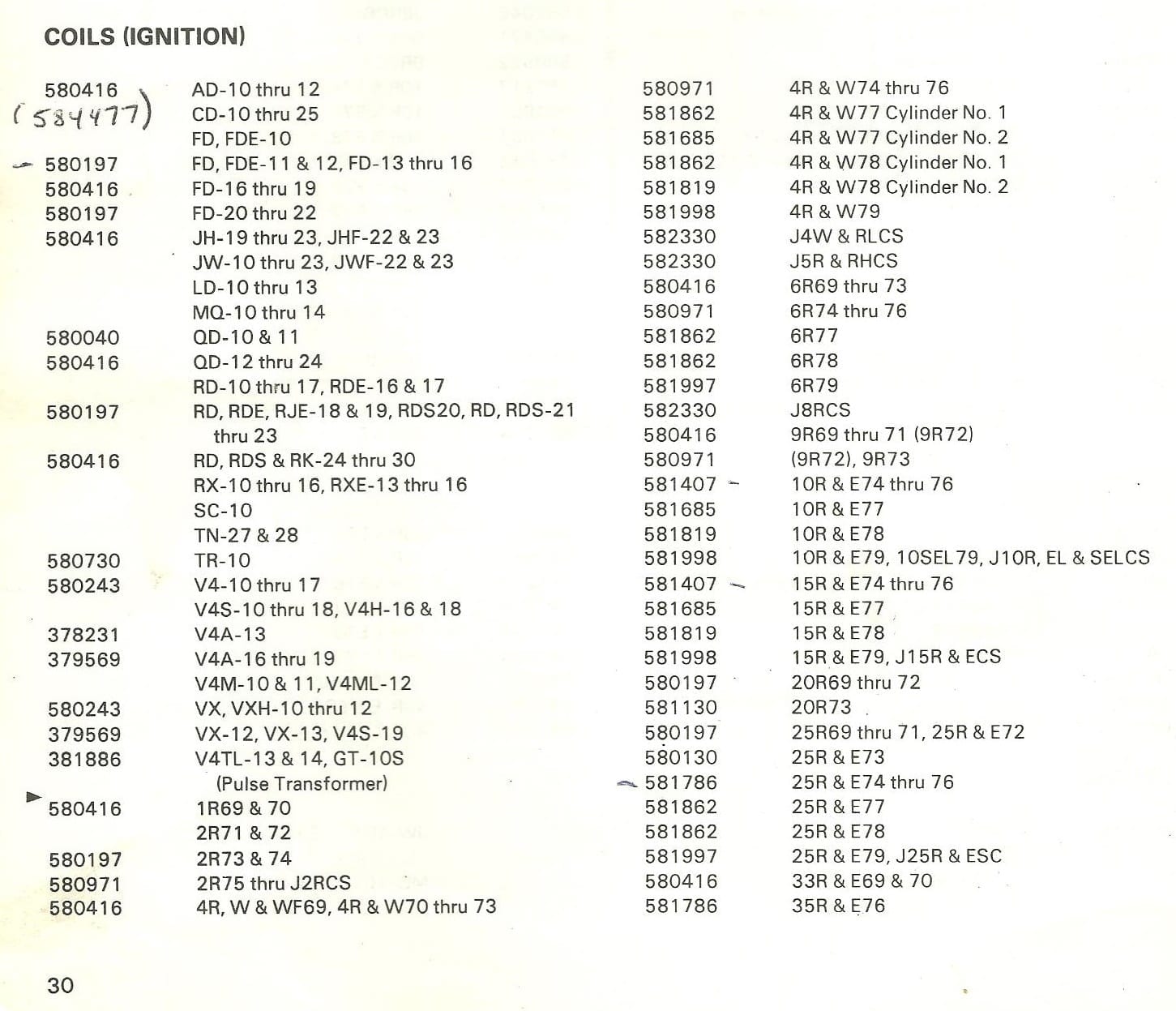

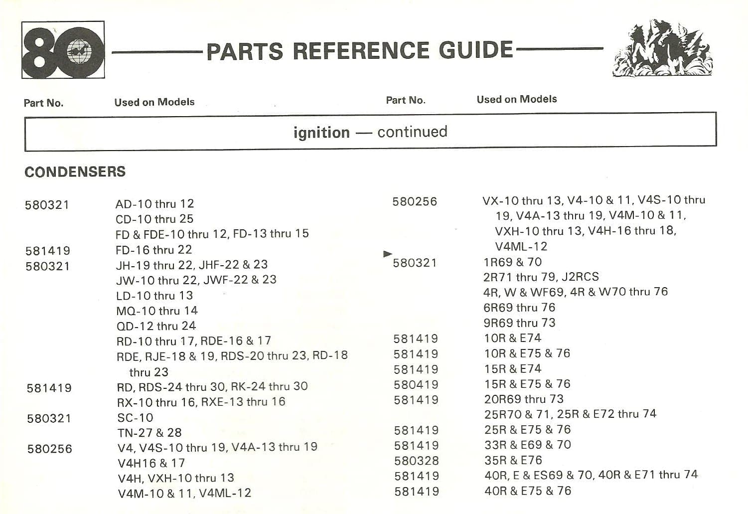

                        Here’s something from a 1980 Johnson parts book. Note how the RD 18 – 23 motors originally used the 580197 coils but called for the 580321 caps. It looks like the FD’s had the caps and coils juggled around a bit to. Confused yet?
                        Coils_Scan
                        Condensers-Scan
