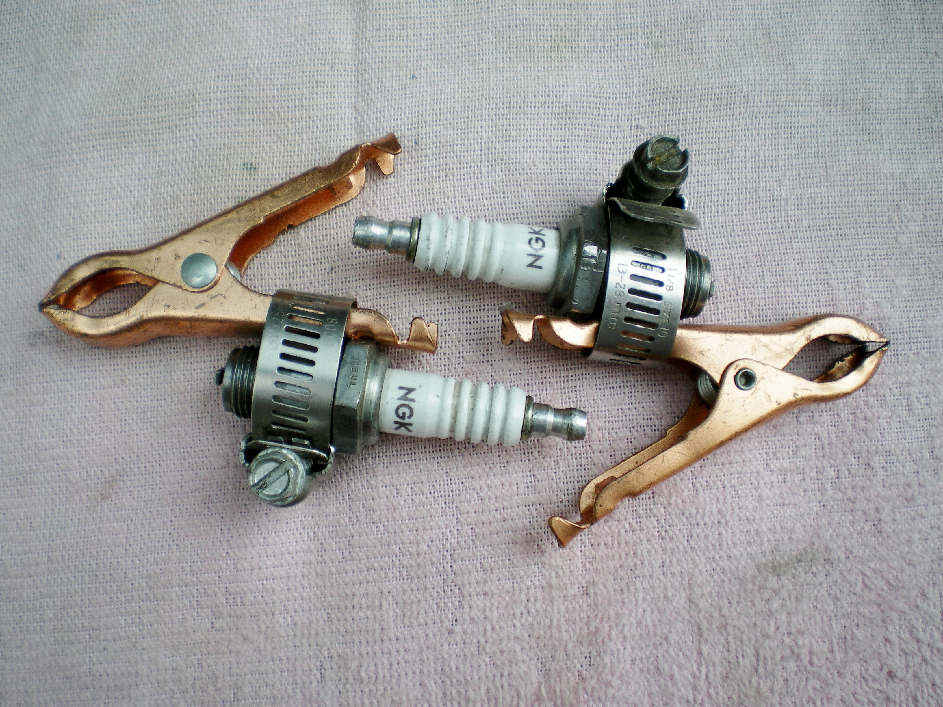

          In my opinion, those were really more of a spark plug tester, than an ignition tester. Sure, they tried to simulate combustion pressure but didn’t take into account atomized fuel, oil, etc. They were, IMHO, nothing more than an interesting novelty. All you really need to test ignition is an open-gap tester set to at least 1/4". Those are available everywhere.

                      My understanding is that a compressed fuel/air mixture has a significantly higher resistance than open fresh air at atmospheric pressure. I do not know what the numbers are, but the 1/4" gap is supposedly on the conservative side of a good spark for a typical magneto ignition to fire under compression. It is a rule of thumb that seems to work for me. I have had a few engines that would make a plug spark in open air and look OK but would not fire at all under compression. If it will jump a 1/4" gap in open air and the plug is good it has always been able to fire under compression for me so far. I

                      #80820
                        Cheap and simple items here for testing spark with a 1/4" gap.
