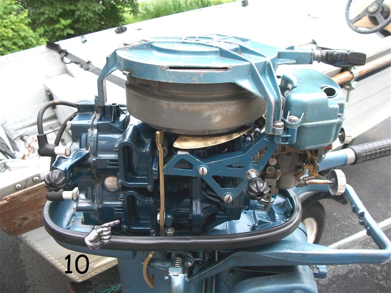

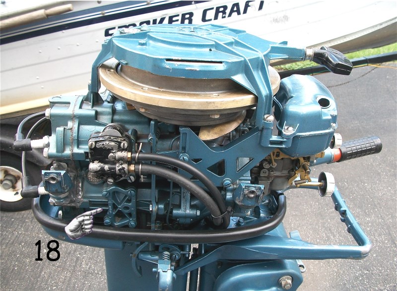

              Good catch, Phil B. It can’t be an 18 if it’s a QD and it can’t be a QD if it’s an 18. So if the seller can’t even get THAT right, alarm bells should be going off……It could be an 18 with a QD tag on the bracket, though, if the bracket had needed to be replaced…..I would look at it; and if you like it, ask for at least a test tank demo run.
              Not sure how you are at identifying power heads, as to whether it’s an 18 or a 10. There are lots of visual differences. Maybe someone will post some pictures. But the easiest one to describe with words is that 10s have a flywheel that looks at least two inches smaller in diameter than the recoil housing could encompass. 18s are going to have a flywheel that looks proportionate to the recoil.

                    Like all have said, a 10 or 18hp of that vintage with a good pressurized tank is surely worth every penny of $250. But, you will want to confirm it is actually in good mechanical condition….Just cuz it runs and starts does not mean it isn’t hiding something. Start with confirming whether or not it is a 10 or 18hp! Make sure it isn’t a "mix and match" engine! Next I would examine the inside of the fuel tank carefully to make sure the bottom of the tank is not fouled/rusted. Check gear lube and compression also….

                    David Stanton
