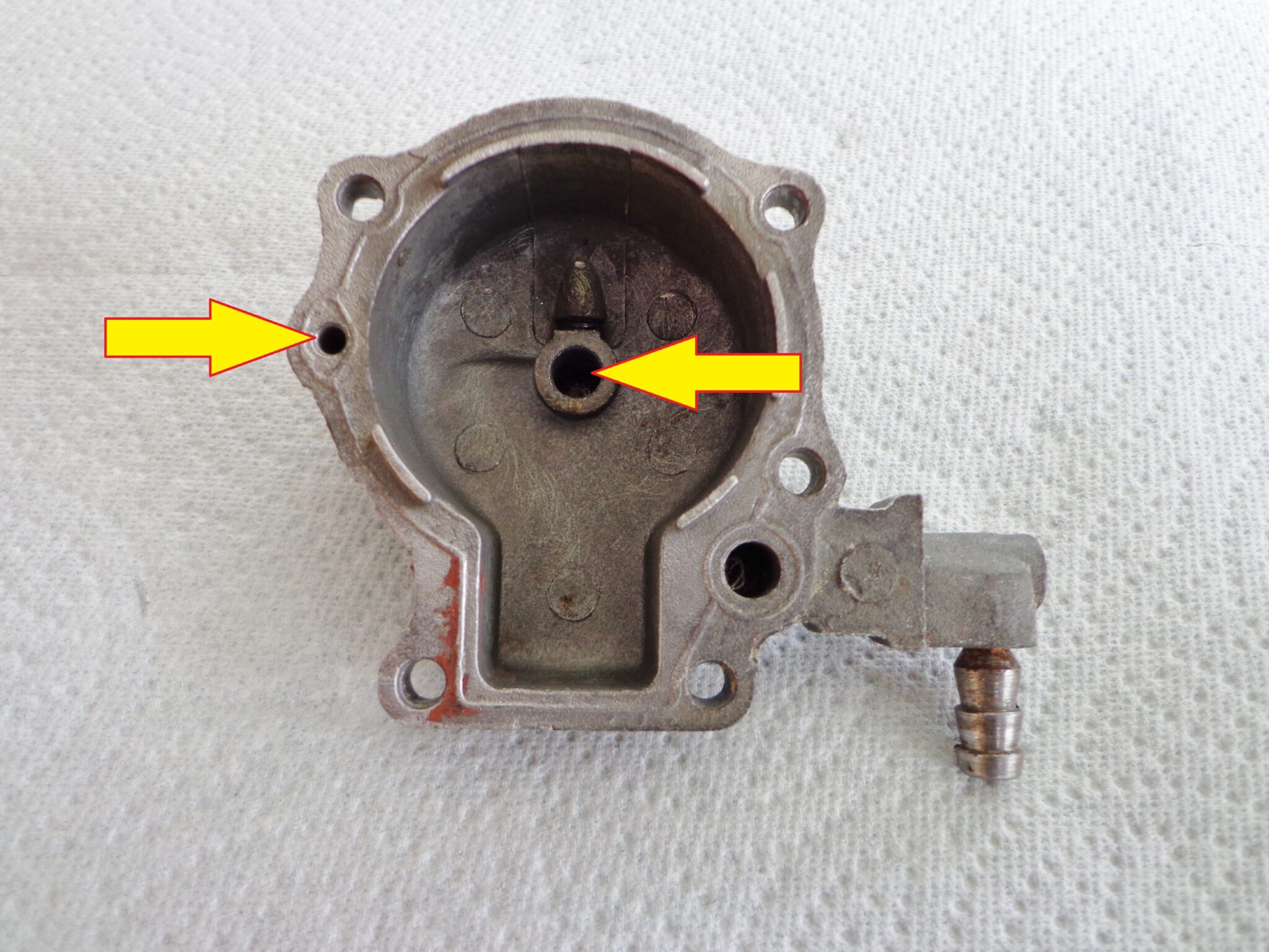

                  #246863
                    You could have some crud buildup at the bottom of the bowl blocking the passage shown on the left. This passage supplies fuel to the low and mid range circuits in the carb and it must be clear. The corresponding passageways in the carb body must be clear and clean to.
                    Carb-Bowl
