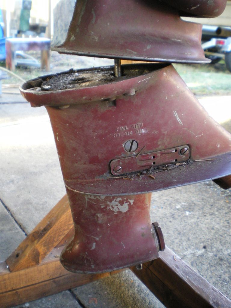

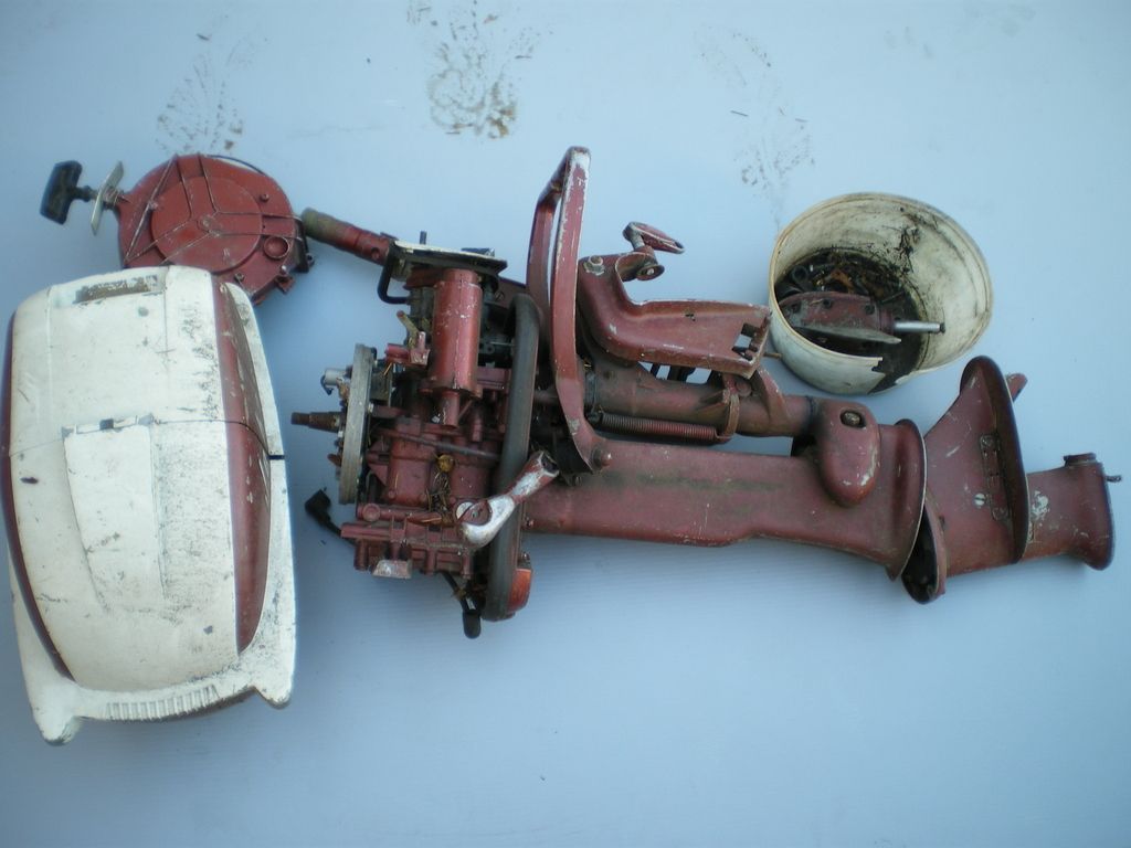

          #38245
          grover
            Yes, you do have to remove the powerhead. Here’s a link to a video I made a few years ago:
            https://www.youtube.com/watch?v=SVOedhzPP7M
            #38246
              If you try to change the impeller without removing the powerhead, chances are you’ll end up with a bent driveshaft, a bucket full of parts or another donor motor. 🙁
              #38310
              theodore
                Oh man, that guy had a rough day.
