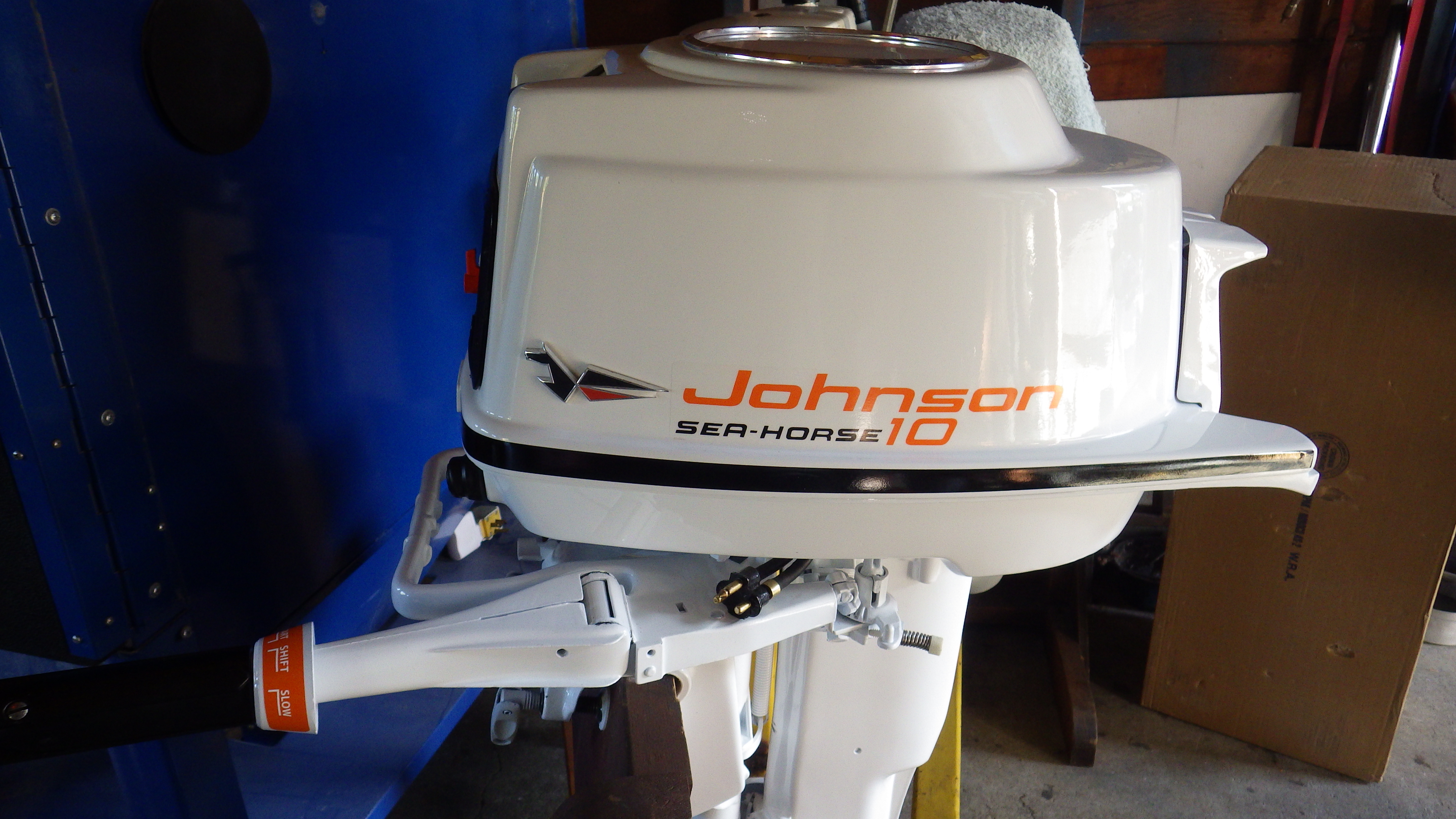

There’s something I like about ’59 Johnsons with the fiberglass hood. Here’s a ten horse I have squirreled away somewhere! 😀

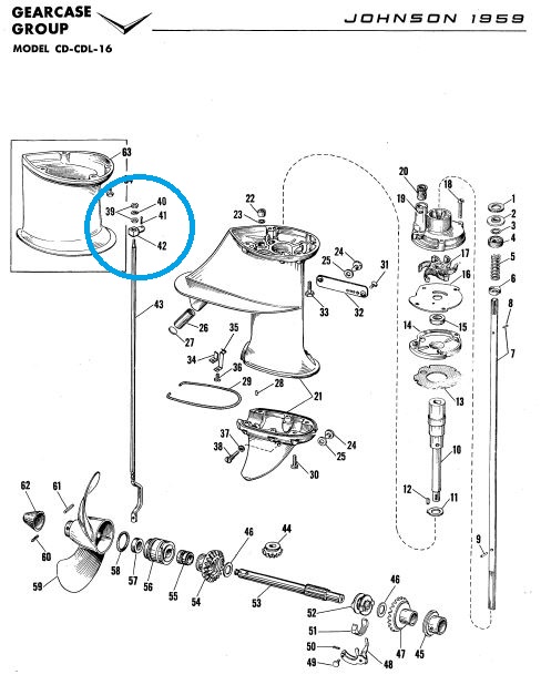

June 10, 2016 at 2:21 pm #38059quote SteveH:Do you really need to pull the power head to drop the lower unit?I hate to be the bearer of bad news but, yes, you do have to pull the powerhead. It’s only seven screws and some other small stuff.
The two nuts (# 39) on the long shift rod have to be removed to undo the linkage and they are located right below the powerhead.
