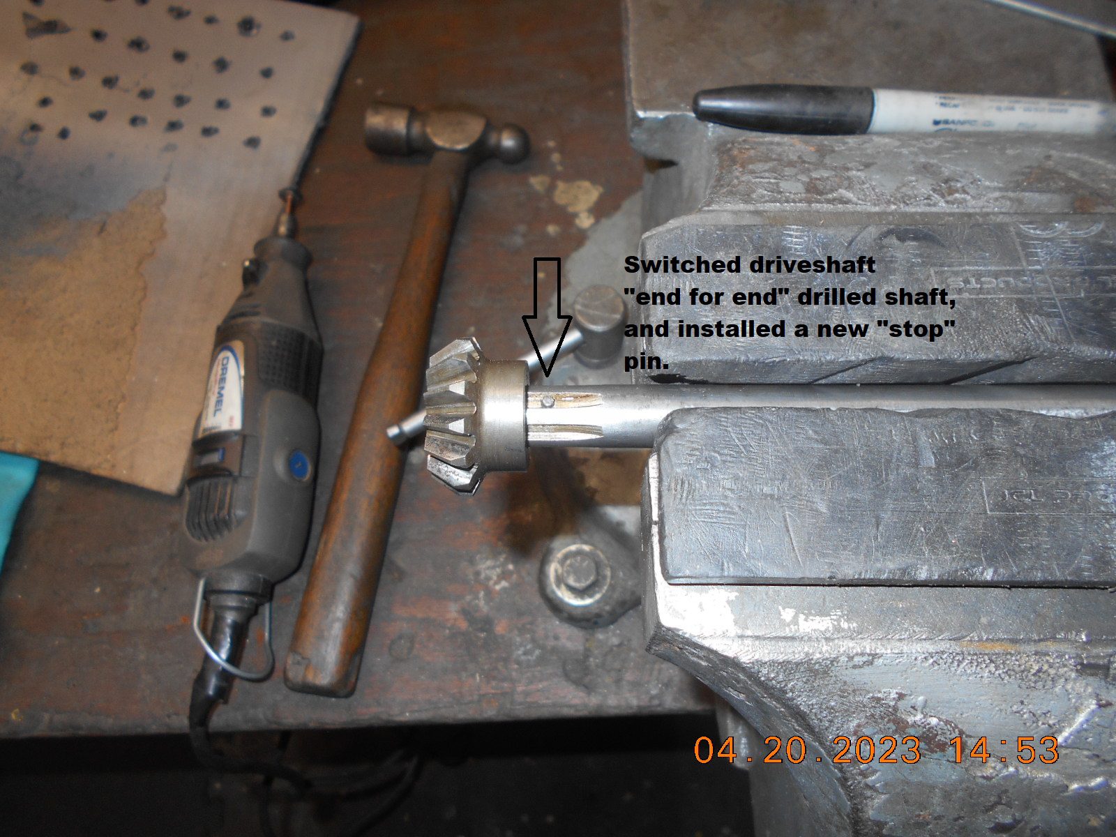

    I’ve seen 2 types. The ends of the spring
    (or the cartridge) engage into a hole in the
    pump cam and a hole in the prop shaft gear.

    Tubs to the rescue again… I just found a parts list for the LT and was going to ask the OP to look for a hole in the face of the prop shaft gear. There is a spring shock absorber unit that connects the gear to the pump eccentric. In the parts list drawing it looks like a simple coil spring. Tubs first photo seems to be a enclosed unit, last photo the plain spring. Apparently, the OP has a part missing or broken.
